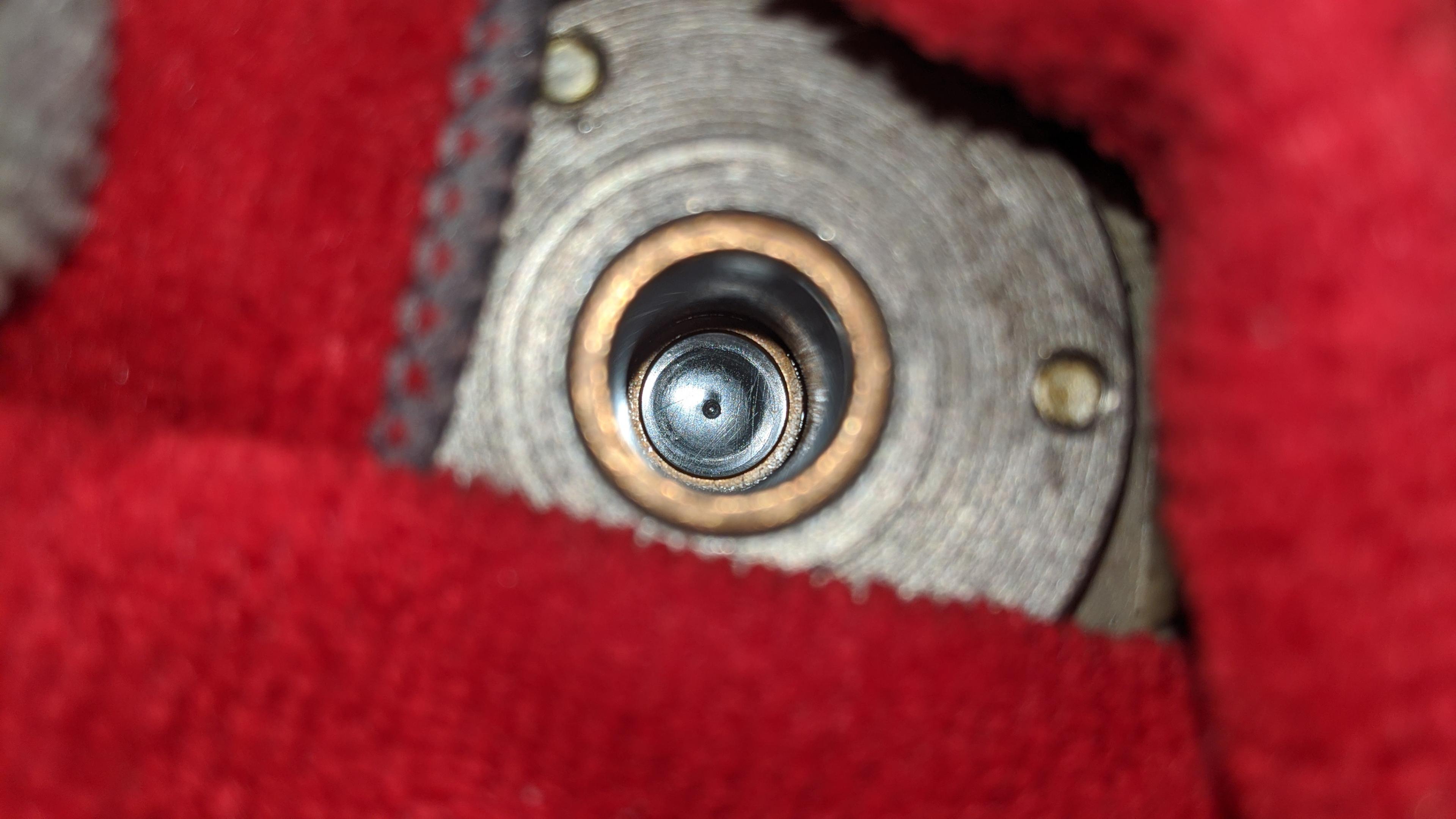

As a point of interest I took my main bearing apart to renew the year old thrust plate which from inspection from the top of the well looked horrible.
Upon disassembly the dimple was far smaller than it looked but I was going to flip it over and reuse all the parts. I have the thick brass cap with the raised center. Instead, I cleaned off the gasket with electrical cleaner, added a drop of Super Glue gel and slapped a sapphire thrust plate onto the center of the gasket. I then reassembled the bearing, added 25 drops of 3'n 1 oil and spun it up to 33.33 RBM. It took 3 minutes and 30 seconds to come to a complete halt! I finished reassemling the motor unit back in the plinth and am listening to it as I type this.
Just a proof-of-concept type of thing. I didn't even try and center the disc carefully, just made sure it was reasonably centered in the well. I don't know if the disc/gasket interface will hold up or whether the stock ball will tolerate the sapphire thrust plate.
Will update.

Sapphire is very hard and the ball might wear in a month or so. No real problem as the ball can be tapped round. If a fixed point I wouldn't recommend this. Graphite is an idea. Vacuum cleaner brushes are a cheap source. With graphite a ball shaped cup forms. Long rotation of a bearing is sometimes a false indication. The very low cost Garrard SP25 bearing would seem supurb on a long rotation test. It was a noisy bearing really. If 3 in 1 is replaced with ATF it should be slightly superiour. SAE 30 or 20 non additive oils will cause drag. That should sound better as oil drag dominates stylus drag. More bass perhaps. The belt causes some torque loss. Drag slightly tensions the belt. Tape decks used a small differential pulley speed to overcome similar effect. Drag is not friction. The TD 124 magnetic brake also helps.
Thanks Nigel. I have to say in the few dozen hours of running the speed stability has improved. The speed locks on within 15 seconds or so and doesn't change during the day as it did with the stock set-up. The coast down time is impressive with an increase by a third the time it used to come to a stop. The only question will be longevity. How will the surfaces hold up? Do you know the ball diameter in the main bearing? Maybe I'll order a few SiNi bearings from Boca Bearing.
As I said if it doesn't work out the ball can be be reused. Thorens were very intelligent in the design of the bearing. With minimal attention and some oil you can't kill it. For all that it's an high spec type. Their choice of ball bearing might be special. Linn used a carborundum thrust by 3M polished to a mirror finish. As hard as sapphire at a guess.
