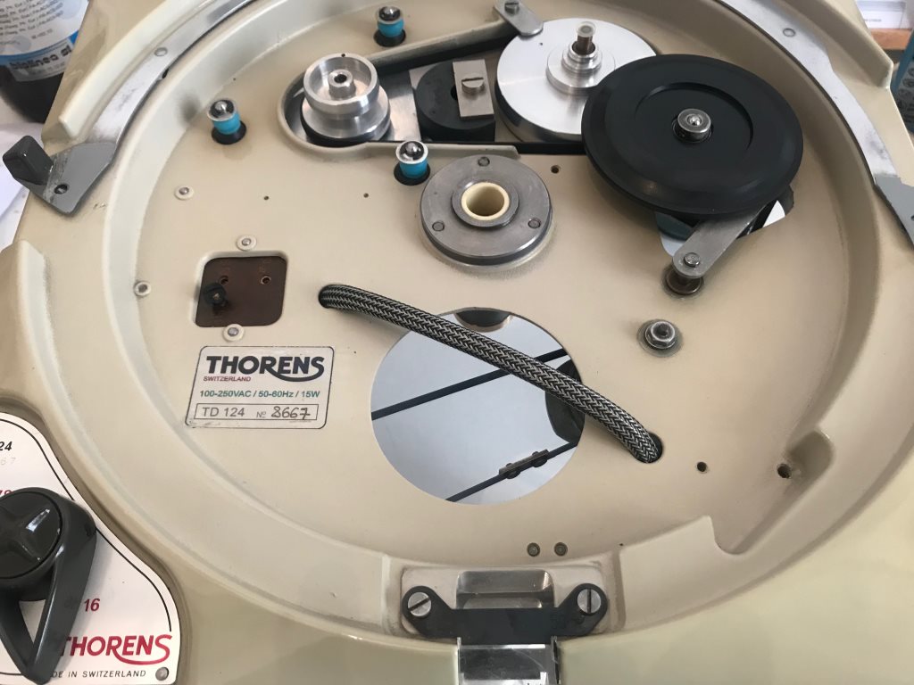

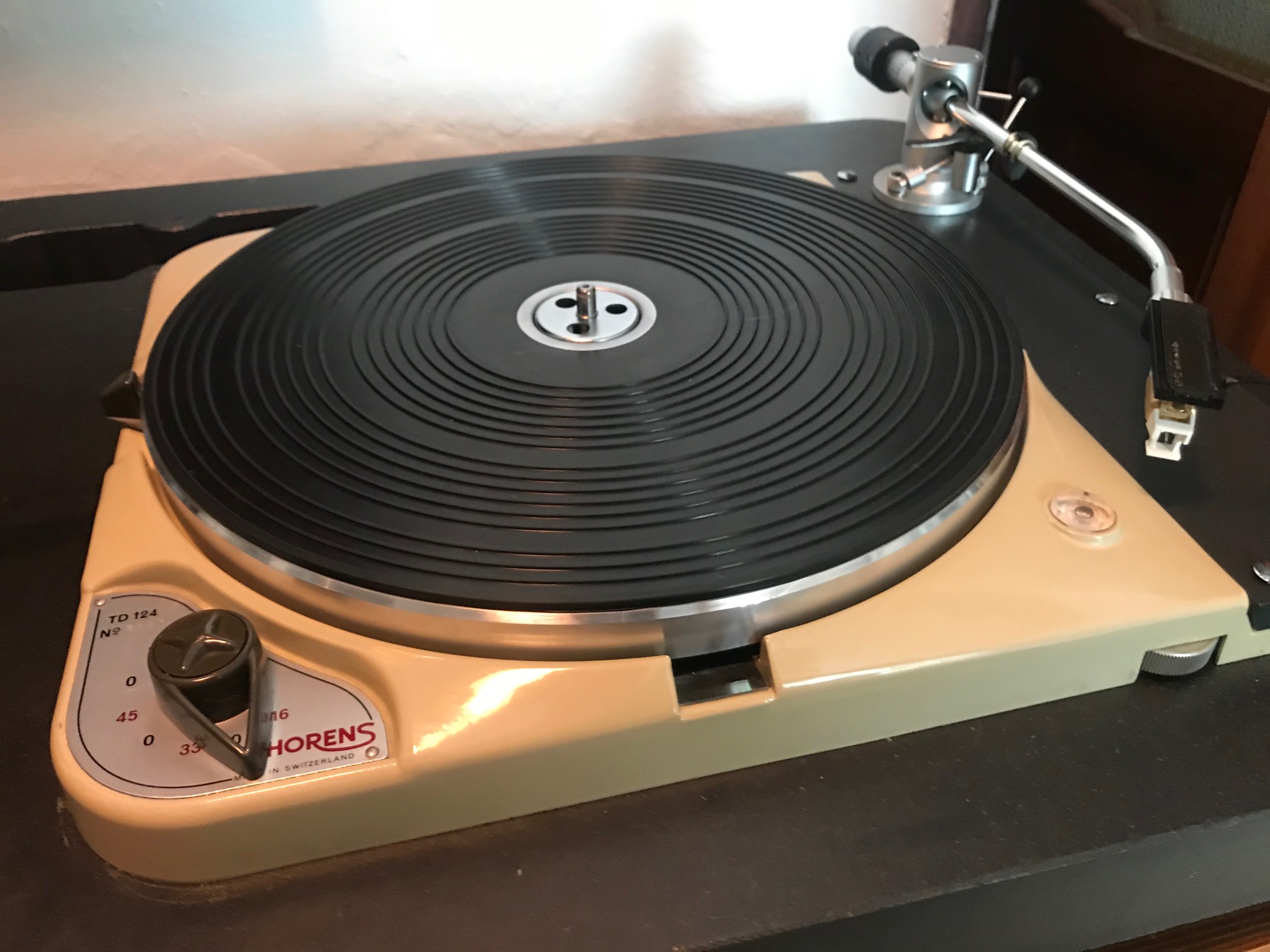

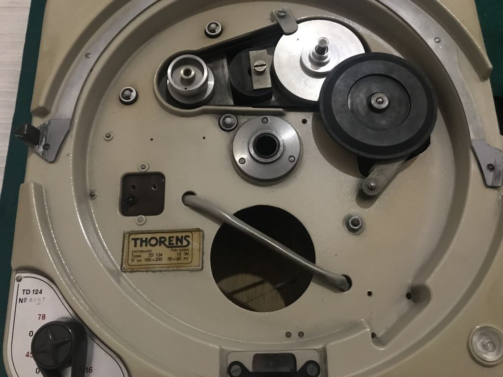

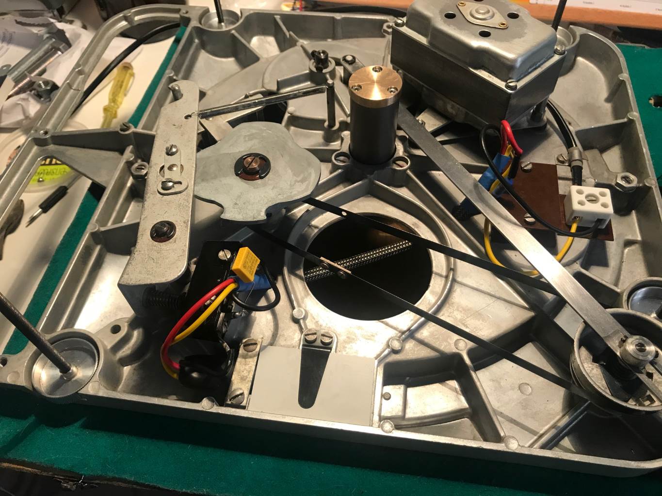

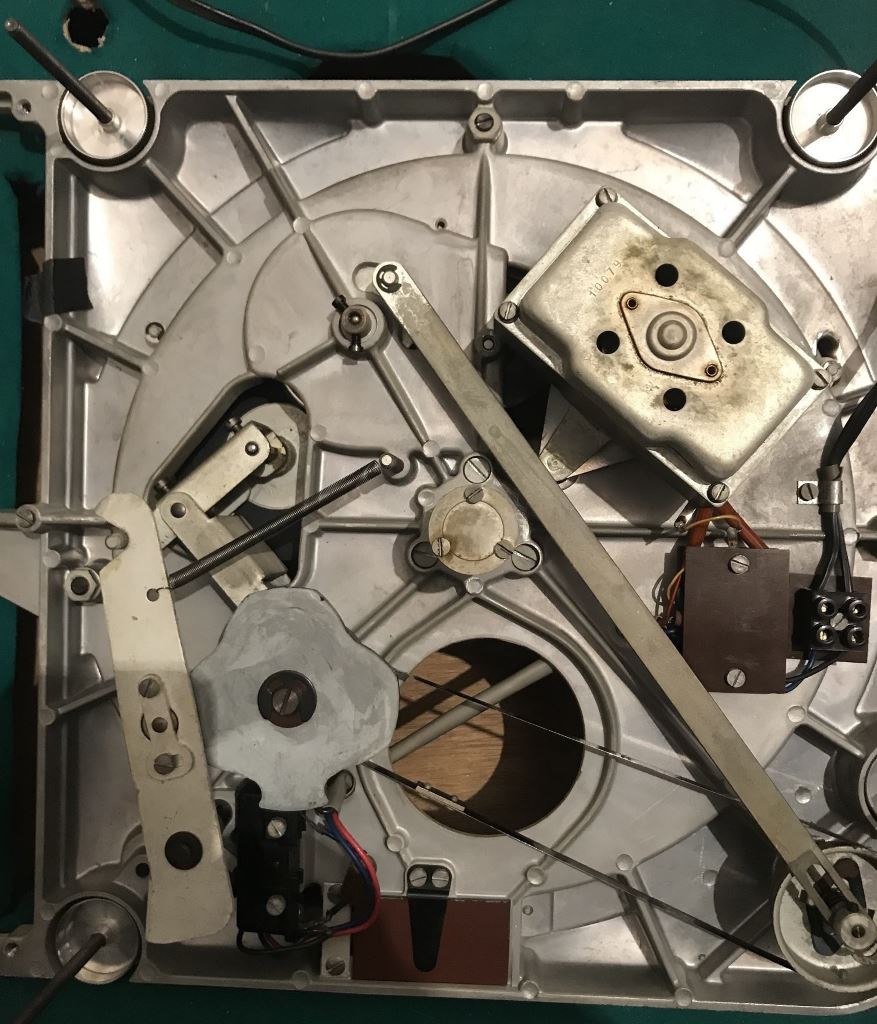

Before and after...

I replaced mine with a 275VAC 0.01uF X2. This:
You won't have problems finding them.
Thank you kindly Koji888
i cant open image though
and why would i need 2 of them ? in parallel?
click on the link with the mouse right button and select "see image".
Only 1 per turntable. I wrote "them" cause you said you need 2.
Been working a bit more on the tt past weeks. Wanted to solve problems between the stepped pulley and idler wheel (was not running at 16rpm, for instance). So disassembled and oiled the bracket. The worst thing was removing the cam follower set screws (had to drill one out). Out of the question the biggest problems I had while doing the whole maintenance have been the screws. Old stuck screws that don't come out not even with the best screwdriver. A nightmare with the knob and the cam follower ones. BTW, if someone has trouble (like I had, only found them in china) looking for replacements for the critical 3,5mm diameter set screws in the main on/off/speed knob, the set screws on the CAM are the same size (and at least in my tt they don't seem to be that important...)
In the end, after cleaning and lubing the idler wheel bracket and adjusting the height, it works perfect at every speed. Adjusted the eddy brake too and replaced motor and main axis ball bearings with Si3N4 ones. Also I'm checking conical springs vs the gel pads I had for the motor suspension.
And last but not least important I got an external vintage transformer. Testing the table at 190V and 200V, it runs much cooler and now adjusting the brake the speed is perfect and not too fast as before. Still hot after 1 hour but now I can keep my hand on the motor (I couldn't before).
I have to say I'm very happy about how deadly silent the 124 is running right now. Still haven't done any listening cause my amp is under heavy maintenance at the moment, but can't wait.

Well, the lid arrived so this is finished by now. I'll leave the 2nd tonearm for the future (thinking about modifying the ESL gyro1000 to 12 inches).
Lots of hours spent on this thing, I think I've worked on absolutely every part in the guts of the thorens. That would have been impossible without the info shared in threads like this one, so thanks to everyone who contributed to it.
And it's been worth. Once my amp came back to life fully upgraded, I've done direct comparisons between the thorens with a Fr-24 mkii tonearm and a Empire 4000/d3 cartridge and my Sota star sapphire equipped with Sumiko FT-3 premier and Denon DL-S1, same phono preamp. The Sota sounds great but the Thorens is absolutely better in every aspect. Even with the ESL tonearm and a generic Shure cart the Thorens sounds better. I'm really impressed. Would love to try the Denon DL-S1 on the thorens, but with the iron platter it seems a bit risky...

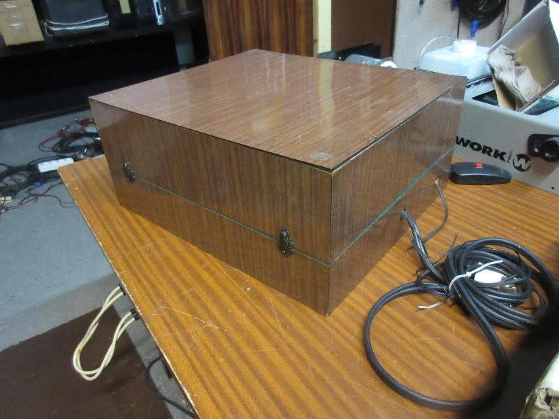

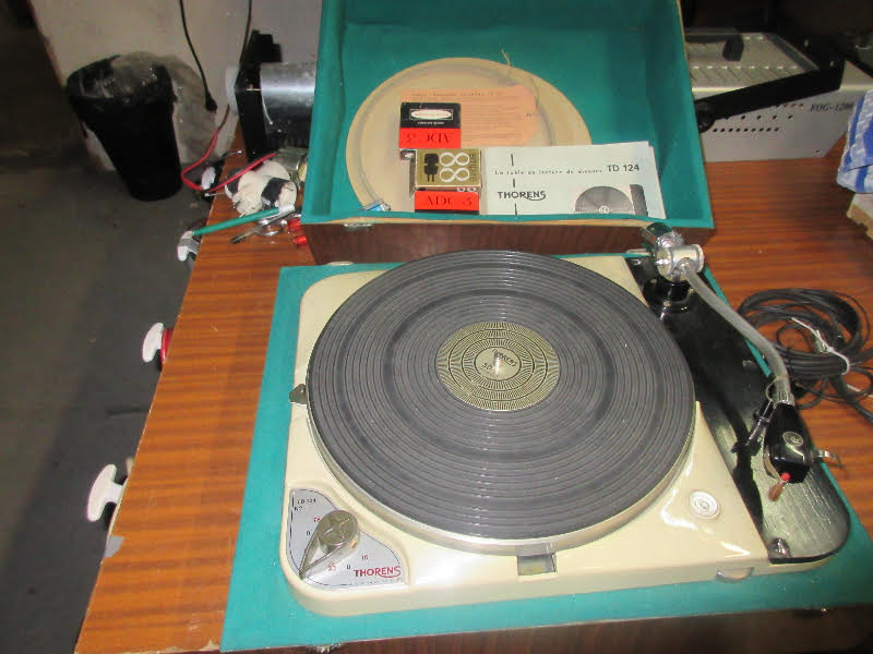

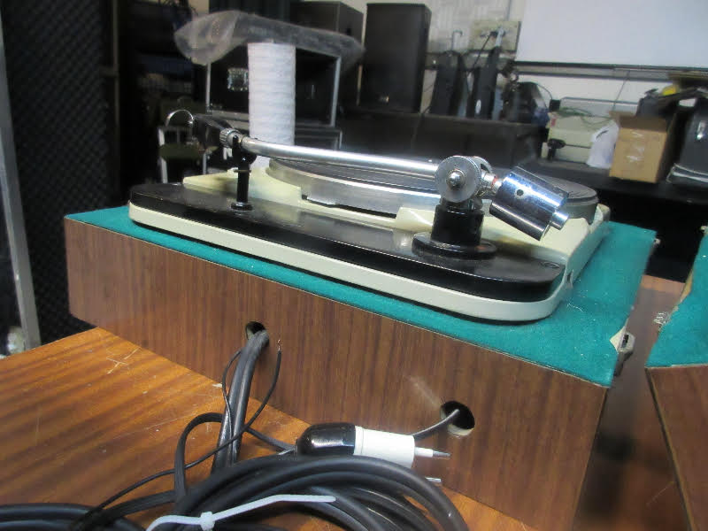

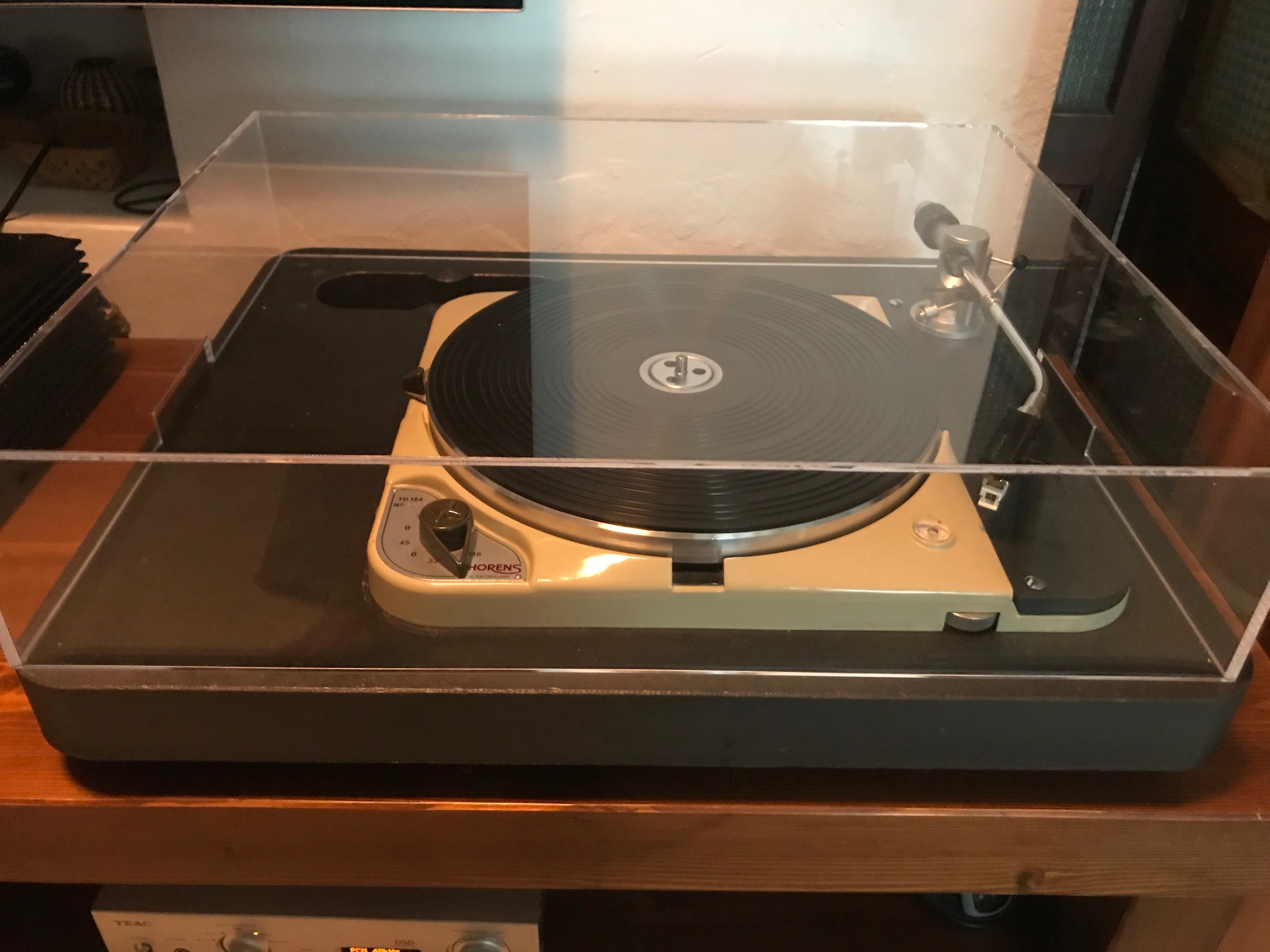

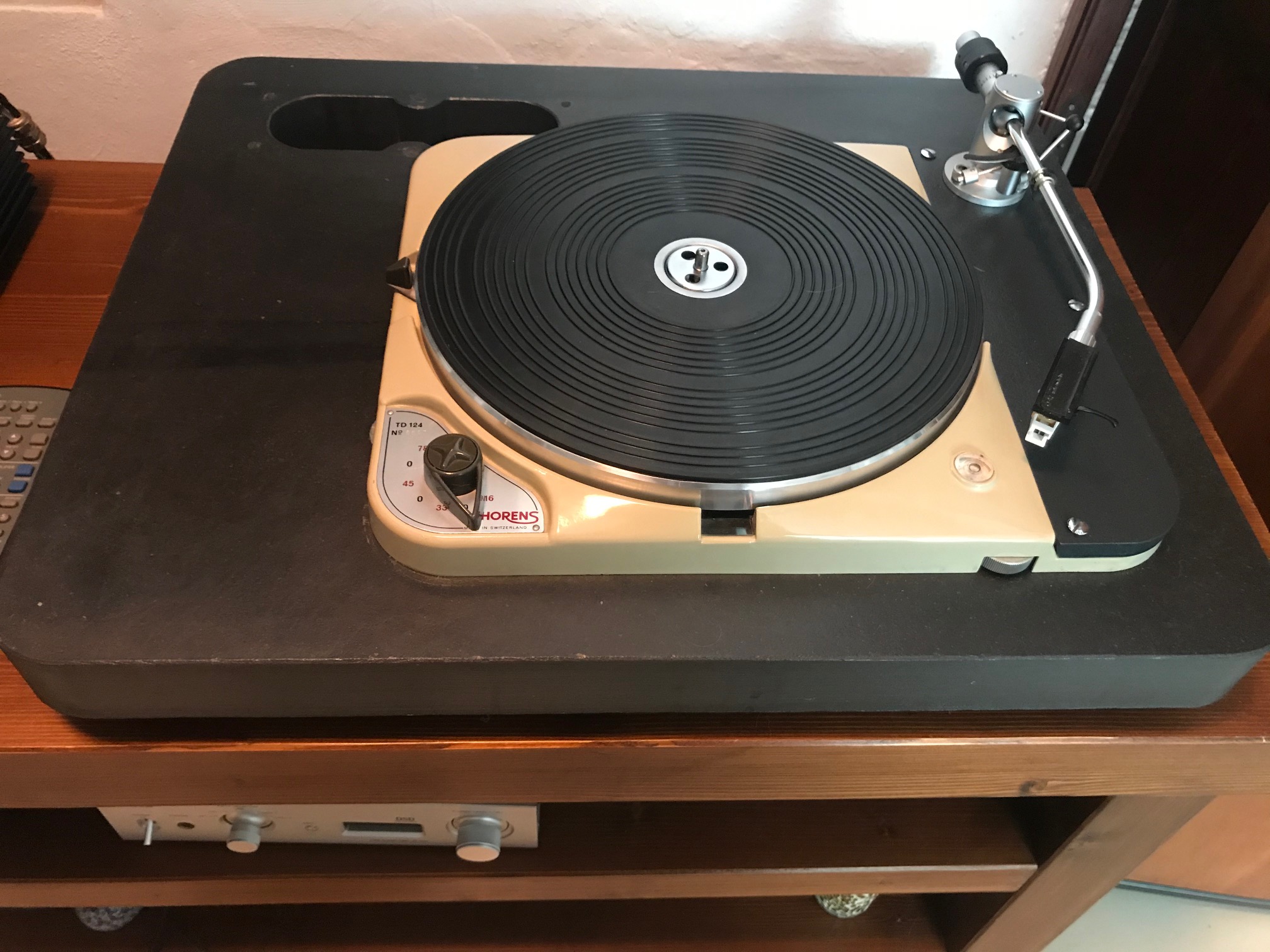

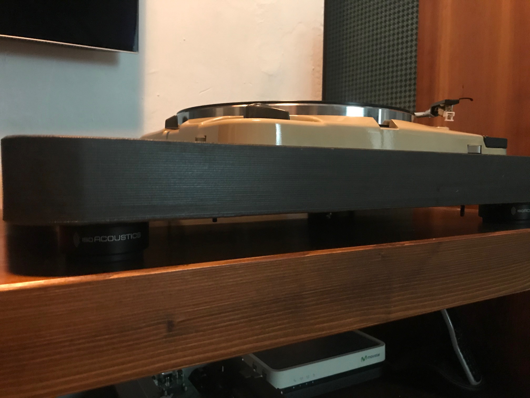

Finally some pictures. The first 3 just before collecting the Thorens. I only paid 300€ for that box, but spent much more on upgrading it. The hollow area at the rear is for a second tonearm i'll install one day. The last one is from the cute transformer I'm using with the Thorens. I'm running it at 205 volts.

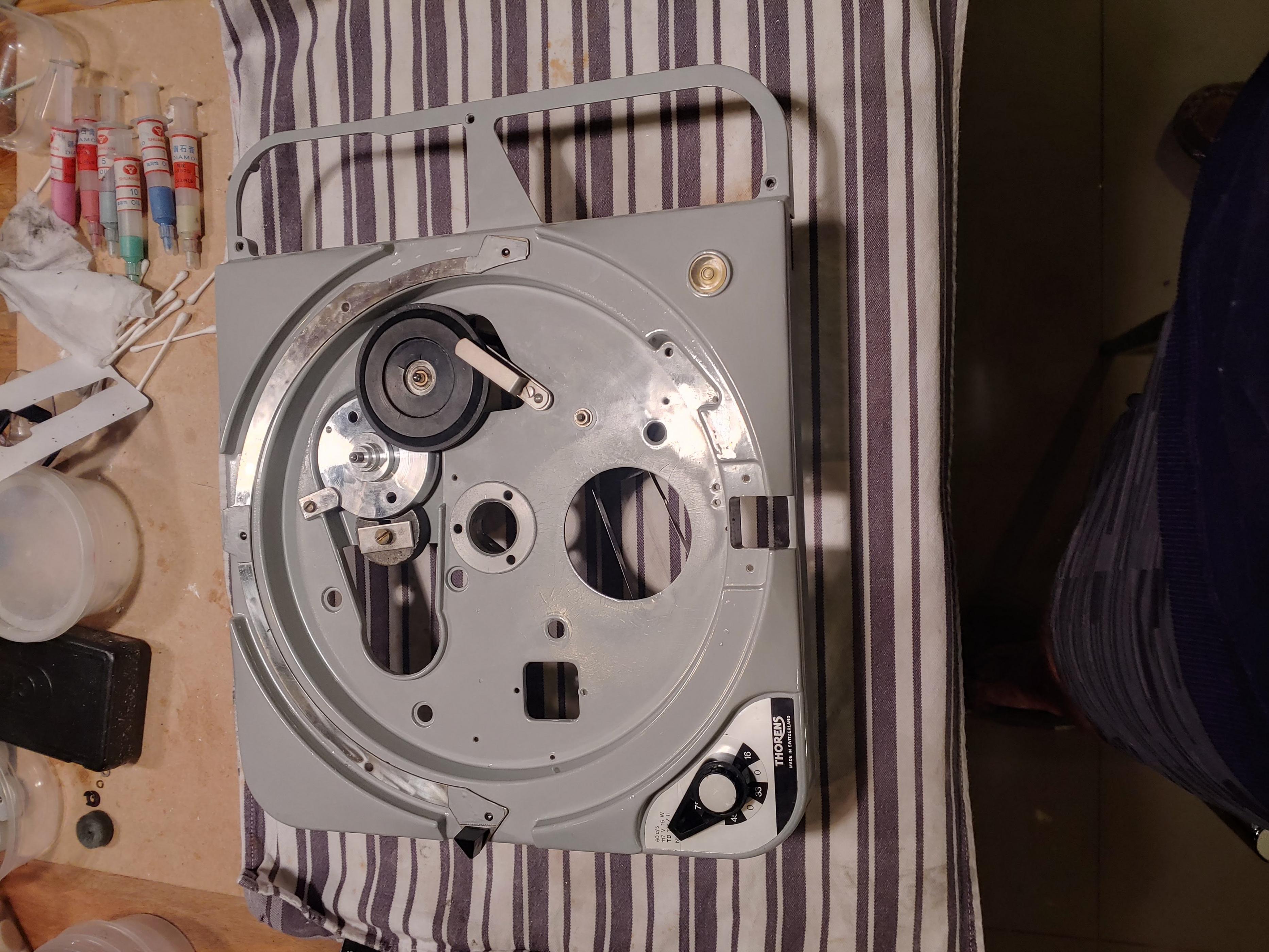

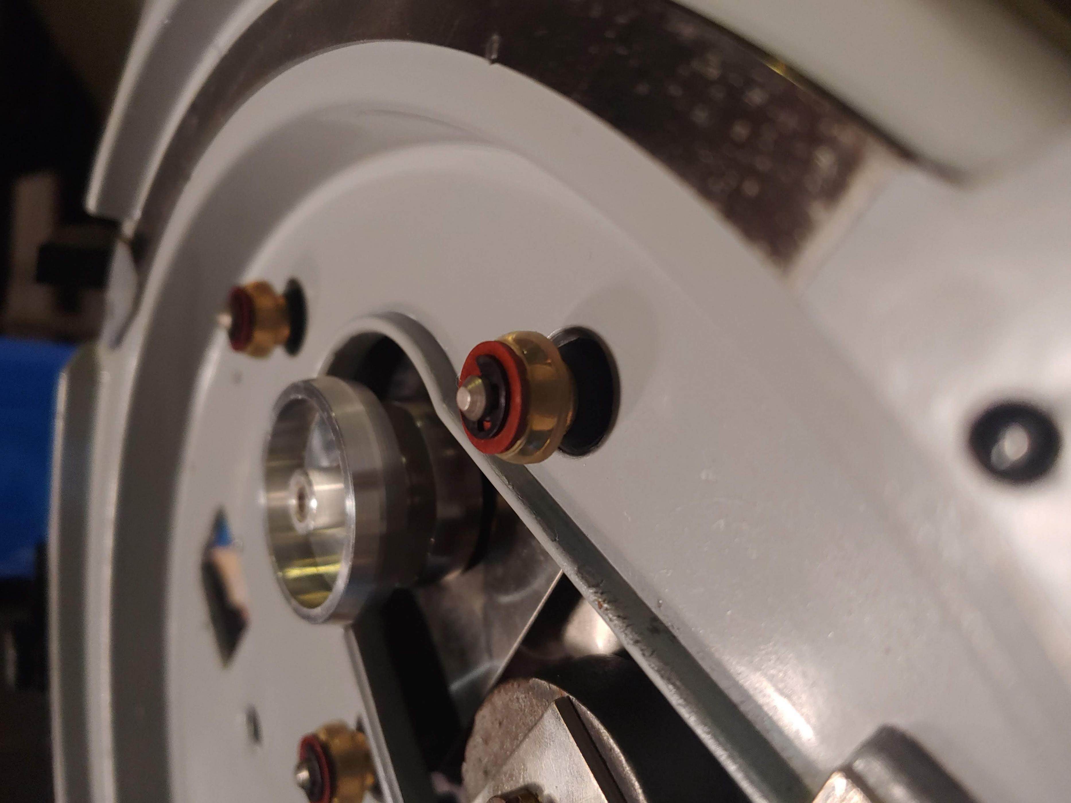

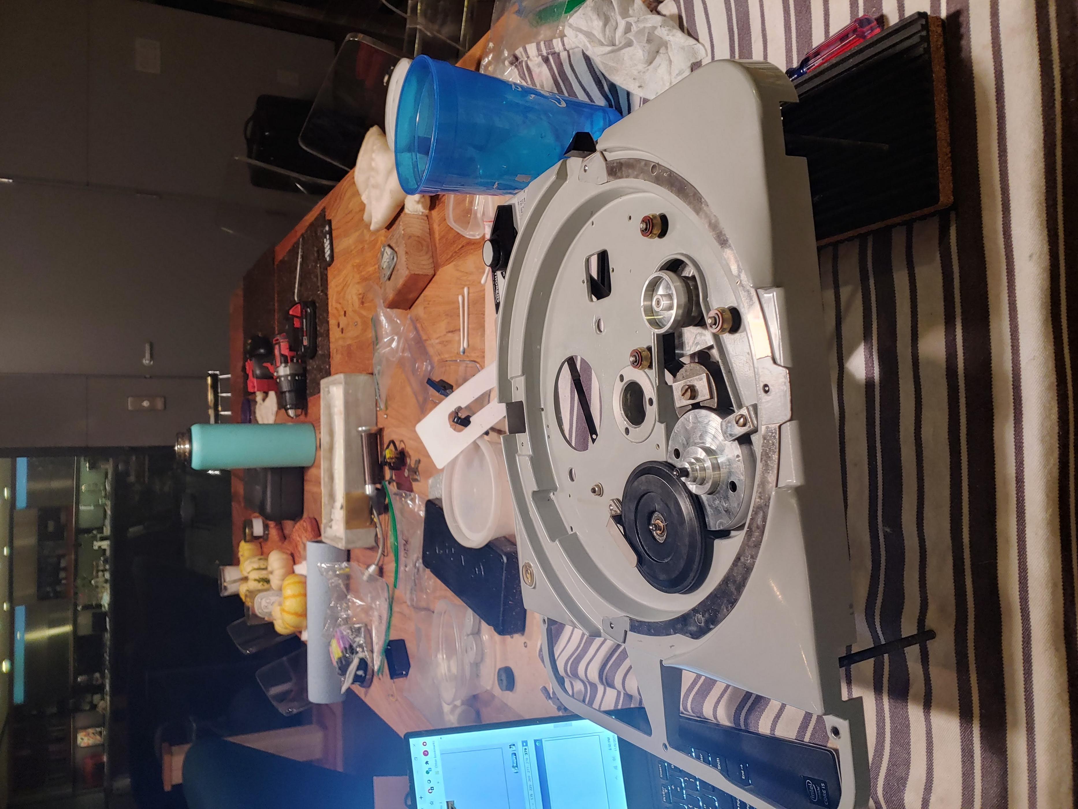

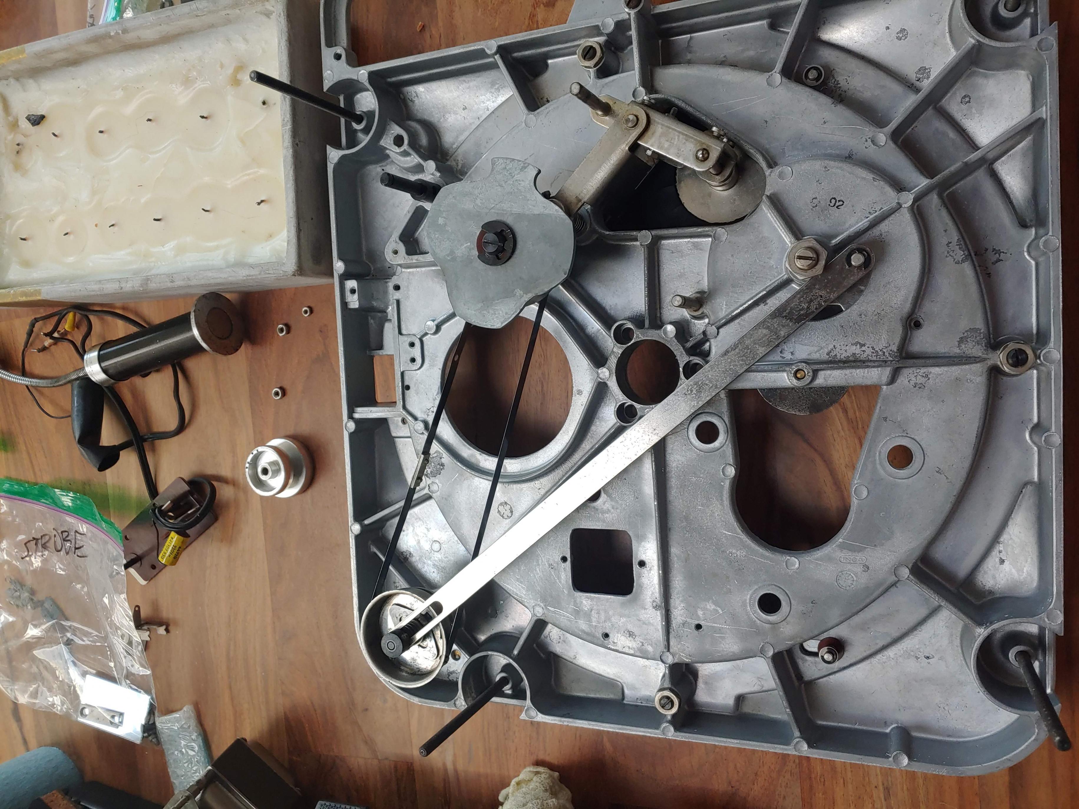

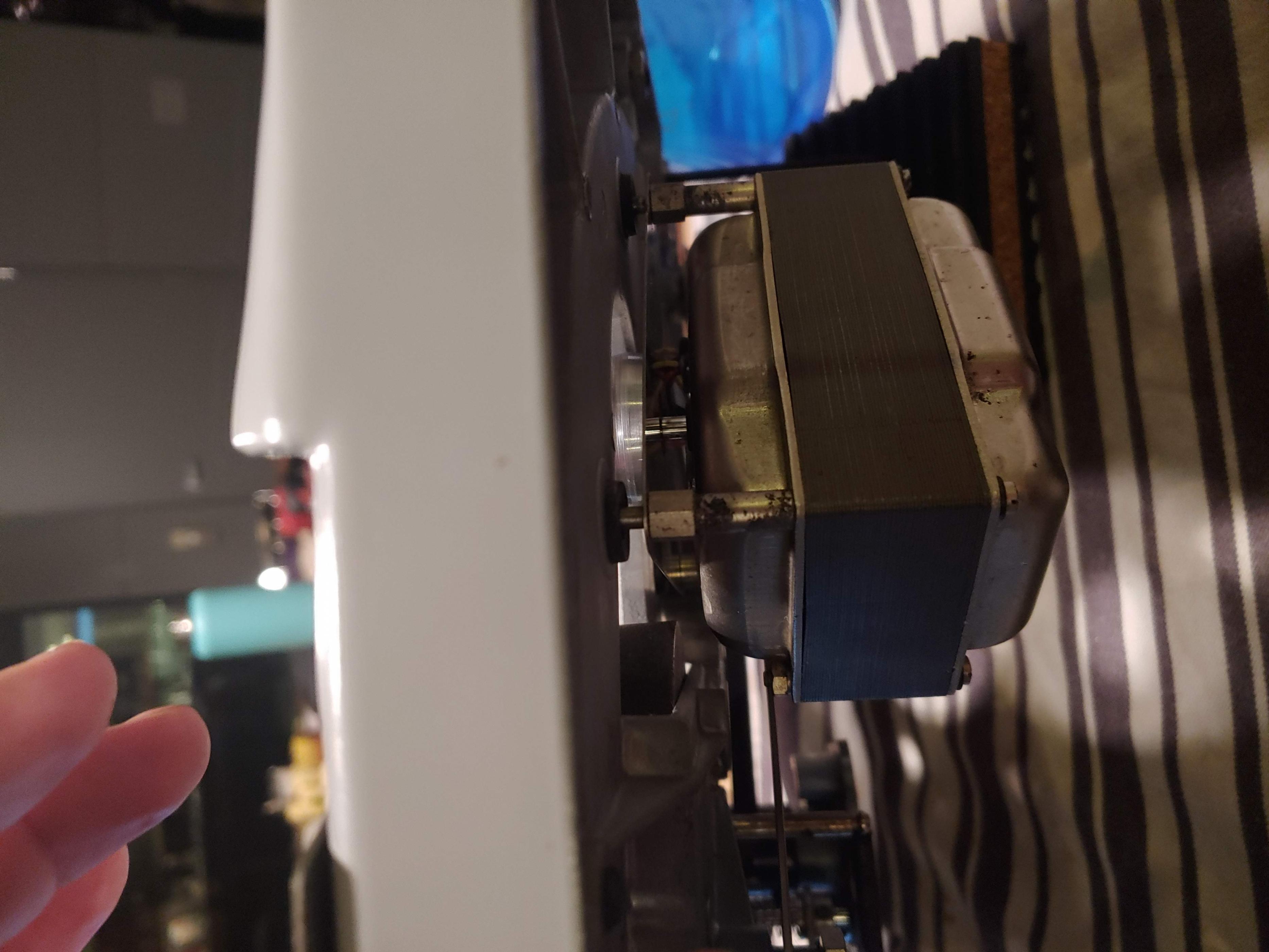

I have been slowly working to restore this TD-124 and I was happily interrupted by my Aleph J build which I completed between tearing the TD-124 down and polishing / cleaning and rebuilding the table. I was hoping for a little advice regarding the motor mounting.
I have attached some pictures below of both my progress and of the motor mounting in question. When I took the table apart I don't remember the metal triangle being so loose and there being as much play in general with the motor assembly. Also, there were three additional brown washers in my parts bag with the rest of the motor mount stuff and I wasn't sure what they may be used for. Any advice here would be great!

The three washers you mentioned probably should go between the bushings and the E-clips (aka C-clips) that retain the motor to the chassis. (I see you have some)
I recommend the Hanze Hi-Fi spring suspension kit for your MKII - I have them on both tables and they are good for about a 10dB reduction in coupling between the motor and chassis. Jaap of Hanze Hi-Fi is Vulcan here.

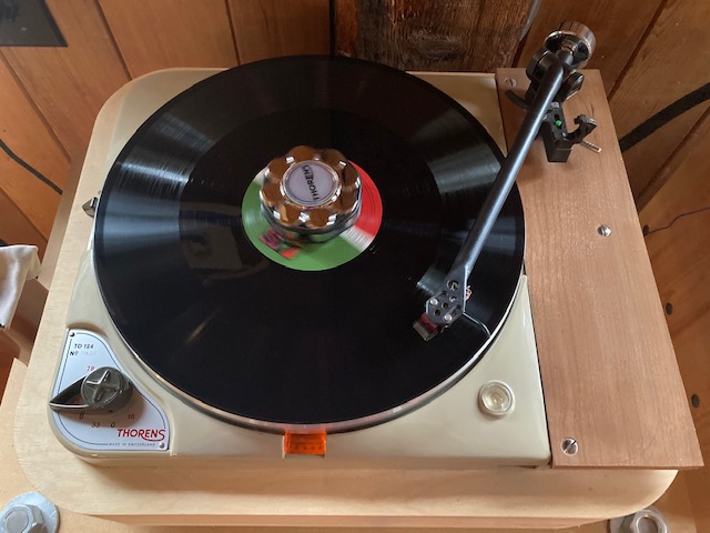

It has been too long but here is an update on my TD124. As you can see. I am still not finished although it has been in use for about a year.
I ended up sending my main bearing to Woodsong for a rebuild. It was not a cost that I had considered when buying the TT. But it needed to be done and Chris did an amazing job. I highly recommend if you need any work done.
All the other work has been done by myself with all knowledge gained from both this thread and The Analog Dept. Thank you.
Now here is my million-dollar question. I rebuilt my motor with new parts from Audio-silente. I think I did an ok job. But it takes 90 minutes to come up to speed and stay put?! Could it be the low temp of the room? Does anybody have any idea what could cause it other than my motor needs to be done again?

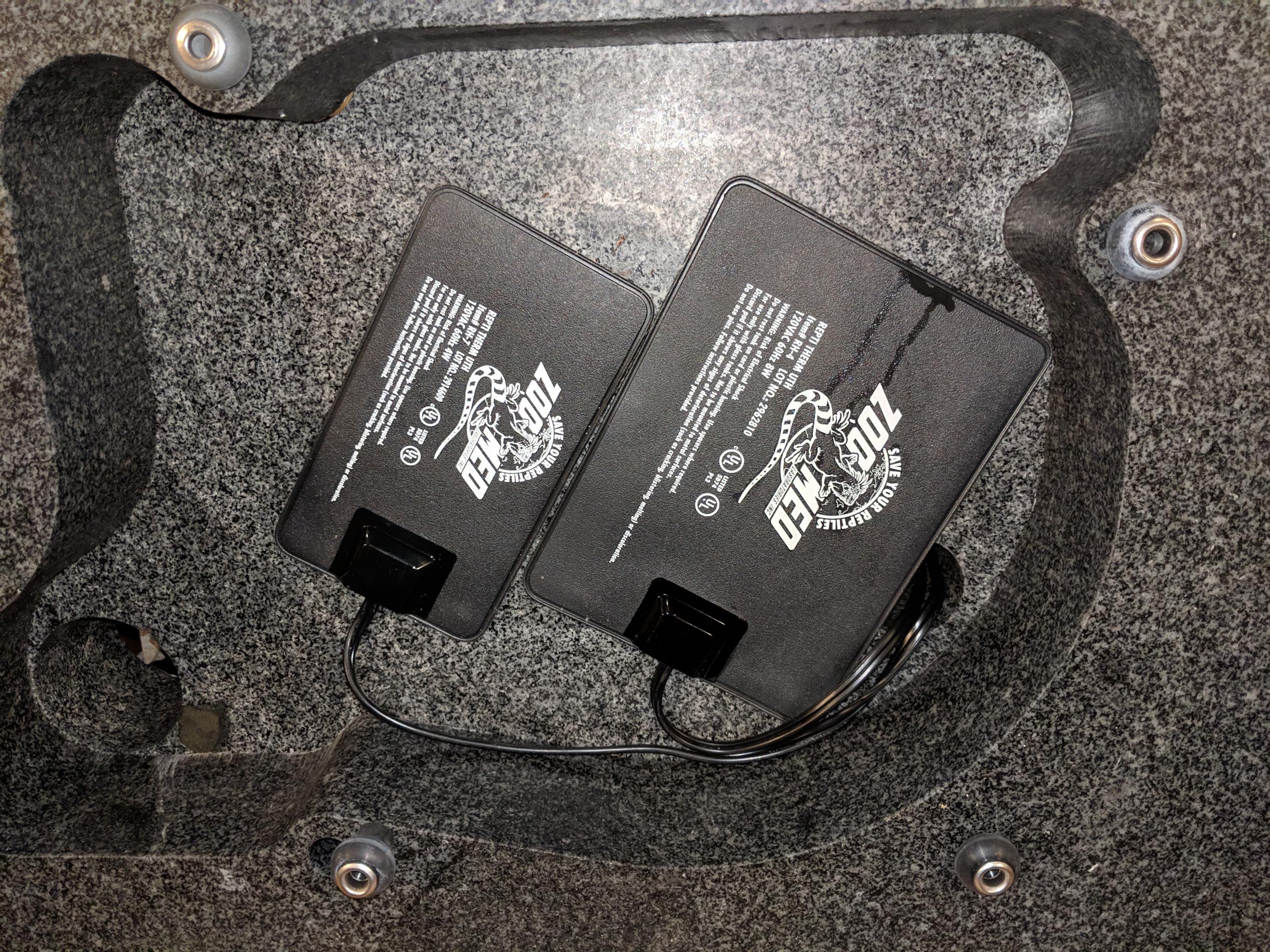

My Td-124 sits in a granite plinth and is located in a chilly basement. I reduced the warm up time by installing a couple of reptile cage heaters in the stone chassis right under the bearing and motor areas. These stay plugged in all the time. Now after a few minutes the speed is spot on.
