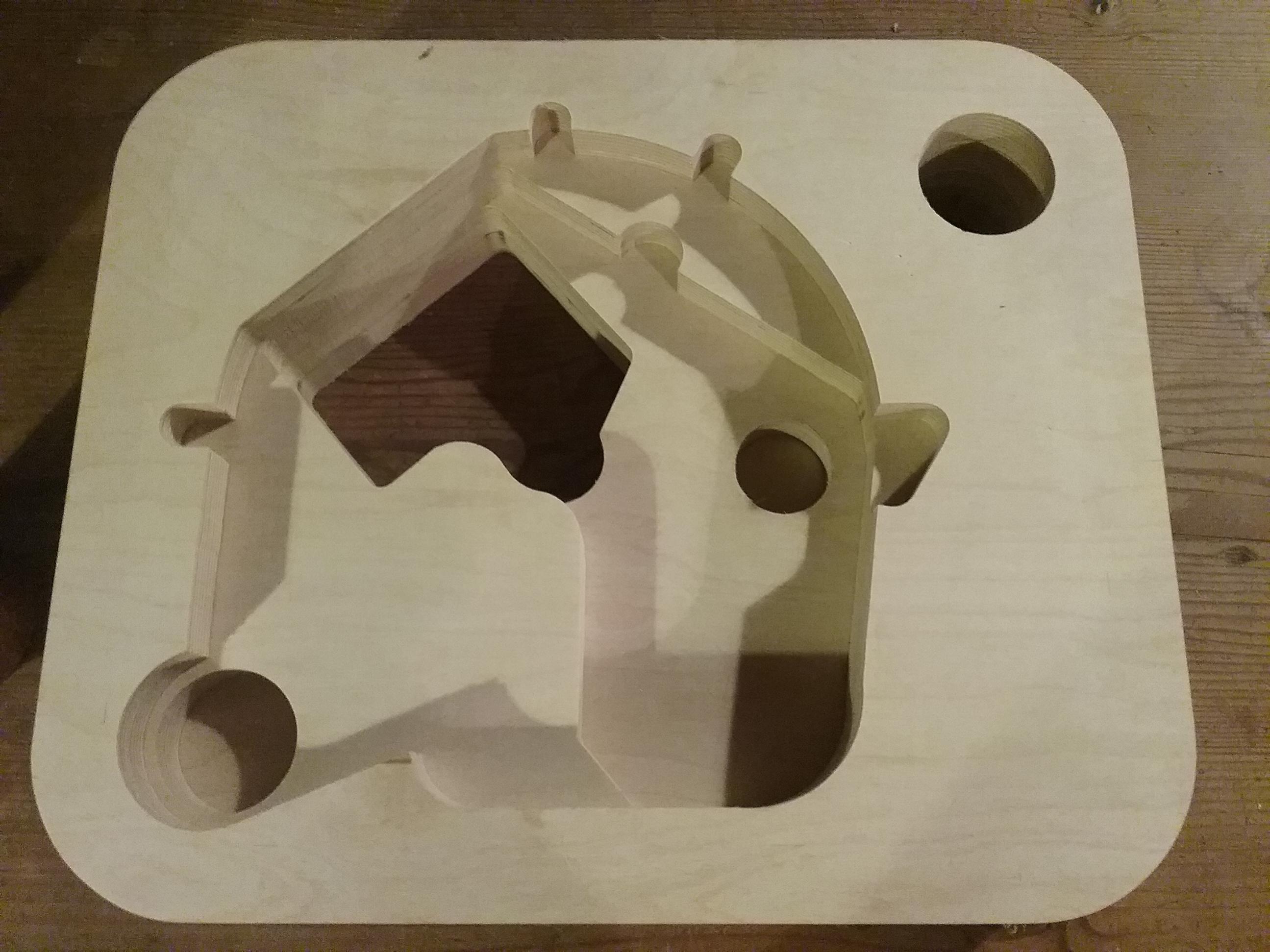

Here is pic of my plinth. It needs a bit of work. May try making my own veneer. It is four layers of 25mm Baltic birch plywood.
