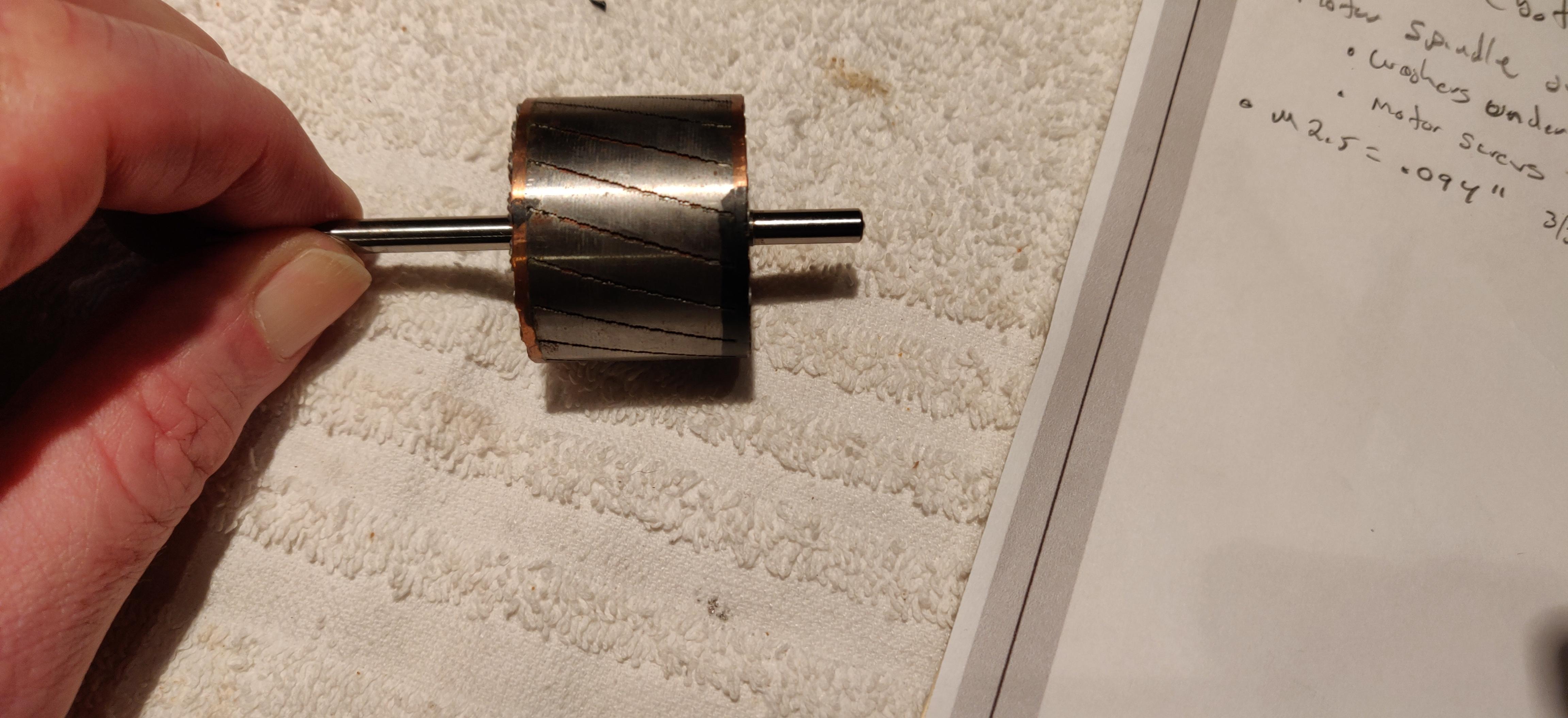

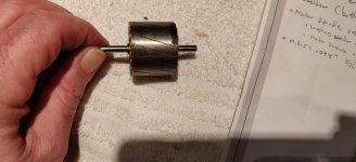

I just started a motor rebuild with supplies from Audio Silente, including Mk2 motor upgrade posts. I have a Early Mk 1, ser # 179xx. Upon opening of course the old oil was pretty dried up and sticky but it still could rotate around 1620 RPM. My rotor (the rotating piece in the motor) has a black mark about 3-4 mm wide around approximately 1/2 of the diameter of lower portion of the rotor. Is this normal? I don't remember seeing pictures of this in other rebuilds. It does not appear to be rubbing wear, looks more like a thin coating.

So motor rebuild is done. New coils, new felts and bushings all from Audio Silente and new 2mm ceramic BB. I rewired the table, new 33K resistor and .01uf cap and cleaned the switch of any oxidation. Motor has been running for about 1 hour on the test stand, current temps are about 114-116 F. RPM's are 1736-1740. I am going to let er run for a few days and hope the temps drop a bit as it breaks in.
