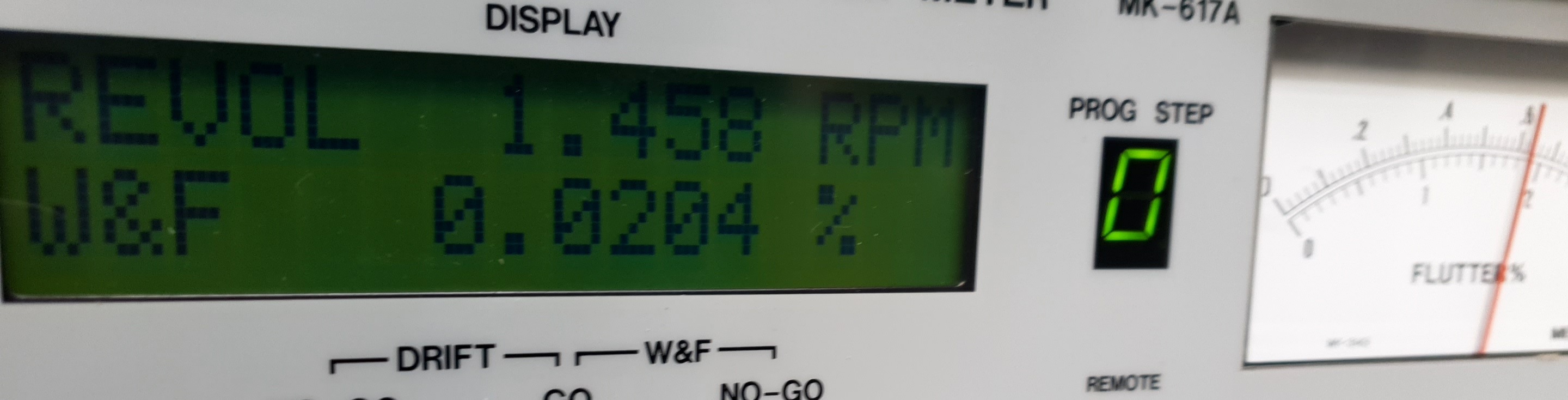

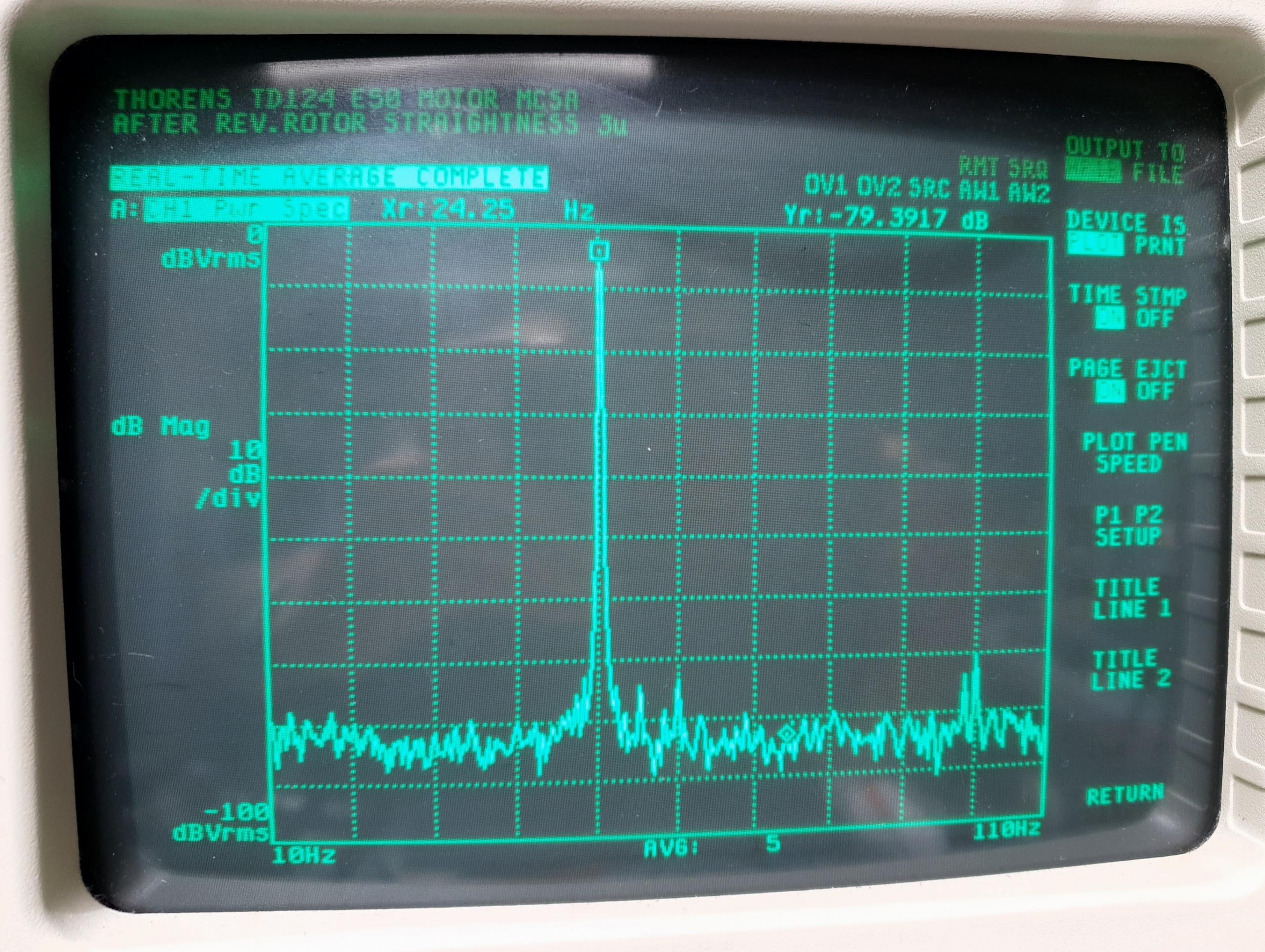

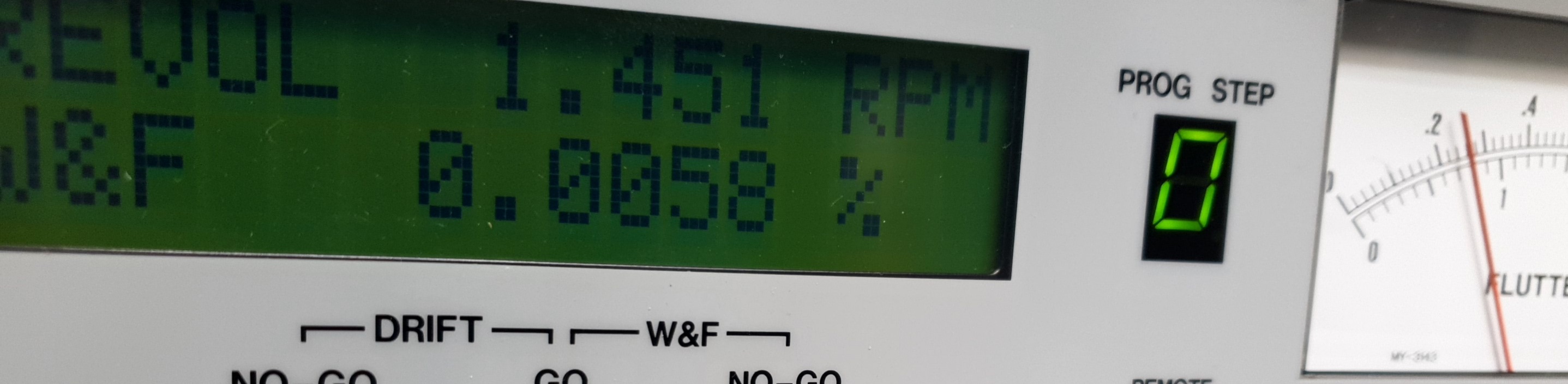

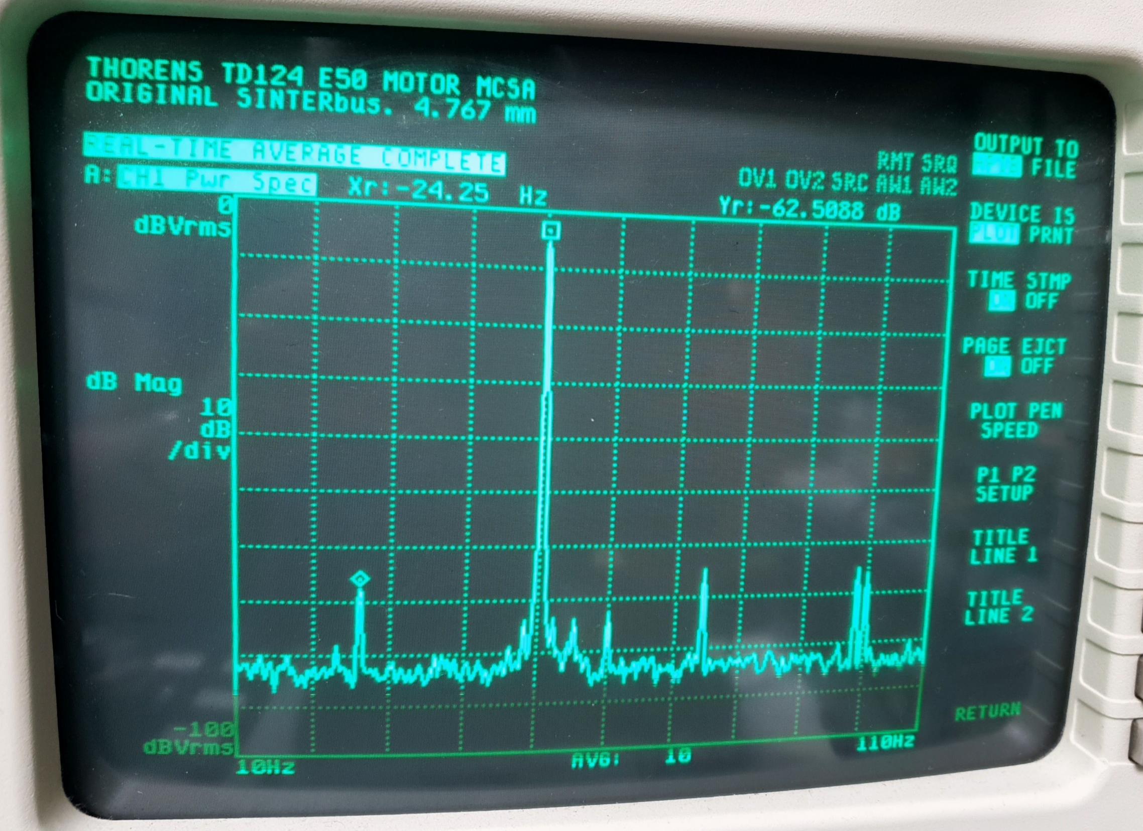

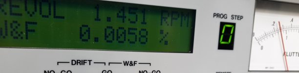

After a long time of not having followed this thread here are some measurements to show that it is not a luxury to replace the bearings of the E50 motor.
First a E 50 motor current spectrum with rotational sidebands of a cleaned and re-oiled motor with original sinterbushings , measured diameter 4.767 mm .
and flutter figure from the motor itself.
Second a revised motor with new sinterbushings 4.750 mm and the flutter
measurement.
Results speak for themselfs,
