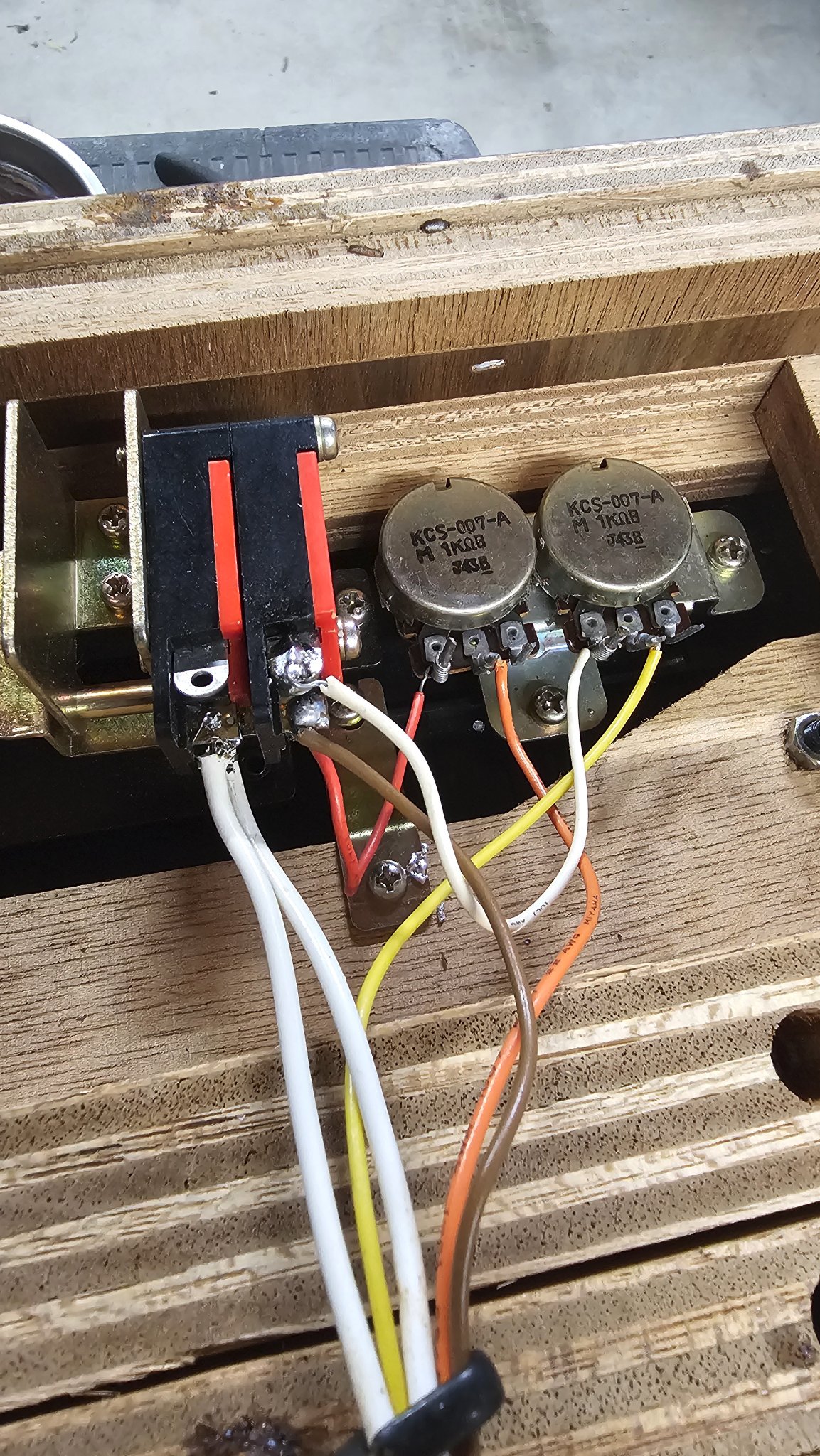

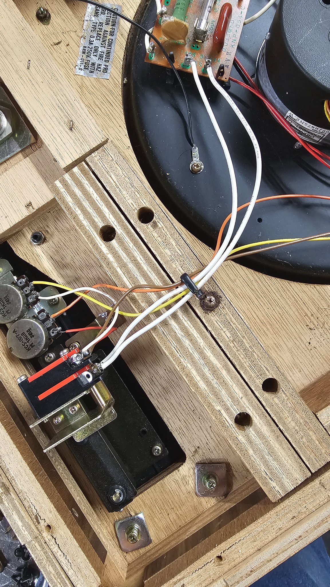

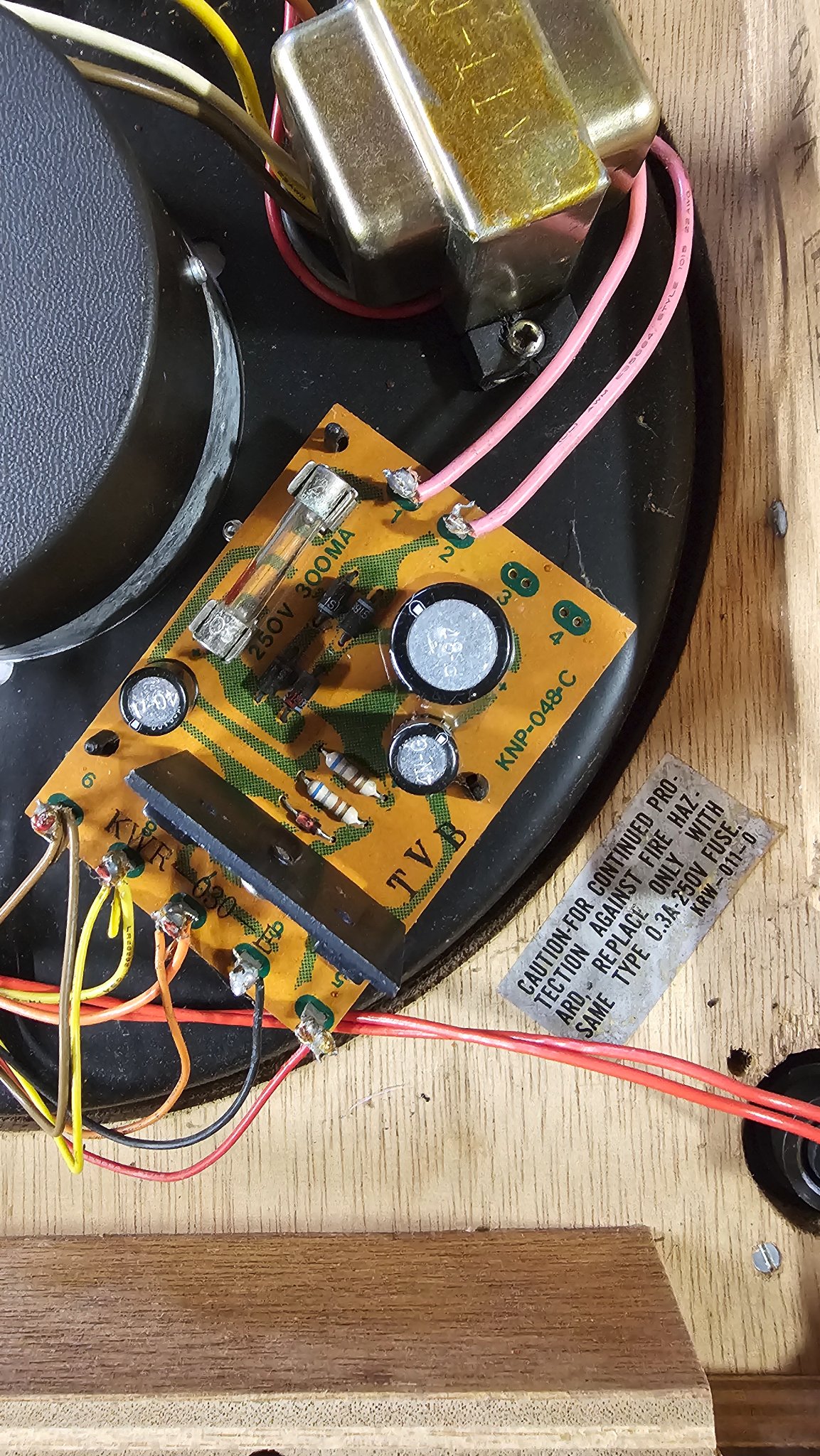

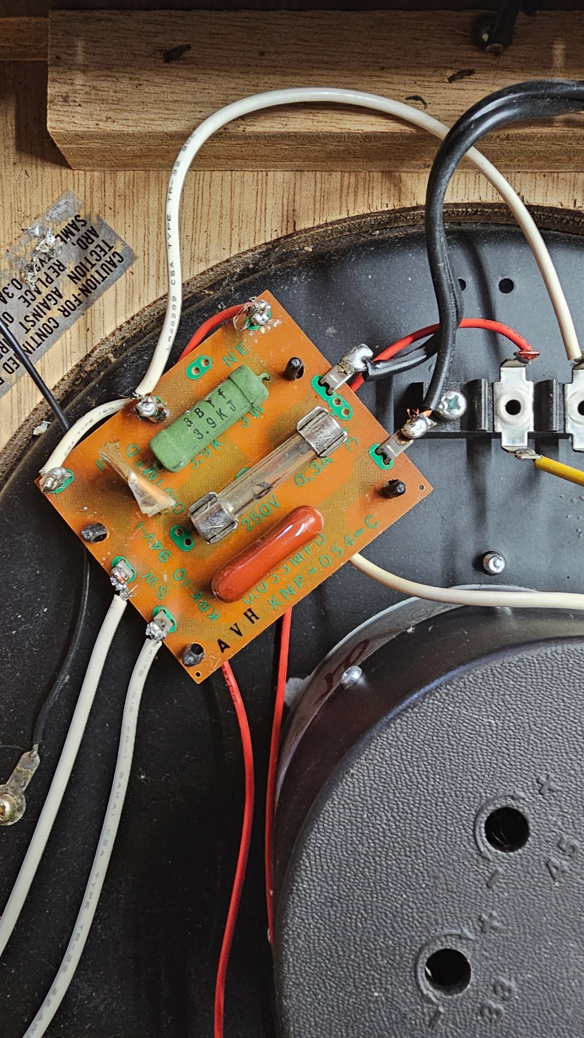

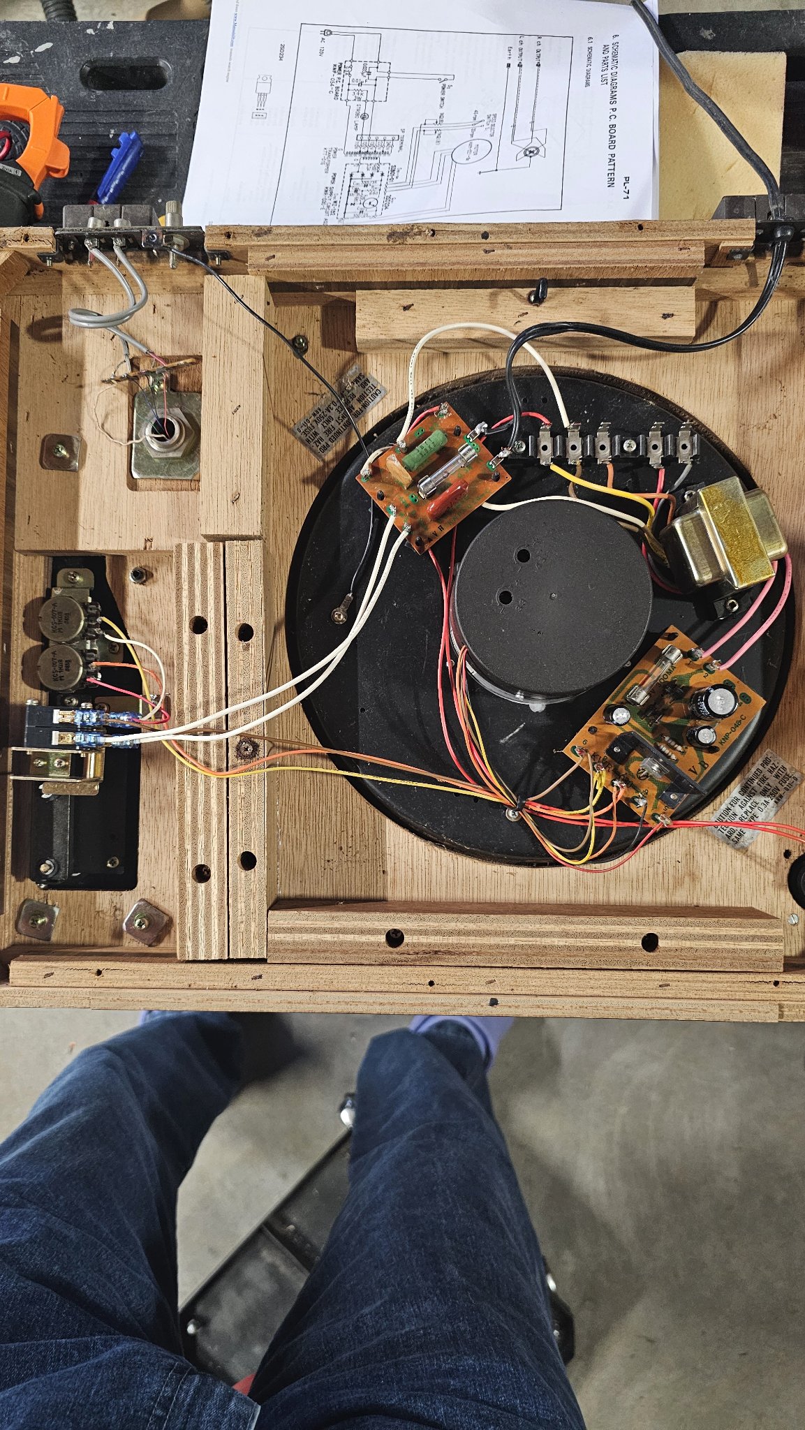

6L6: I didn't get to posting the photos last night. Here are the ones I took. Also, I did some testing on the voltages. Here is what I got:
Power Leads from the plug to the power board: 120V
With 33 speed selector pushed down: 120v across the 2 white wires at the switch and of course on the power board also.
The 33 speed Pots: DC current voltage of 36v (Not sure if AC voltage is correct for a Pots or not. So I took a DC voltage reading)
Power to the Strobe Light is 15.6v but is doesn't light up.
The 45 Pots: 0 V
