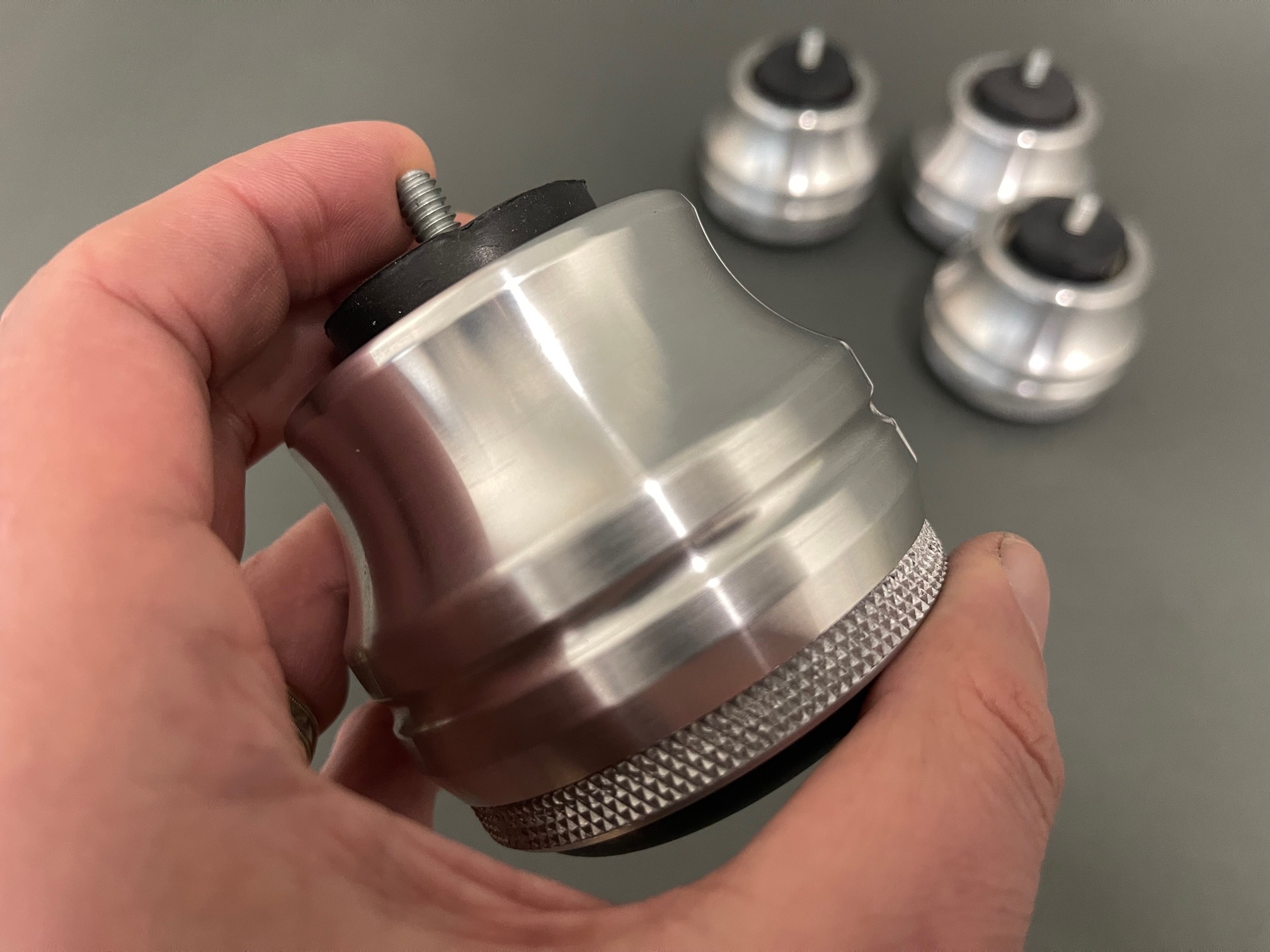

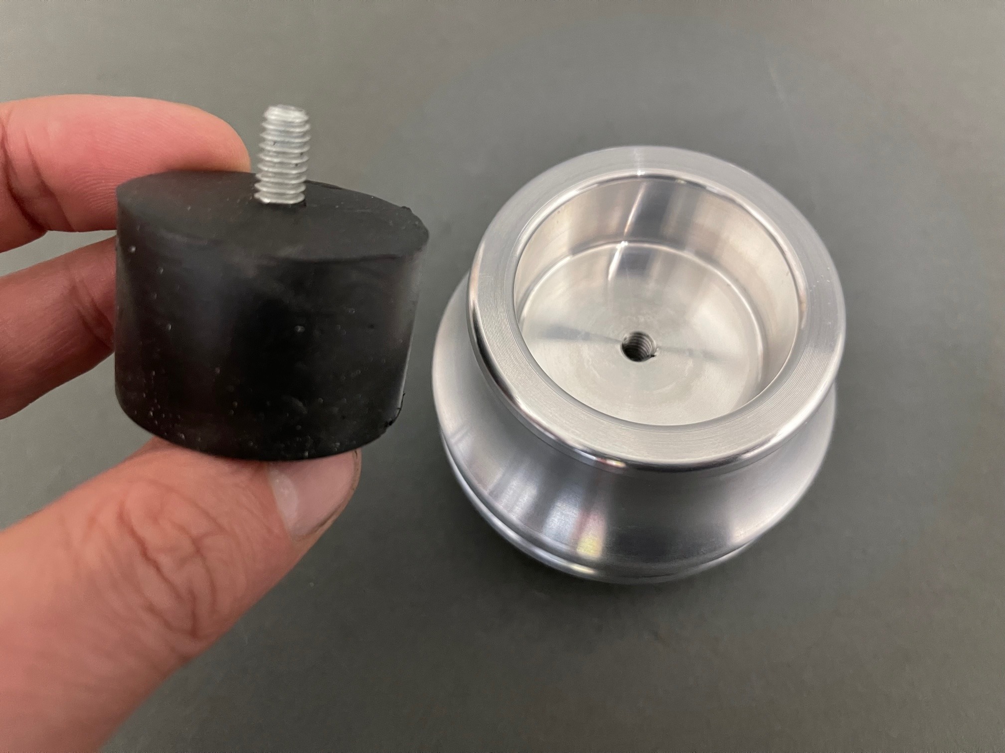

Thank you for your quick reply. I've had several inquiries about making turntable Isolation upgrade feet for them. In my research, the Pioneer PL-51 and PL-55x share the same bottom cover design, so I can cover those models as well.
That is worth look at for sure, feet seem to make a very large difference on all turntables. Looking forward to hearing about your findings. I can wholeheartedly recommend Isonoes for the SL-1200, it’s not a subtle improvement.
But I have also had outstanding success with simple Vibrapods, and at the cost, is worth trying on any table.
Will do. I will use large sorbothane isolator in my turntable feet. Currently working on Height adjustable Isolation foot

Also, @MonsterMawd I installed a set of your feet and they did wonders decoupling the turntable form the floor and cabinet. Thank you!
