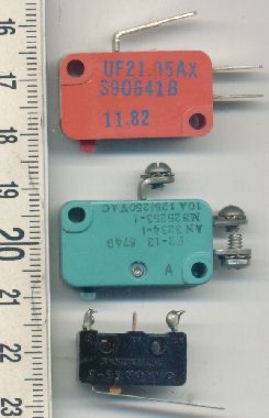

Thanks. Are you referring to the micro switches next to the pots? That's the only switches I know of.
Yes.
The 33 and 45 buttons will activate the power switch (turning the TT on) as well as the appropriate speed select switch when depressed, the power off button will open those switches. (turning things off)
There is some mechanical interconnection with those three buttons, but the switches themselves are standard snap action Microswitches, similar to the photo below.

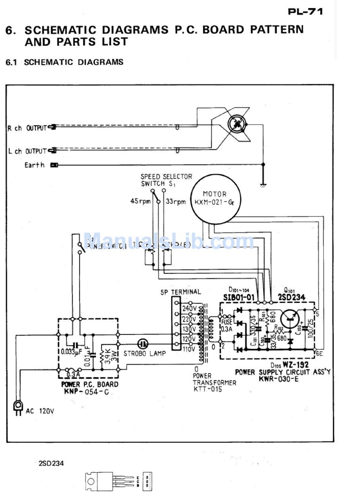

Hi 6L6, I finally got a chance to check out the micro switches. I did find a loose wire. I soldered it back but get the same response from the motor. I did notice that the 33 rpm button does nothing but the 45 button is the one that tries to start the motor.
I tested the switches and when you press the button they both test with continuity. If this is the case could the switch still be bad or would it be something else or the DC converter board?
Thanks MattHauck. I ran into something strange with my PL71. In the photos of the restoration work done in this thread, the image shows 3 micro switches. My PL71 only has 2. We're there different models of this TT? The 2 that are on mine, are next to each other close to the pots. One under the 33 button and the other under the 45. The 33 switch has 2 white wires going to the power board and the other has wires coming from the pots. I would post a photo but I have already taken the switches out. I don't know if someone who owned it before, made mods or not. Do you think I should re-wire to have three switches? I started this project because it would not turn on to begin with. However, I was told it used to work fine and just quit running.

Can anyone provide input from my post on 3/3 @ 8:04? I'm still puzzled by the wiring difference plus when I put the 2 new switches on, I no longer get the strobe light which I was getting after putting in a new power board. The board that the plug wires go to, not the one that converts to DC.
