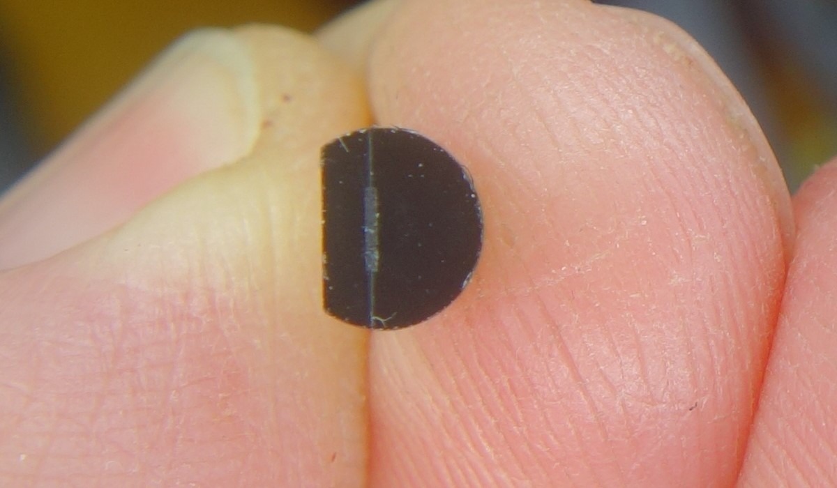

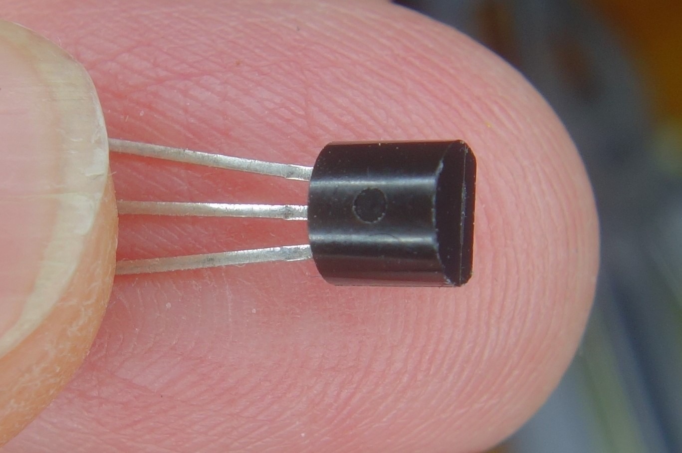

Ok, here you are. This is an original K170 - curve tracer proved.
All of my K170 show the same kind of somehow whitish but not white imprint.
All of them show the same characteristics on top - from the moulding process. The breaking point of the injector is always in the middle of the joint.
I have had a lot of them and all looked like that.
J74 share these characteristics.
Hope this brings you somewhere.
