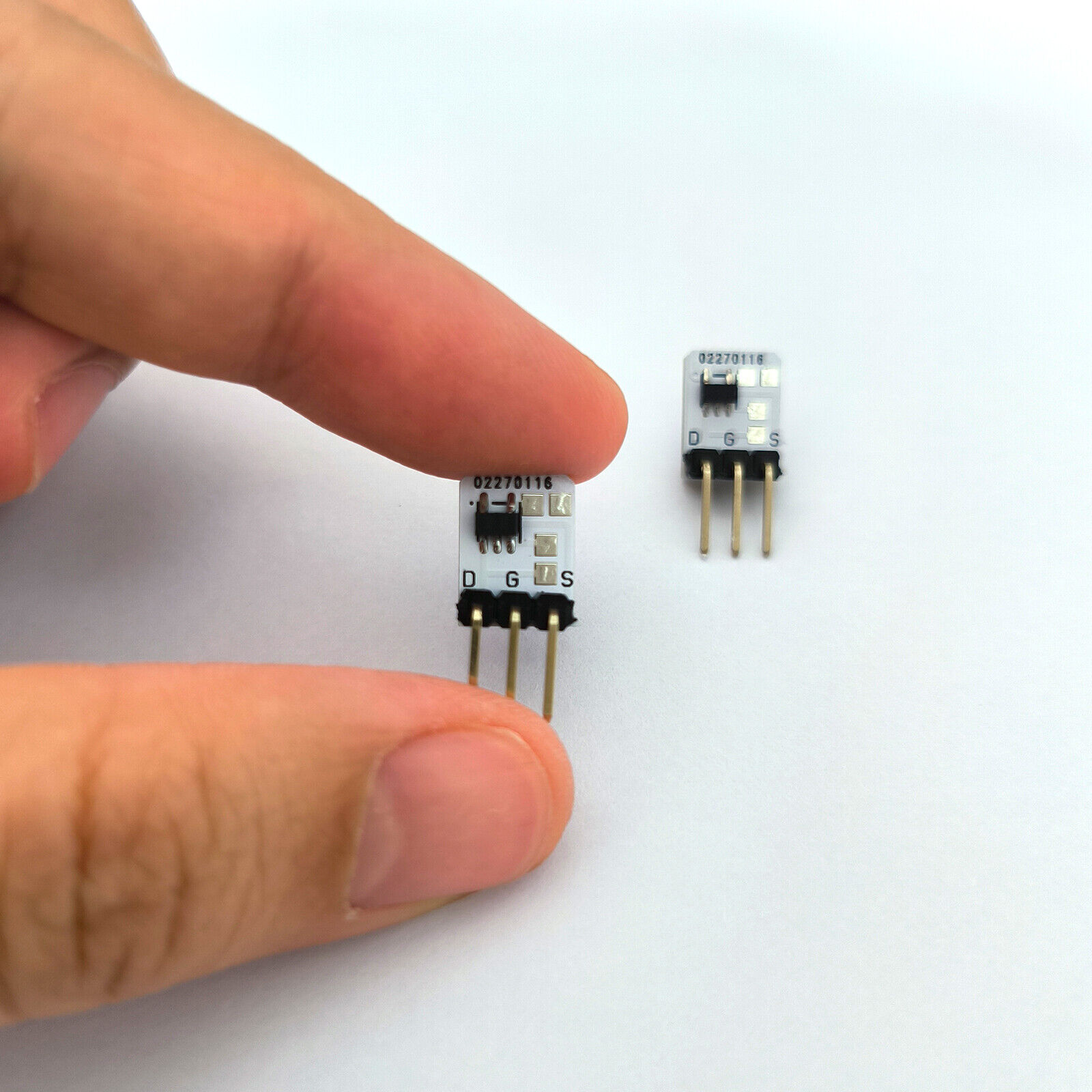

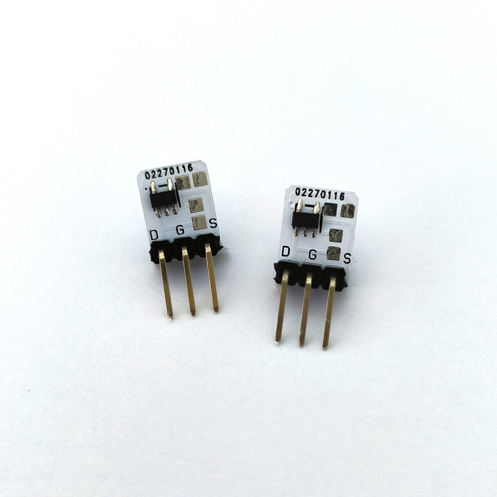

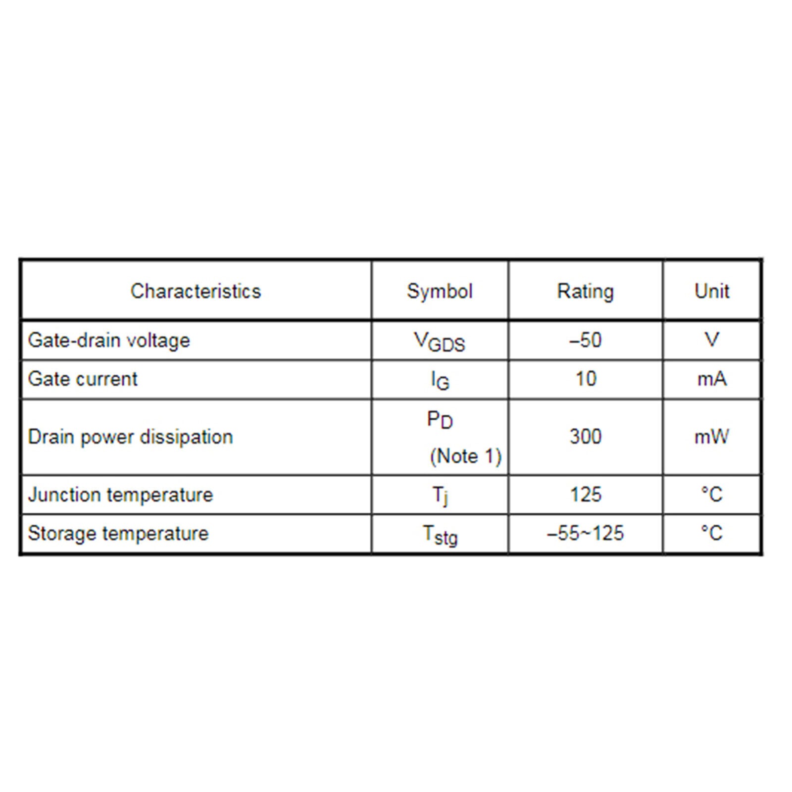

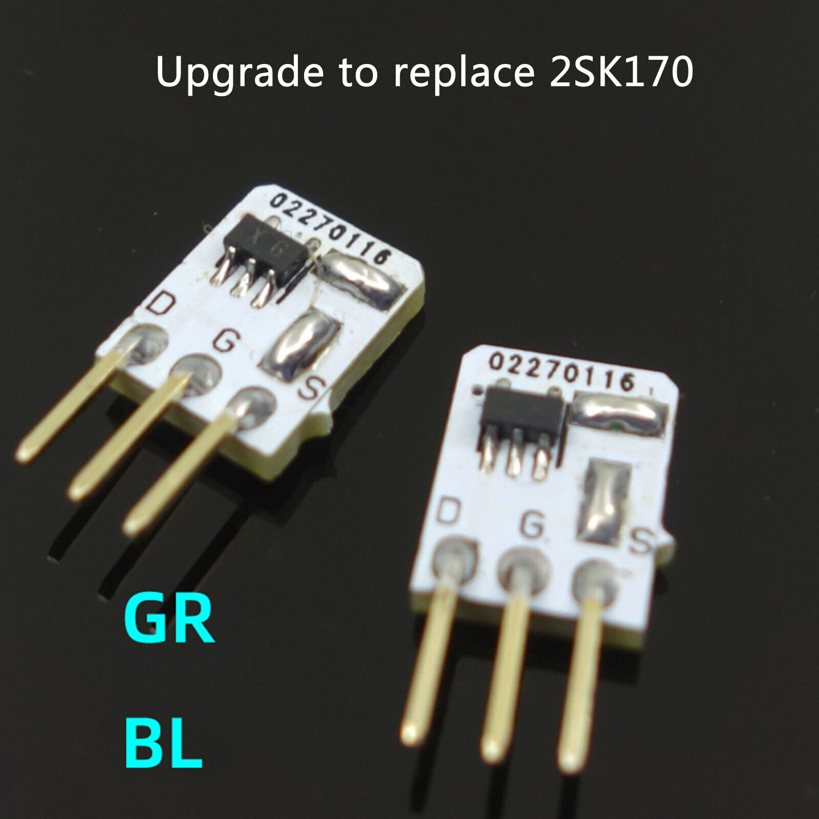

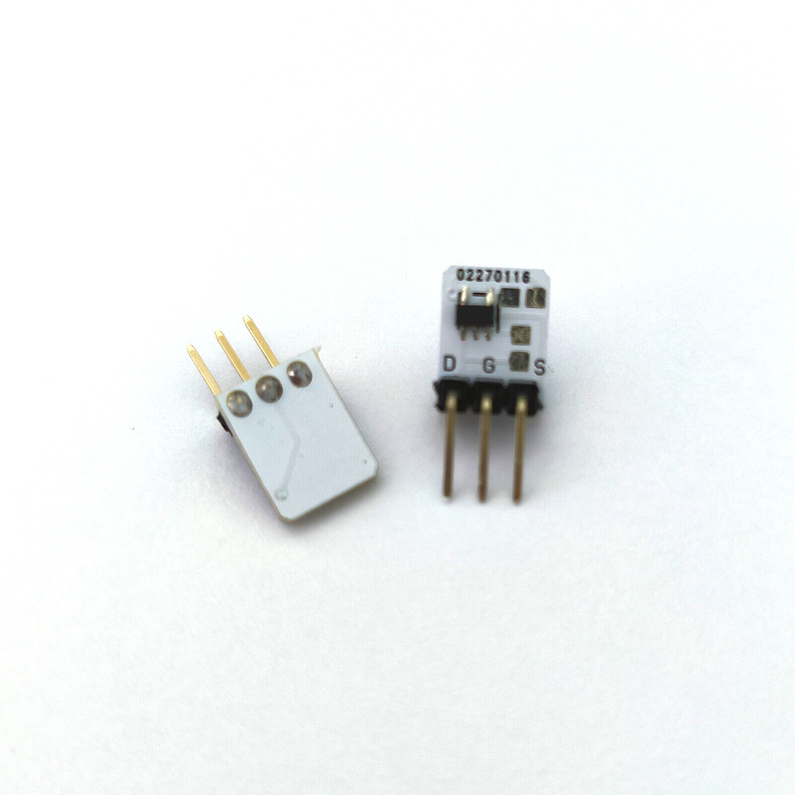

it seems someone is taking 2SK2145 as substitute for 2SK170, using case adapter pcb
treating those 2 JFets in one case as one
from 2SK2145 datasheet .......X is type, G is GR current rank, in this case 2.6-6.5mA
doable and effective, but only if taken care of current ranges (GR, BL, V) and appropriate translation between origin and substitute
so, practically translated to BL range of 2SK170, 6.5 to 12mA
Is there supposed to be something underneath those two areas that almost look like, I hate to say this, solder blobs (first picture)? I also think this cat could use a little less solder on those pins personally, but that’s just my own opinion and you know what they say about that.

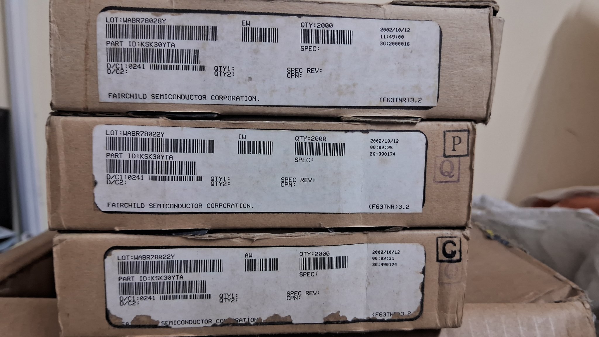

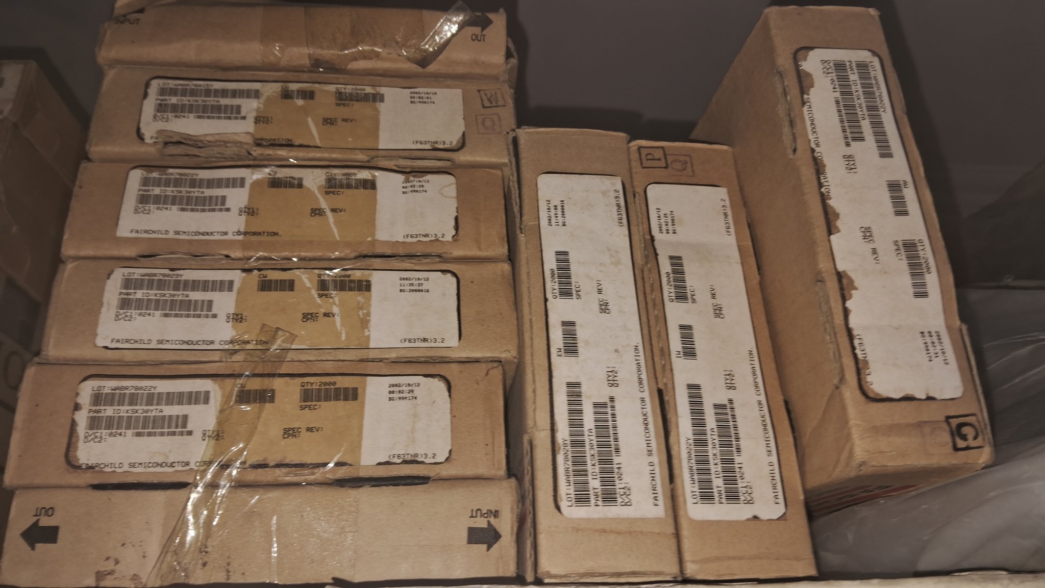

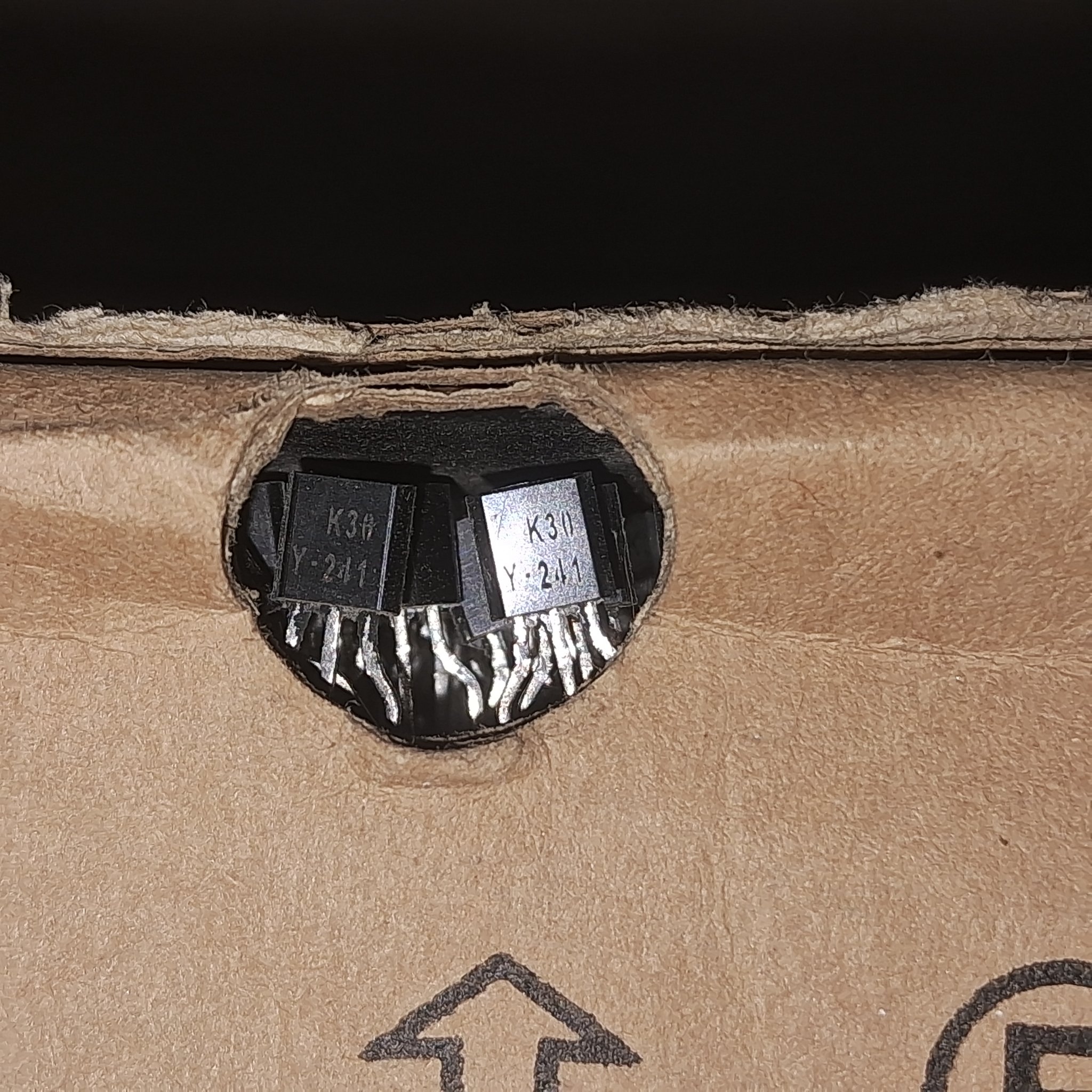

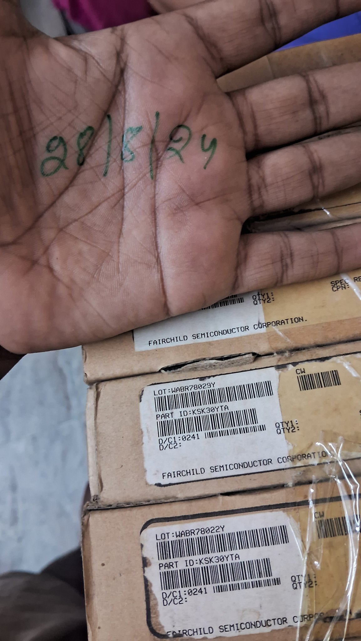

Hello everybody,
I recently find some boxes of Part ID:KSK30YTA D/C1:0241 2002/10/12 Made by Fairchild
I know they are JFets, that's why I bought them as soon as I found them in a local shop, shopkeeper was doing a clearance sale hence they are from 2002
I don't know much about this part and how to make use of them,after doing some quick googling , I found that they can be used to make Audio Circuits,
Problem I'm facing that I don't know how to make proper use of them, how to measur , match them and make sure they work as they should be,
Does anyone have very simple way to match them without any fance equipment setup? Please Give some advise

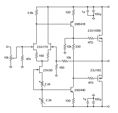

If anyone of you of have a good Pre-amplifiers(Headphone Amps),10W-20W Class-A with BJTs or Hexfet MOSFets in output stage, any audio circuit which is simple and can make of this jfet ,please share the schematic
Designing a device with them and publishing the schematic here seems to work pretty well. The more and longer obsolete the higher the demand.
18000 pieces, congratulations wealthy man!
2SK30 is sometimes used as current source in low voltage tube buffers. I happen to also have a lot. Not 18000, Toshiba though 😀
Reactions: VIPINSAINI20
@jean-paul , man i'm not a wealthy guy, I just got lucky, I didn't paid much for them, I just got them as cheap as BJTs boxs comes in wholesale.

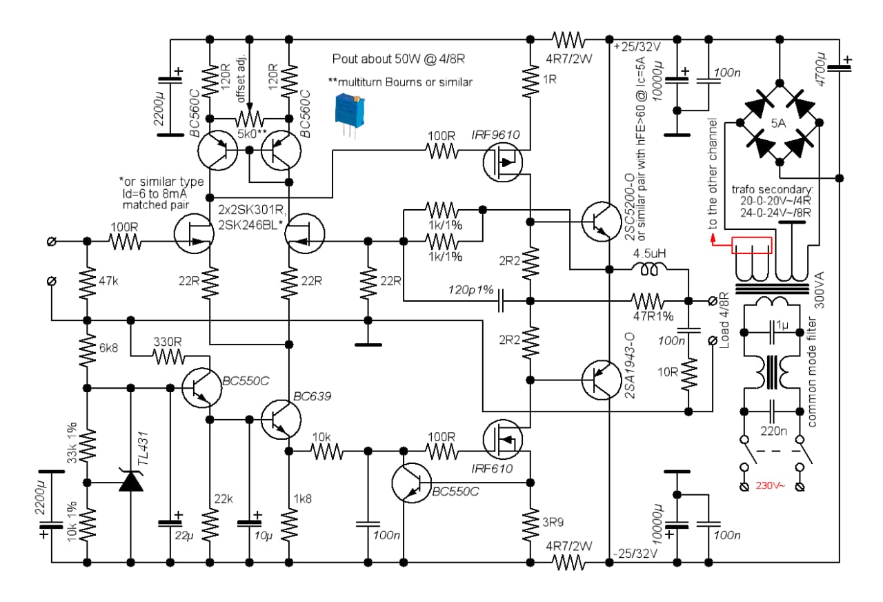

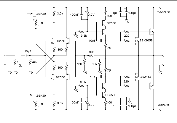

I have find(with help from a good friend) some schematic but i'm not sure they will work there, because I wants to use BJTs or HEXFETs, but I find schematic with those hard to get laetral fets, like in these below not with Hexfets
MosFet +.PNGWhatsApp Image 2024-06-07 at 00.10.26_b5b3982f.jpgWhatsApp Image 2024-06-19 at 20.58.30_4026bd2a.jpg
Is it possible to use them in these schematics? please let me know
