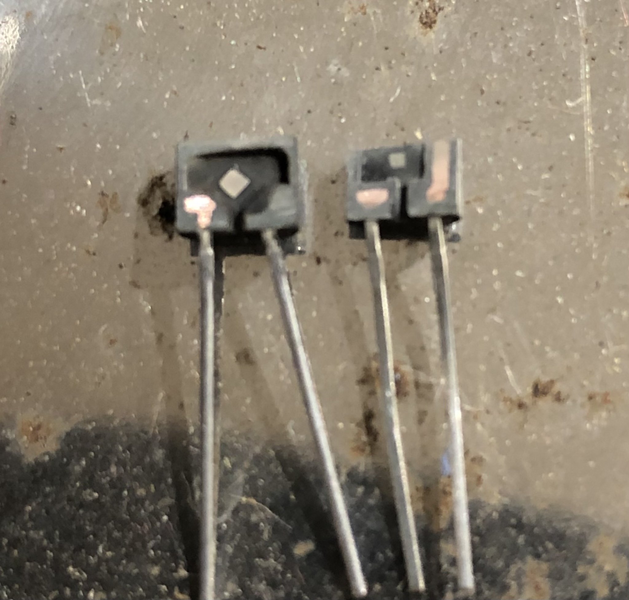

I recently was offered 8K Toshiba 2SK170 and 4K 2SJ74. The deal was for genuine parts subject to testing. We don’t really need them but I can’t say no to fets.
Six genuine Toshiba boxes showed up with sealed bags. The 2SK170‘s date codes matched the boxes and were the real deal.
The J74’s had dc parameters not matching genuine parts and the date codes didn’t match the box. Internally the lead frames matched but the die didn’t. The broker took the J74 parts back, they mostly deal in digital parts and couldn’t test them.
Plenty of fakes out there.

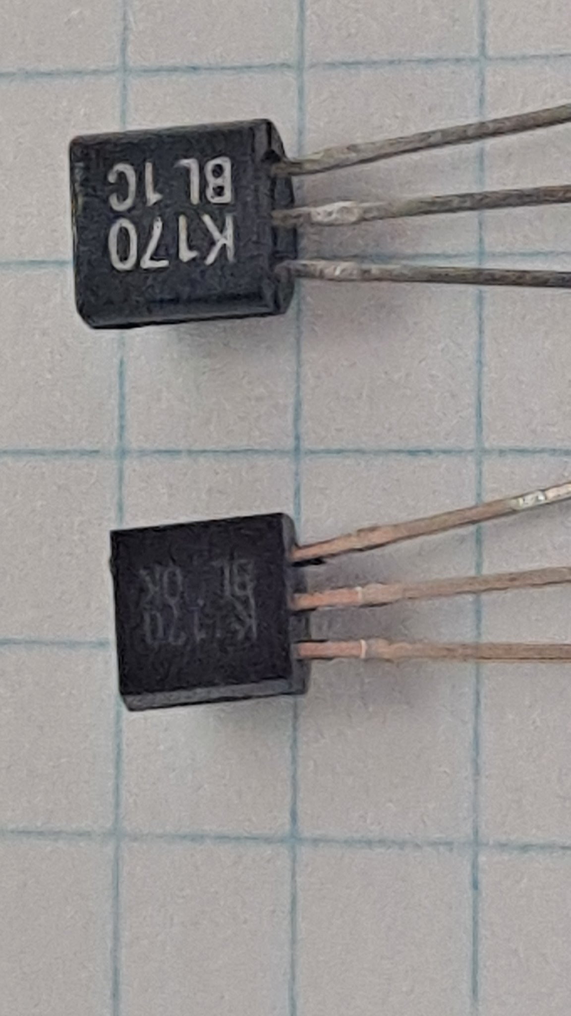

I have two sets of supposed 2SK170BLs, one of which was purchased by Siemens when I worked there in early 2000. Normally we purchased parts directly from the warehouse at the manufacturing site for the product in development. Only when a component was not already set up did we buy from distribution such as Digi-Key, Mouser, Allied, etc. I got the parts when there was a scrap sale including bins of engineering samples that were no longer needed. The second set I purchased years ago (Forgot when) most likely from Ebay.
The latest set have the laser marked information with the straight leg on the "7".
Sorry for the poor picture quality.
The oldest set from Siemens have silkscreened markings with the curved "7"
So I ran the test with a 100R resistor in the drain with a 50mV AC input to the gate, +/-10V supplies, measured the output voltage at the drain and calculated Yfs as well as measuring Idss.
For the most recent parts with the laser mark and straight "7" I got:
ID(mA) Yfs (mS)
8.65 19.8
8.96 18.4
9.12 20
8.7 18.4
8.68 18.0
9.15 18.0
9.06 19.2
9.0 18.0
9.44 18.0
9.19 19.2

The first parts are within the range of Idss and Yfs for a 2SK170 BL, however they are still suspect based on the time purchased (within the last 5 - 10 years). The only way to confirm would be to test them for noise floor. I may try building a test set for that.
The second parts are interesting. Even though the Idss is well above the "V" range someone sold them through a major USA electronics distributor. I have seen mention of LSK170s with Idss so high above the expected range. Maybe these are early remarked LSK170s?
I just looked at my stash of laser engraved BL, and they average 8.4mA Idss and 33mA/V Yfs. So your idea of rebranded LT may be right. AFAIK, LT's been struggling to get high enough Yfs.

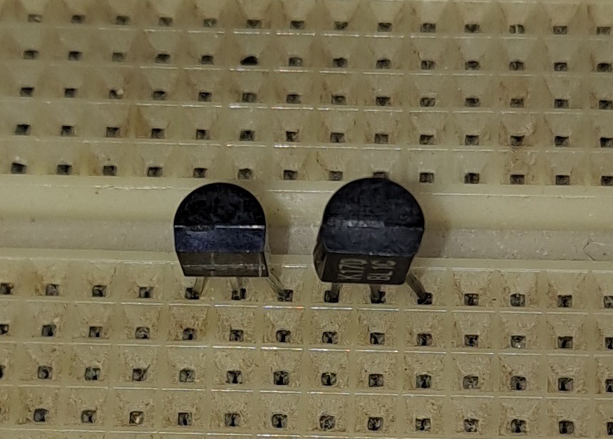

Left is the newest part which seems to be within spec, both electrically and physical dimensions. Right is the older part with high Idss and Yfs and slightly larger than spec.
Also the circular indention on the back rounded surface is clean with no markings inside the circular depression.
For me the right one looks more like the right one. The left one looks like a J11x. They also have a circular ditch on the rear. But from what I can see I wouldn't bet on the right as well, because the top of mine, which I have bought 15 years ago, do look different. If interested, I'll show a pic tomorrow. Cheers.
