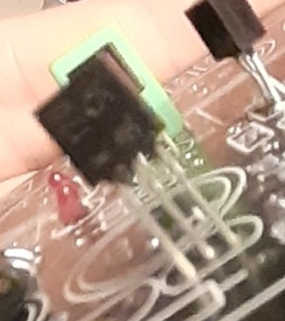

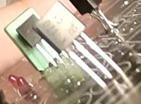

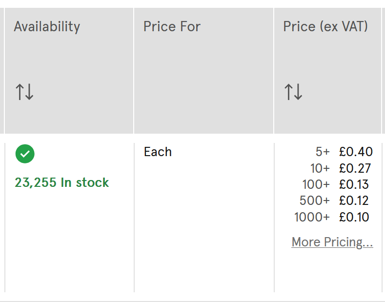

Hello member @Borats Baby , if you are able to find the pinout diagram on a transistor's datasheet, and understand which pin on the transistor is the gate, which is the source, and which is the drain . . . . then I have some good news for you. There actually does exist a thru hole JFET which can be used in place of the 2SK170 on the Amp Camp Amp board and nowhere else , which is in stock at Farnell UK today, and which costs GBP 2.00 for a bag of five JFETs. Better still, it's been proven. Many dozens of diyAudio members have used it successfully to build an ACA in a weird hedgehog chassis called "RACAM - Round Amp Camp Amp Monoblock". Their amps worked well and sounded wonderful.
The new, cheap, Farnell-stocked JFET has a slightly different pinout than the 2SK170 so a bit of mental gymnastics and fingertip dexterity will be required to stuff the new JFET into the 2SK170's footprint on the ACA printed circuit board.
So, allow me to inquire: are you able to find the pinout diagram on a transistor's datasheet, and understand which pin on the transistor is the gate, which is the source, and which is the drain?
Here's a diyAudio member's young daughter, building a RACAM. IMPORTANT FACT: RACAM is now obsolete, and has been replaced by "ACA Redux" which you can search for on this site.
