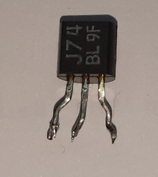

Cleaning endless unfinished projects and scrapping parts from something I will never finish I found this. It worked ok as I remember (many years ago), but does that look like a real J74 to you? It has a dimple on the back and that top notch is 2.3mm as on original jfets, but those letters...
its toshiba. likely j-fet. likely p ch j-fet. i have had some GR version of some toshiba j-fets with those marking. they were genue.
Thank you! And the later ones are etched right? Just to be sure how etched vs printed look/feel like 🙂

Yes, later real ones were etched but with a curved leg on the "7".
Both of the pictures show etched 2sk170's. The top one is fake and the bottom was taken from "punkydawgs" eBay seller who is known to sell the real deal. I have purchased from him and the parts tested real.
The older real printed Toshiba's (like the ones you have) tend to look fuzzier with wider numerals, you most likely need a magnifying glass to see that it is printed. You don't come across many of those out in the wild so most won't need to identify them but as you have shown they do exist.

This is how I see it:
Straight leg "7" printed = good (but rare), straight leg "7" etched = bad, curved leg "7" etched = first good clue that it is real

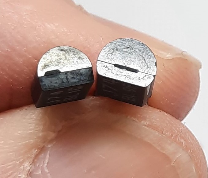

Hi soundhappy,
that one on the left is for sure a fake: Yfs 6.7, Idss > 12 mA.
Only that one on the right is an original.
But to compare this one, size, the marking at the top to the original on the right.
(It was a photo I had at hand)

nr12,
I would agree with Soundhappy. The one on right looks genuine. Can you say if the straight leg "7" is etched or printed?
I would like to know if Toshiba ever made (maybe very early on) a straight leg "7" that way etched.
