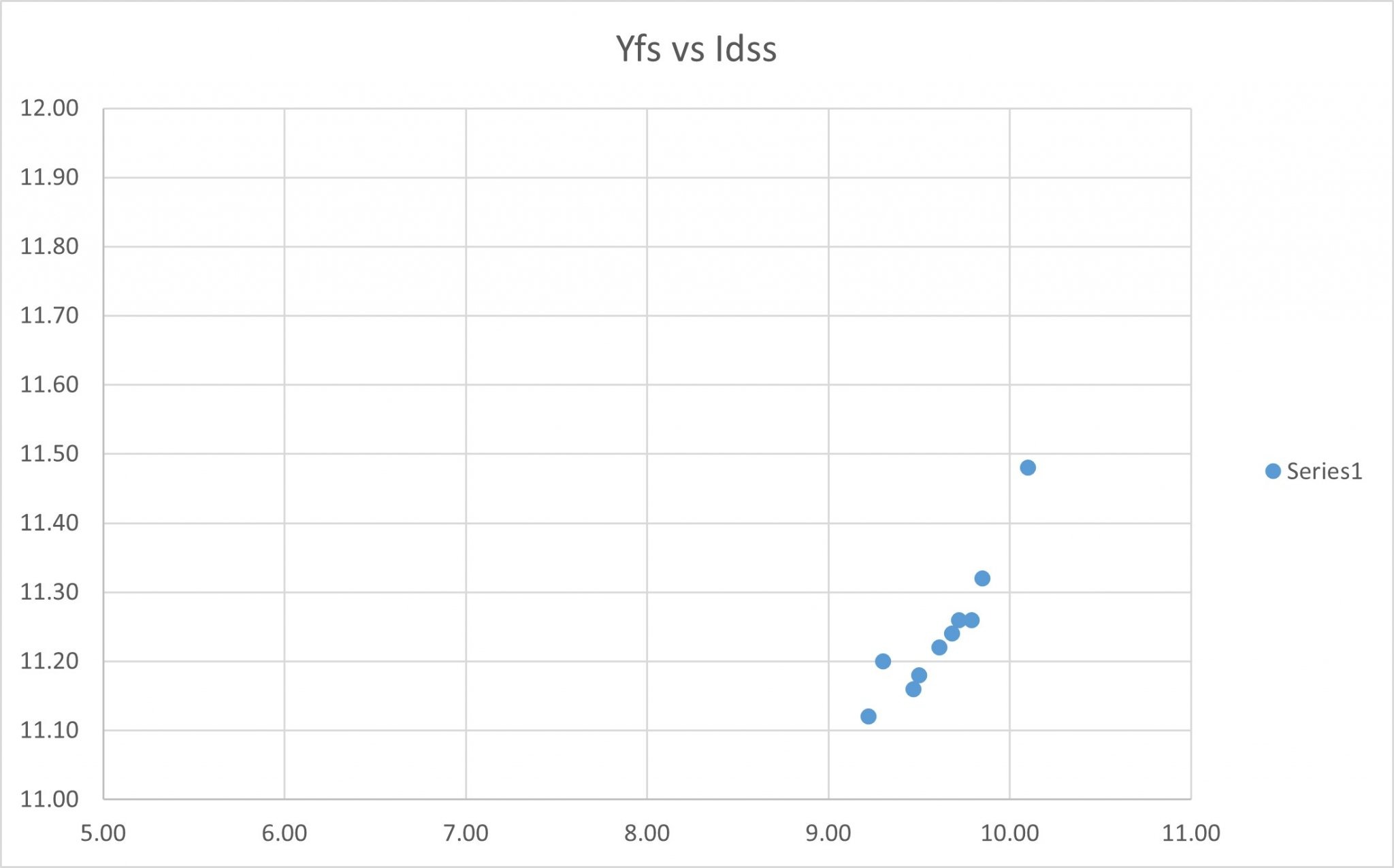

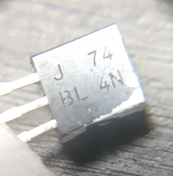

Some additional data points: I recently ordered 10 pairs of J74/K170 just to see how fake fakes can be, apart from the lettering.
I received 10 pcs J74, complained to seller, and promptly received the full refund, so nothing to complain about.
Nevertheless, I tested them using EUVL's jig, Vd=9Vdc and Vg=50mVac:

Btw, don't worry about the white paint, I tippex them so I can write on them with a sharpie.

- Idss is within specs
- Yfs is only half of the nominal 22mS
- The dispersion of the parameters is minimal, I don't know how they do it; quite remarkable
Yfs for 2SJ74BL at 10mA is 40mS.
So miles out.
And then you should also measure noise.
Because that is what you pay for.
Else just buy J17x.

There's some discrepancies within Toshiba' datasheet: the table says 22mS Typ., and the graph indicates 40mS as you said.
Anyway, 10mS is OK-ish in a lot of applications, for $0.50 a piece.

~40mS is also what I measured, from thousands.
10mS is 100R Zout in follow mode.
As I said, decisive is not (only) Yfs, but noise.
