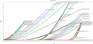

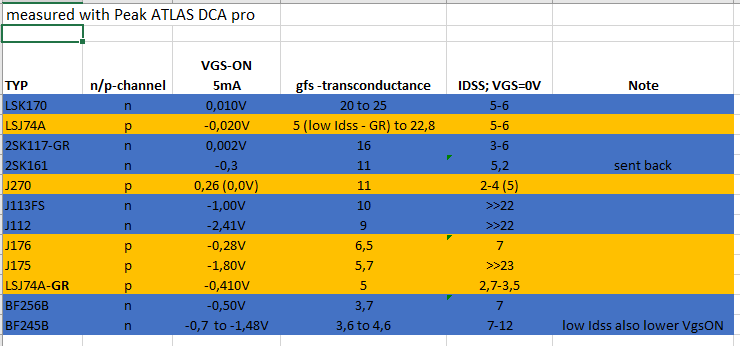

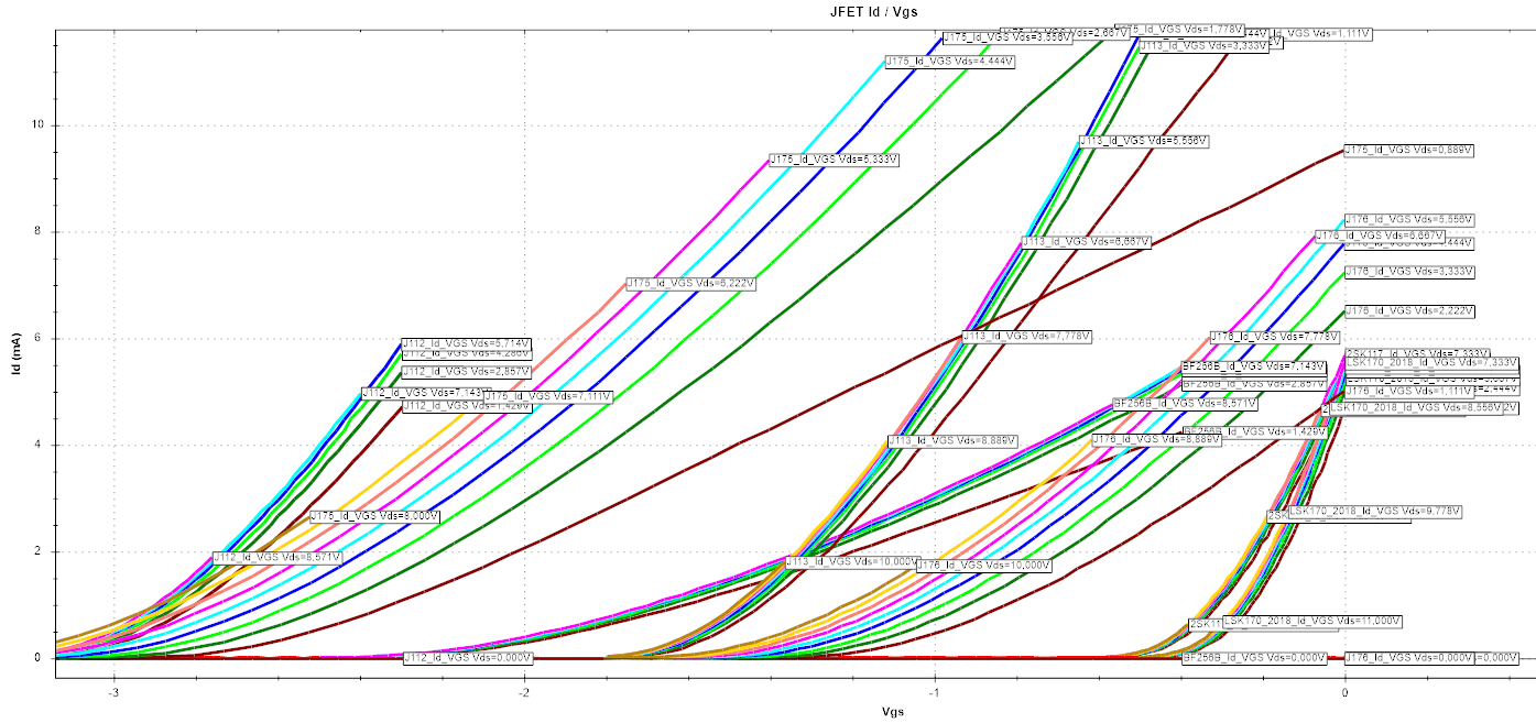

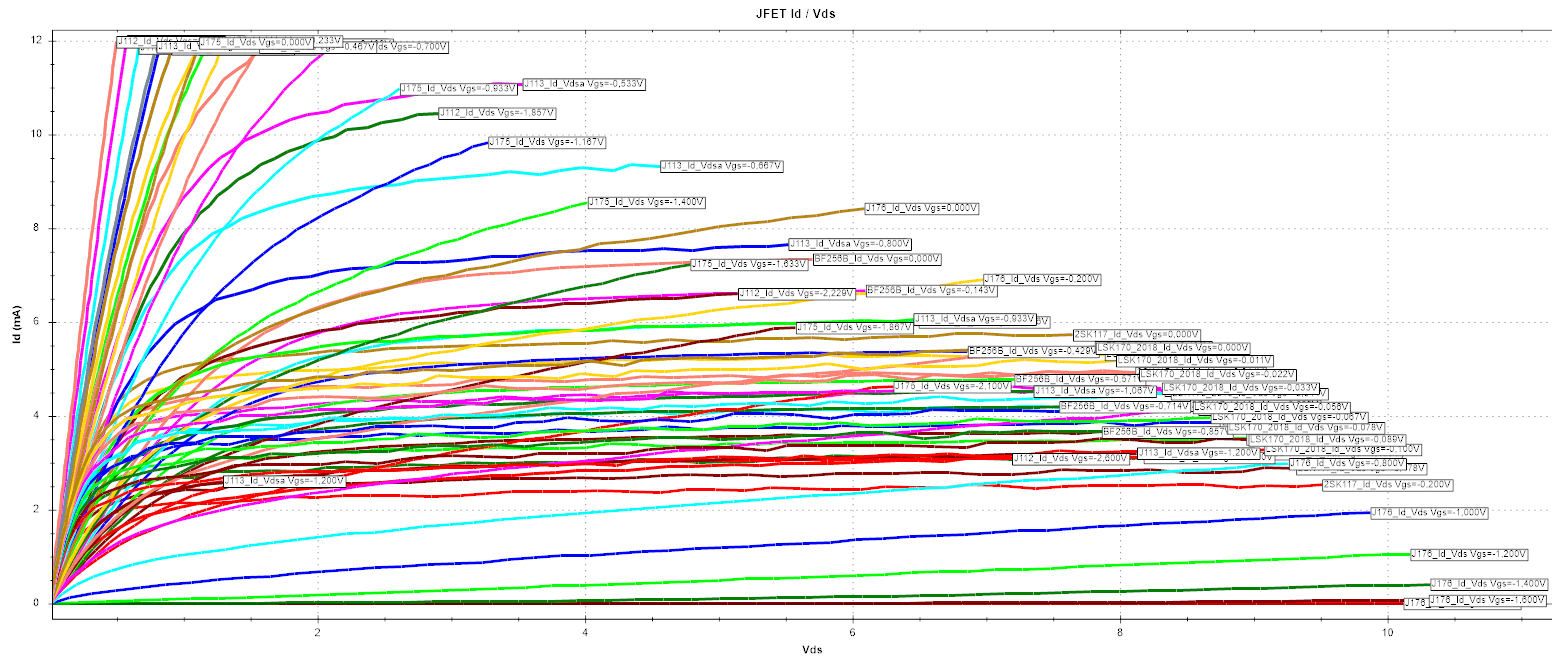

i want to share my small experience with some selections and measurements with JFET´s -this are average datas
got some droubles with 2sk161(think -ESD failures) but expect new one this week.
hopefully after end of may a have time enough to go deeper inside......
meaning i want to try some IPS boards like the different version in the project M2X with a lot of different JFETs on Input power stage boards.
have a nice day - Harry

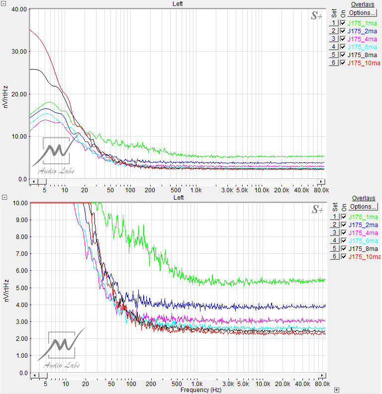

I can't help myself, so gonna drop a reply and in so doing also help others who are looking for a lower cost alternative to the SK170-SJ74 combo. I am working on a pre- and power amplifier and would like to have alternatives to the Tosh and LS parts. One can always design such that the board can accept both SOT-23-3 and TO92, but back to the question of equivalent or "good enough" replacement parts that are in production.

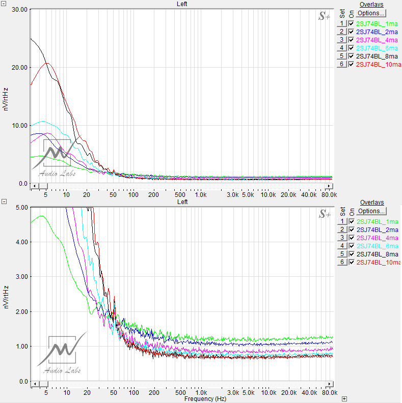

I found a website a while ago which performed noise tests on FETs, diodes etc. So lets compare the P-channel "underdog" mentioned a few times in the thread, namely the Onsemi J175-177. Just a heads up hear, the J177 is no longer being produced, but would otherwise be interesting to compare with. So we are left with the J175 and J176 which is the TO92 part, while MMBFJ175 / MMBFJ176 is the SOT-23 variant.
First, lets look at the noise picture of the parts.
- Spectral noise density of 2SJ74BL JFET with different Ids values -
- Spectral noise density of J175 JFET with different Ids values -
- Spectral noise density of J176 JFET with different Ids values -
What immediately strikes me is the difference between 175 and 176 and the later is far better and more similar SJ74 in its character, albeit with a higher noise floor than SJ74. Since we have data for an Idss of 8mA, this is what we will compare.
Average >100Hz: The SJ74 looks to be at 0.6-0.7 nV/Hz while the J176 sits comfortable at 1.7-1.8 nV/Hz. Maybe not a disaster, but notably higher. But there is a "fix" to the J176 noise and that is paralleling several devices and up to 4 pcs. I f we do so, the noise is halved from 1.7-1.8 nV/Hz to 0.85-0.9 nV/Hz .. while you ponder that, here something else to take into consideration.

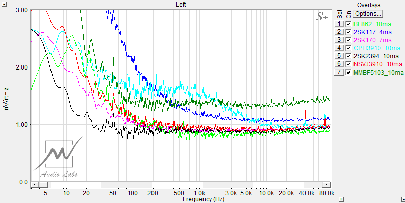

- Spectral noise density of lowest measured noise JFET’s -
Pay attention to the purple graph of 2SK170 compared to the red graph of the NSVJ3910, they are a match. The later is a Vds 25V part. The black graph of the 2SK2394 part is only Vds 15V. The 2SK209 should be very similar in terms of noise and are used and liked by many.
Part - Ciss - Crss - Gfss - $
170 - 20-30pF - 5-6pF - 10-20mS .... $10-12 part
209 - 13pF - 3pF - 4-15mS .... $0.40 or better
3910 - 6pF - 2.3pF - 30-40mS ... $0.50 part
Regarding Idss, the 3910 sits between 20-40mA and the Vgs(off) is -1.2-1.8V while the 209BL part Idss sits around 6-14mA and Vgs(off) is around -1.5V.
OBS: Both parts are SOT-23 only
