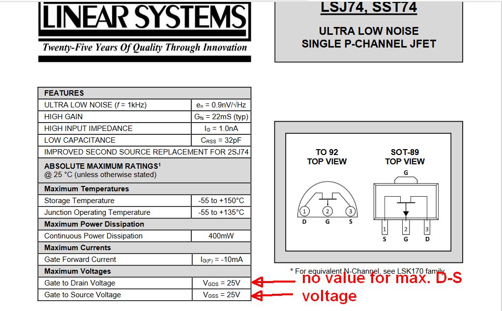

the datsheet from LinearSystems for the LSJ74 doesn't show a value for max. D-S-voltage. 😕

I run a quartett of LinearSystems LSK170 / LSJ74 complementary pairs in one
of my BA-3 poweramps (frontend) at a rail voltage of +- 34.5 volts (with a little extra heatsink - selfmde for TO-92) for 2 years now. With no problems. They run at a temperature around 35-40 C (temperature).
So they seem to be very robust / tough.

No value for max DS because usually G is lower than both (for a N-JFET).
So rated voltage of 25V also applies to D-S.

Yes, we are well advised to stay below the 24 V - rails - 'border'.

I ask as the original Toshiba 2SJ74 would break down a touch over 40V and I always assumed the datasheet had a typo given the matching 2SK170 was 40V rated.

Hi does anyone have any experience with the breakdown voltage of the linear systems LSJ74B.
Verified as 26V.
