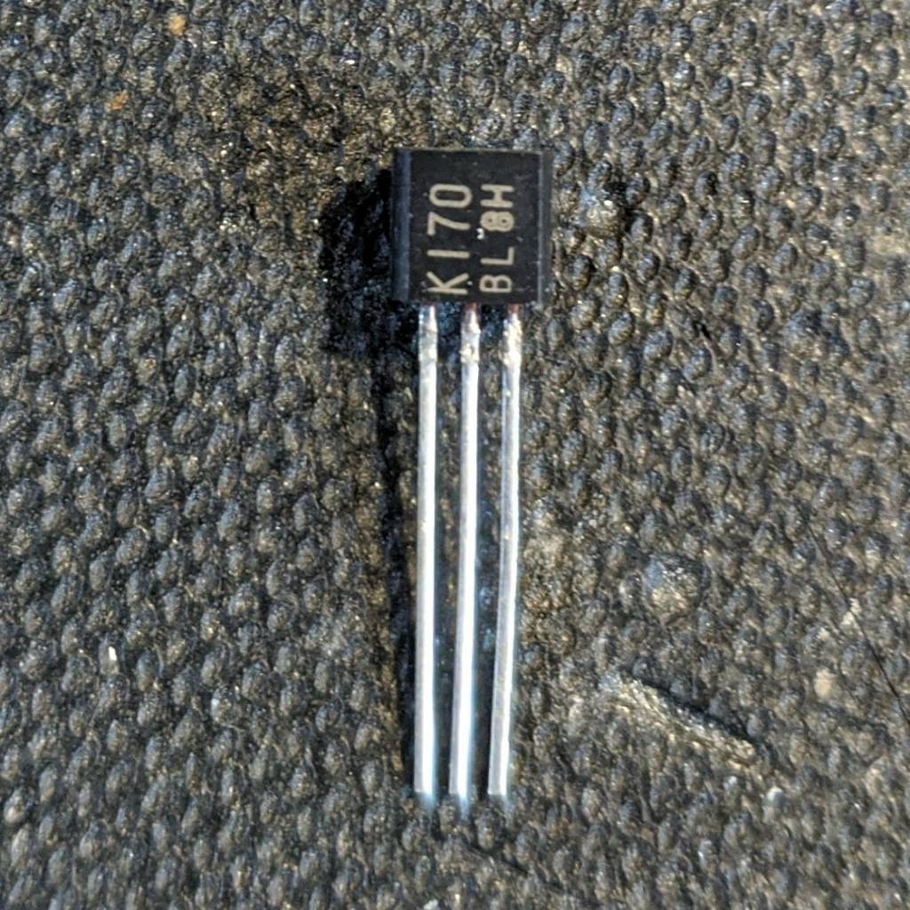

I've bought 8 pairs from Bdent: 2SK170BL+2SJ74BL
While they're not matched sets, i've read elsewhere that they're pretty close and genuine. Should I be concerned about the different ranking(?) number or batch # between each complementary part. The J74 are 8H & the K170 are 8G.
Of course one can plot curves for each JFet but then varying room temps or even blowing on them while doing measurements is a concern; and the testing won't be accurate.
Advise on the photos taken?
https://i.imgur.com/0m8707d.jpg
One thing others have not mentioned is the left over flux at the top of the leads (see in photo). Of the 3 legs you can see the brown flux which i'm not sure if the 'FAKE' ones would have the same assembly process? Just something to consider about when looking at fakes.
Back side has the round molding mark.
Top side molding mark. Also the line that others mentioned is the molding seam.

I consider Bdent a trusted supplier. I've ordered a lot from them and never gotten a counterfeit part.
The '8H' vs '8G' are just date codes. The 'BL' part is the grading.
I have ordered 50 of these Toshiba JFETs from this source and all were legit. Enjoy your purchase.

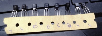

I found 8 NOS 2sk170GR on the shelf (bought in 2011 for 1 EUR from ELFA 😀) - I measured Idss with 9V PSU - 4 is in the range of 4-5.5 mA and 4 is in the range of 6 -6.5 mA. Can I use the last 4 to say B1 or ACA instead of BL or Idss is too low?
tnx
