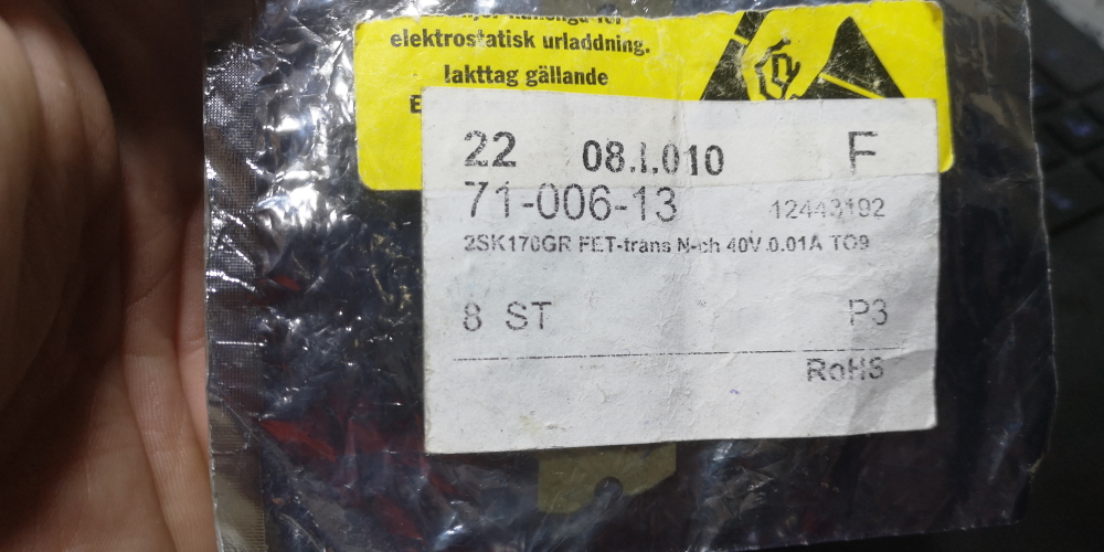

Yes authentic and price is good 😉
GR grade Idss ranging from 2.6-6.5 mA
if you need 2SJ74 BL grade Idss ranging 6~12 mA
then better find another jfet source shop ex: Toshiba 2SJ74 LAB MATCHED QUAD to 0.03mA / 4mV ("B" "BL" 9-10mA Range) | eBay
Can be DiyAudio shop for matched LSJ pairs or quads.

Looking at the font, you can see the K170 and batch code being in different size, which is good. The 1 is just a line, and the 7 has a curved, uh, stem? Not sure about the nomenclature. Either way, punkydawgs is legit.
