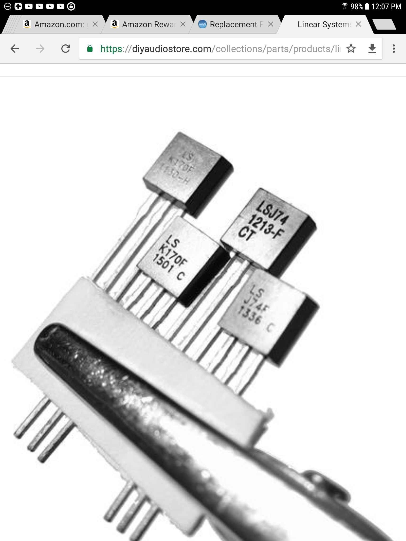

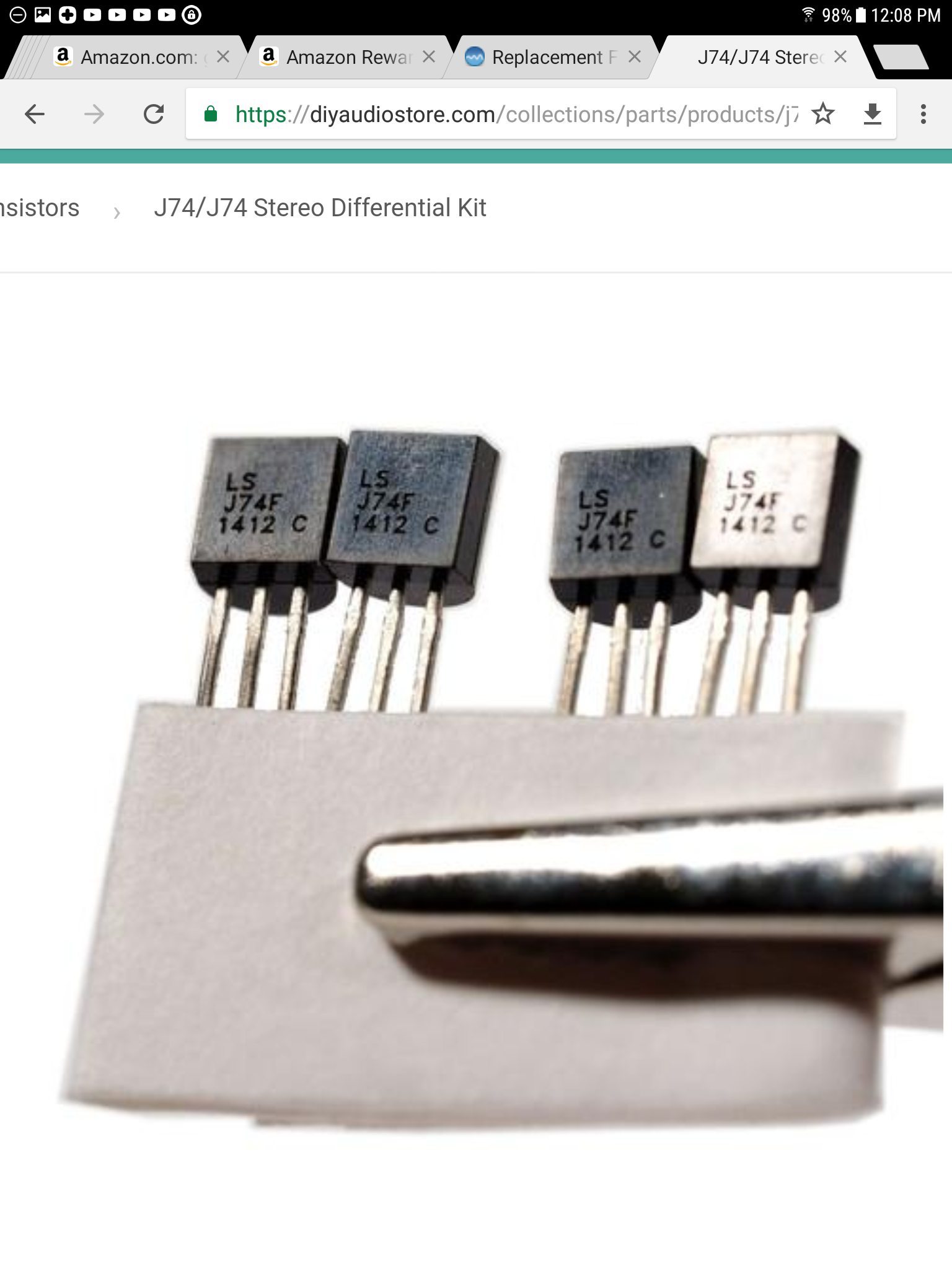

If number 7 is made with two straight lines, then is counterfeit.
Genuine Toshiba jfet's 7 number is curved at his base.
Best regards 🙂
Is that a definitive method of determination? I ask because I'm looking at photos from the diyaudio store, the 7s have straight lines and there's no way the store is stocking or selling fakes.

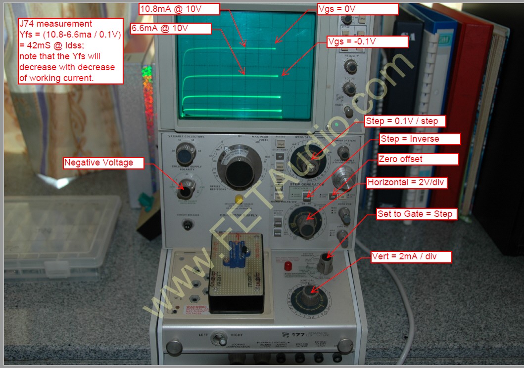

When Idss is measured at what Vds should that normally be done to get a "standardized" value for Idss? …..a Vds just before break down to get the max Ids?
Some use 9V.....but that is because they use a 9V battery for the measurement?
It's completely your choice, do it however you please.
Me, I like to get far away from the knee and the linear region. So I prefer to measure well above ~ 4 x |Vpinchoff| which ensures I'm well away from the knee.
For the 2SJ74 in Toshiba's datasheet, that's something well above ~ 3.6 volts. 9 volts is certainly well above 3.6 volts. Naturally, other designers may interpret the data differently, or arrive at a different final preference.
_
Ok....so 9V Vds could be a real operation condition in an amplifier.
Would the curves had looked "nicer" if there was same distance between them so a change in Vgs gave same change in Ids?
I am still at a "FET learning curve" 🙂
