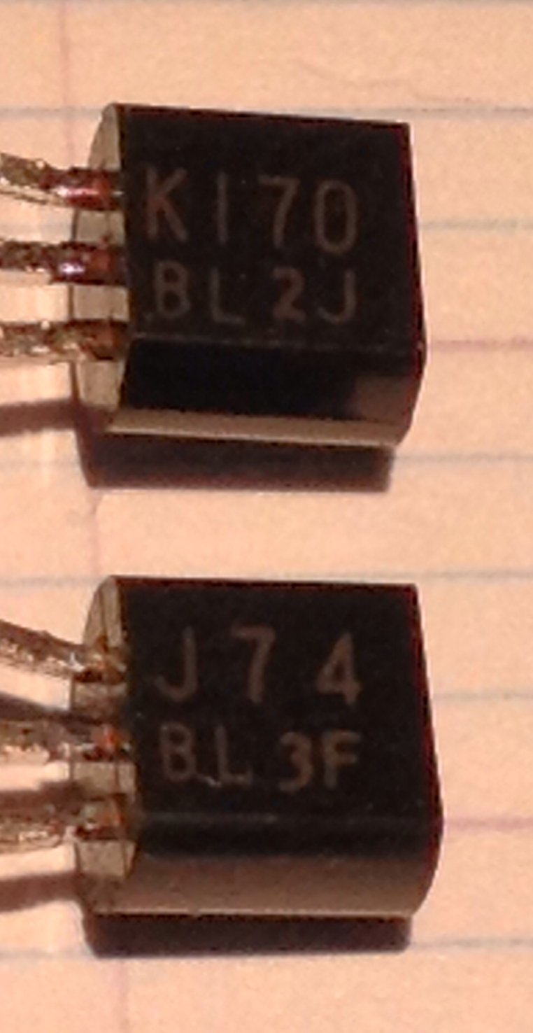

Thoughts? These are currently under diyaudio's swap meet
NOS Genuine Toshiba JFETs 2SJ74-BL/2SK170-BL Matched Pairs

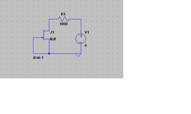

You're losing a lot of voltage across R1. Perhaps you can try something smaller
like 100 ohms or lower?

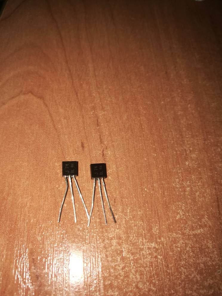

I found such a simple calculator rjm/1326-matching-jfets.html to measure jfets and measured my jfets according to it using a 9v battery. For 2sj74 I reversed the power connection. Here are the results:
2sk170bl:
Vgs0=0,48V (0,54V)
Idss=6,5mA (8,2mA)
Ids= 3mA
g_m at Ids = 18,2mS (18,6mS)
2sj74bl
Vgs0= 2,42V(2,47V)
Idss=10mA(10,1mA)
Ids = 3mA
g_m at Ids =4,5mS(4,5mS)
Thera are not matched but sj74 are genuine?

@ Darrr
Could You can post and show photos of 2SJ74 ?
Best regards 🙂
Vgs (off) is too high ?
Assuming the measurements and calculations are correct, the gm is far too
low for a 2sj74bl.
You can verify 2SJ74 dimensions of black plastic case.
Probably is smaller....if stuff from China

Ask the seller for refund , try get Your money back.
Try find matched pairs of genuine Toshiba's in swap meet section of the forum
