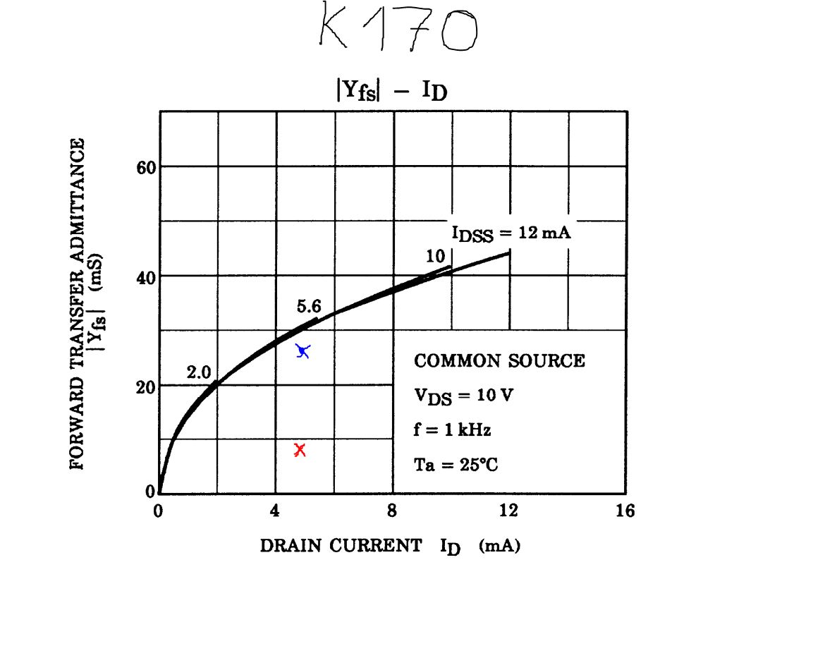

at post #122 I saw measurement of jfet quad by Woofertester and there is
not only unmatched Yfs of P and N type but very low and not typical Yfs.

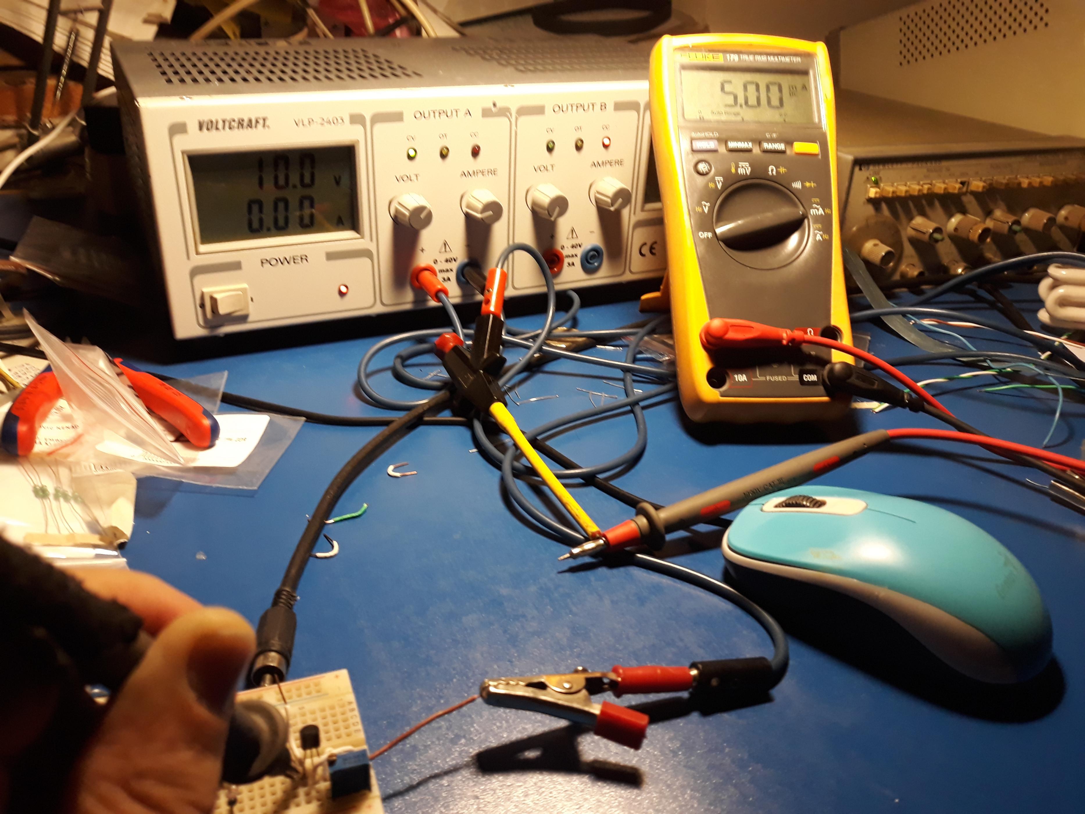

I tested one of my K170bl with exactly same Idss of 9.09mA like a woofertesters example and found:
Id=4.9mA Vgs=132.0mV
Id=5.0mA Vgs=127.9mV
Id=5.1mA Vgs=124.3mV
Same Idss jfets, my is around 25-27mS at 5mA and woofertesters is less then 10mS at 5mA. For better visibility I put red and blue marks to Yfs graph for K170.
Typical Toshiba have 22mS at 3mA.
Toshiba datasheet Yfs is done AC at 1kHz, my measurements is DC and is very near typical curve.
If its not measurements error I think something is wrong with those jfets.
