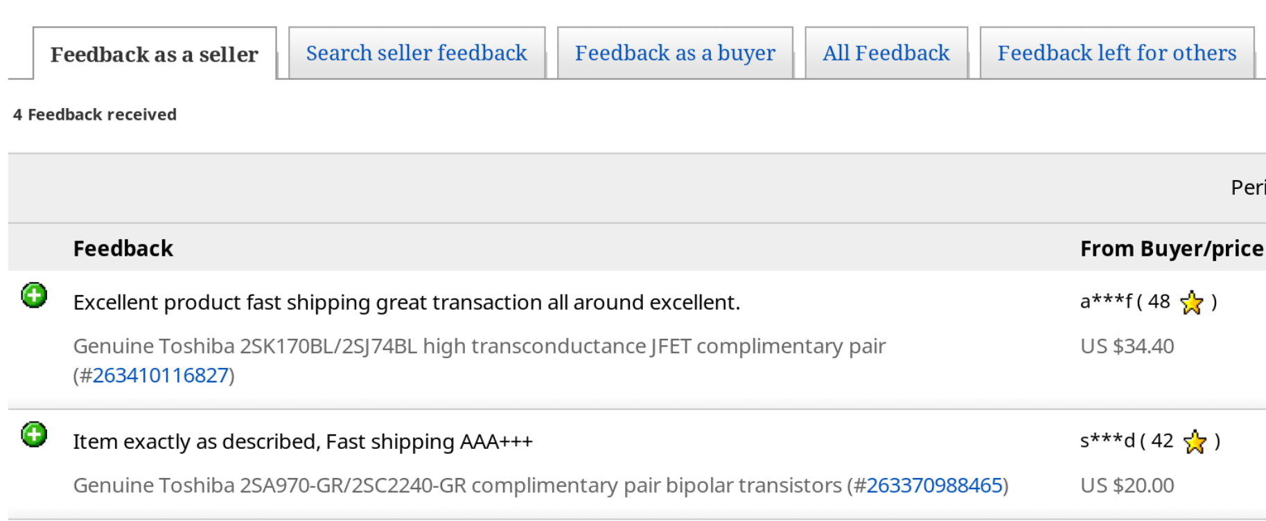

On ebay punkydawgs is a known reliable as they came from a local mfr
who bought lots of them.
Unfortunately he has raised his prices.
I bought more than one quad from him and they match for Idss and Vgs as he states. Recently I have added a gain test to my matching routine and his matches are not matched for gain. I will post results of one of his matched quads.
For what he is charging, it would be nice to have Idss, Vgs and gain matched.
If I had a vast pile to work with, I could perform all three tests in the same time as just idss and Vgs. I use the same kind of gear that is used to test devices on wafers before they are sawed into individual devices.
Here is a Punkydawgs quad that I purchased recently. There are 4 transistors worth of characterizations with the P-channel parts first and the N-channel parts last.
You can see that the P-channel parts have twice the gain of the N-channel parts. This may explain some of the gain assymetry in my F4 Beast build.
