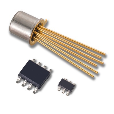

I dream Linear Systems jfet's are available at Mouser , DigiKey , RS etc.
http://www.linearsystems.com/lsdata/datasheets/201175 - LSJ74 Rev A6 dated 2017 10 06.pdf
http://www.linearsystems.com/lsdata/datasheets/201110 -LSK170 Rev A17 dated 2017 08 28.pdf
and indeed his duals version. Metal can package are handy 🙂
Dream that they will be available from main suppliers, AND that they will be as good as the Toshiba's🙂

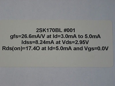

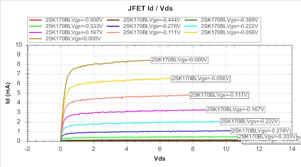

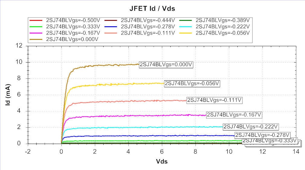

If interesting jfet's remplacement is hard to find
new vendors is available on line with semi's resonable price
Genuine Toshiba 2SK170BL/2SJ74BL high transconductance JFET complimentary pair | eBay
Have fun 😉

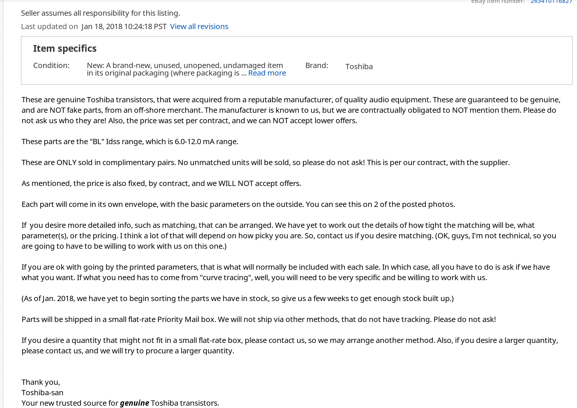

Have fun 😉

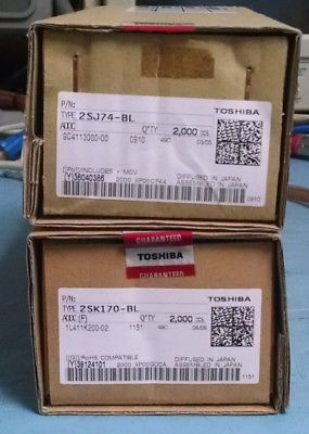

They say on ebay they cant reveal the manufacturer then there is Toshiba on the box !
Expensive and you still just have their word they are genuine.

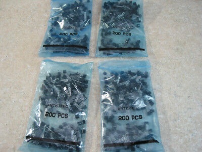

"As of Jan. 2018, we have yet to begin sorting the parts we have in stock, so give us a few weeks to get enough stock built up."
So they start selling before they have measured all there 4k stock.
You can guess how well the match could be from a smaller pool.
And as we have mentioned before, claiming sub 1% match has no meaning if you do not apply temperature control.
Just try gently breathing on a JFET running at Idss, and see how much the current changes.
Vendor jfet's Toshiba stock source was HI-FI audio manufacturer 🙂

Please Patrick send to jfet's vendor message with proper match DUT circuit and procedure with all important parameters 😀

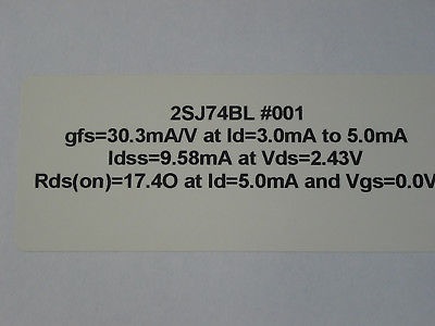

Ebay vendor show his jfets are curve traced 🙂
Why should I ?
Because You are constructive perfectionist personnality 😉
