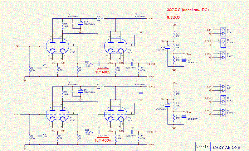

I don't really like that Cary AE1 schematic. 6SN7 with 100k load resistor? Anyway, that Cary AE1 can't work as headphone amp. 6SN7 cathode follower, albeit in parallel, won't properly drive the 50 ohm impedance of HD555.

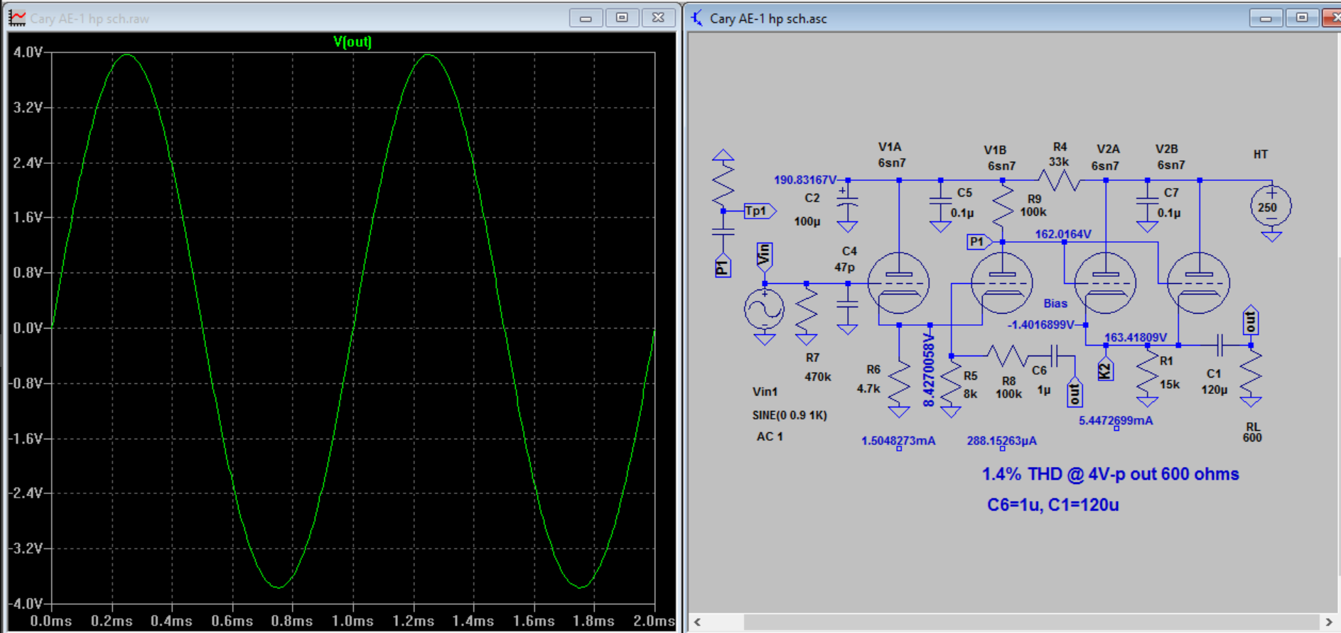

I see 3 simulation diagrams of Mr. Koon which consort to Mr. Ballpencil advice.
I have better idea. Due to I plan to build CARY AE-1 Preamp. My headphones are Sennheiser HD555, Momentum over ears, JVC HA-S500, Audio Technica ATH-M50S.
I think these headphones not hard to drive. I plan to do CARY AE-1 as both Pre amp and having headphone out. Can I?
Therefore my E100 Headphone (E88CC 6SA7) is no need to modified because I will focus to build CARY AE-1 to get better sonic instead)
Where to tab the Left and Right signal of the headphone?
Please see schematic diagram.
I am not sure that I am on the right solution to use Cary AE-1 as both preamp and headphone amp?

oh I see, that is ok, you can measure again. You can use the simulation software LTSpice from Linear Technology, it is free, together you'll need to download tube model from this diyaudio site. I think LTSpice is very good for most beginner, very easy to drawn schematic diagram, some use the information for presentation directly. It can also export netlist to some common PCB software includes ExpressPCB. So you can get started. Please don't hesitate to ask if any question.
my english is poor sorry I mean which simulations you draw 1 2 3
Which one is best

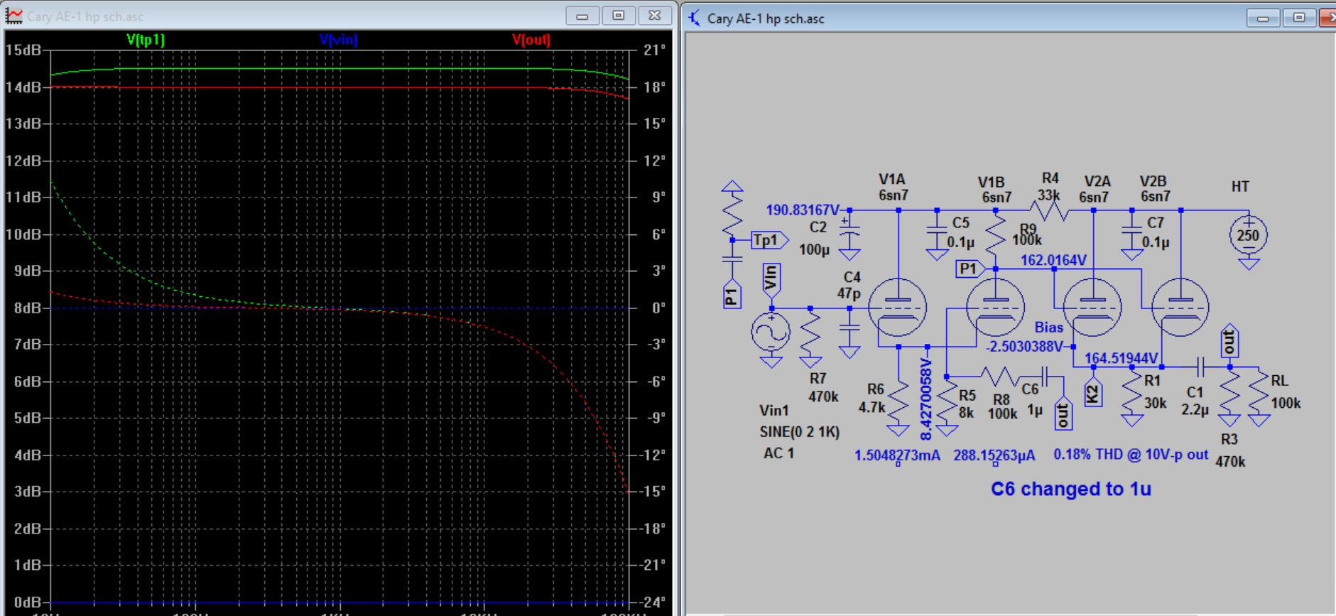

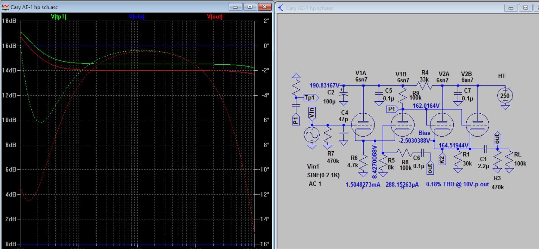

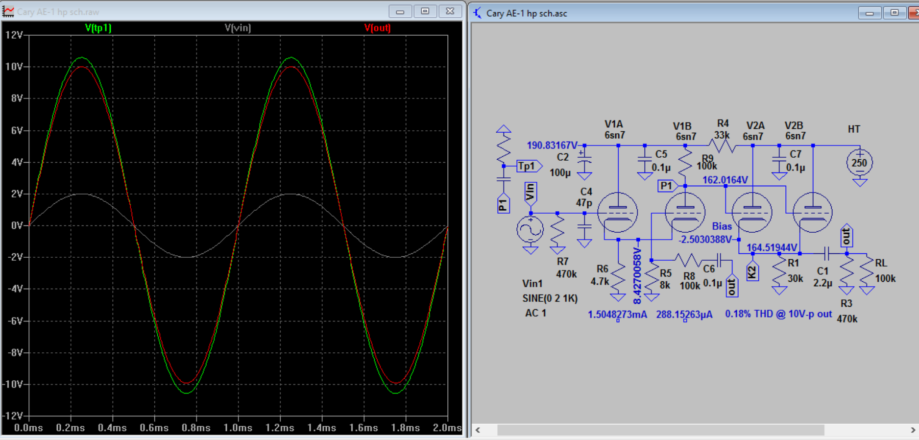

No problem, 2 is the best, least distortion. Sonic wise you have to hear it.
I just finished sim Cary AE-1. It can be used as preamp with input impedance as low as 1k. It barely will drive 600 ohms hp, and will not drive your 32 ohms E100. So you should be looking for another hp amp that can drive 32 ohms hp.

baryly will drive 600 ohms HP = Cary AE-1 can't drive 600 ohms HP and also 32 Ohms HP.
Am I right?
I will use CARY AE-1 as preamp only and enjoy 6SN7 tube rolling with my ROTEL RB-981 & Dual AK4399 DAC.
Right, can not. Enjoy the music.

Can you just post picture of the simulation of Cary AE-1?
Thank you.

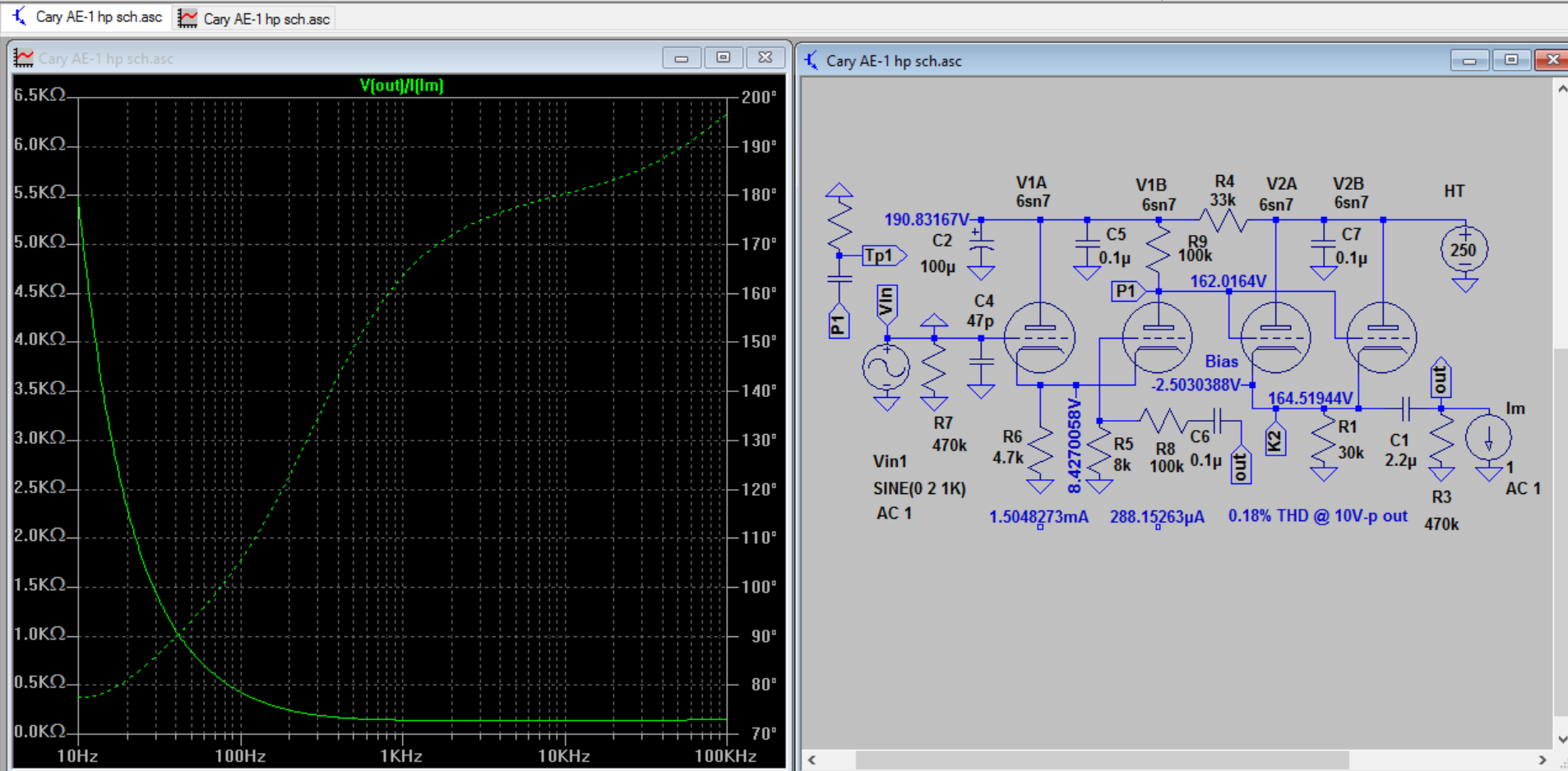

No problem, see attached. As to your question for best load, with output cap fixed @ 2.2u, the maximum load is 47K, anything more than this 47k-1Meg is ok. However if the load is 10k, such as input of solid state amp, the output cap needs to be 10u or more. Also the cap in the feedback is only 0.1u, and this resulted in very deep "virtual" bass due to large phase shift, normally it should be 1u for flat response. The output impedance drops from 150 ohms @ 150hz to 5k @ 20hz.

From simulation picture that you advice to change 0.1uF400V to 1uF 400, What is the purpose of replace to that value? Better sound?
I decide to keep E100 HP amp as HP amp and build AE-1 to work as Preamp only (no HP out)

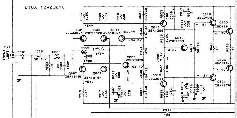

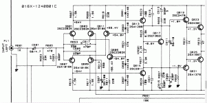

I will try to connect this preamp to Solid State Power amp I have Rotel RB-981. I don't know input impedance of RB-981. So I attach schematic of it.
So I will do only change 0.1uF caps to 1uF 400V as attached picture.
Am I correct?

Yes you can change 0.1u to 1uf if you prefer real tighter bass over "virtual" bass, it will be quite obvious if you drive a heavy load such as 600 ohms.
