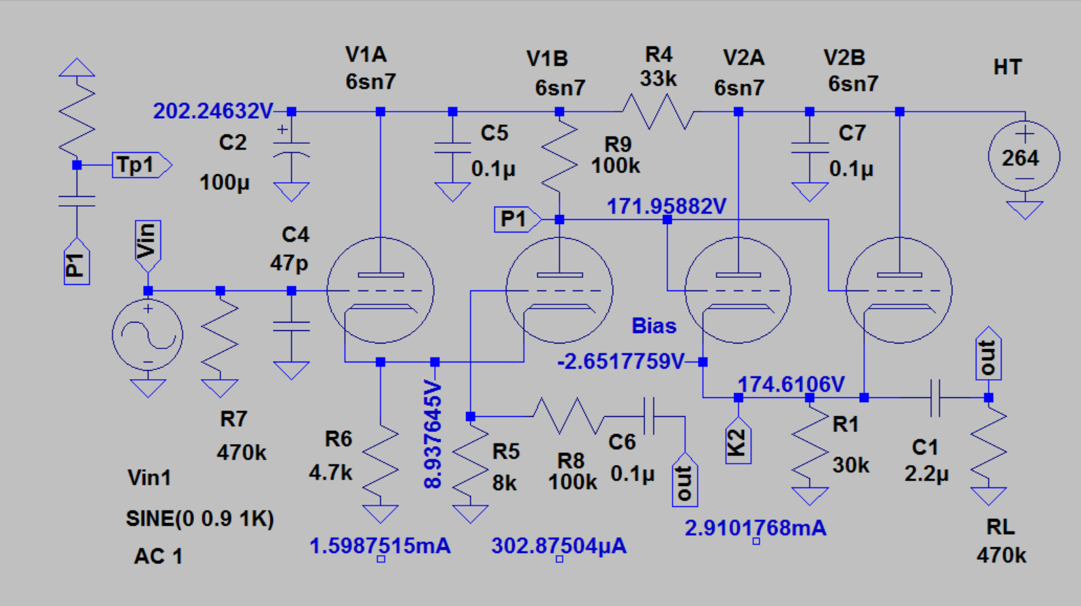

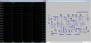

"I will try to connect this preamp to Solid State Power amp I have Rotel RB-981. I don't know input impedance of RB-981. So I attach schematic of it."
There is a 33k from input to ground so at least <33k, normally solid state has standard 10k input impedance, so you also have to increase output cap C1 to 10u for best sound.

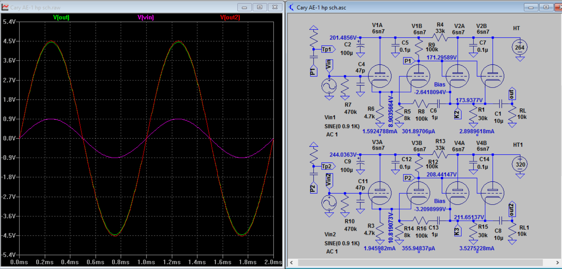

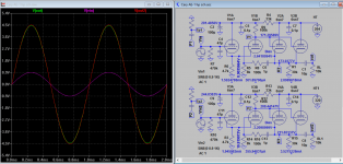

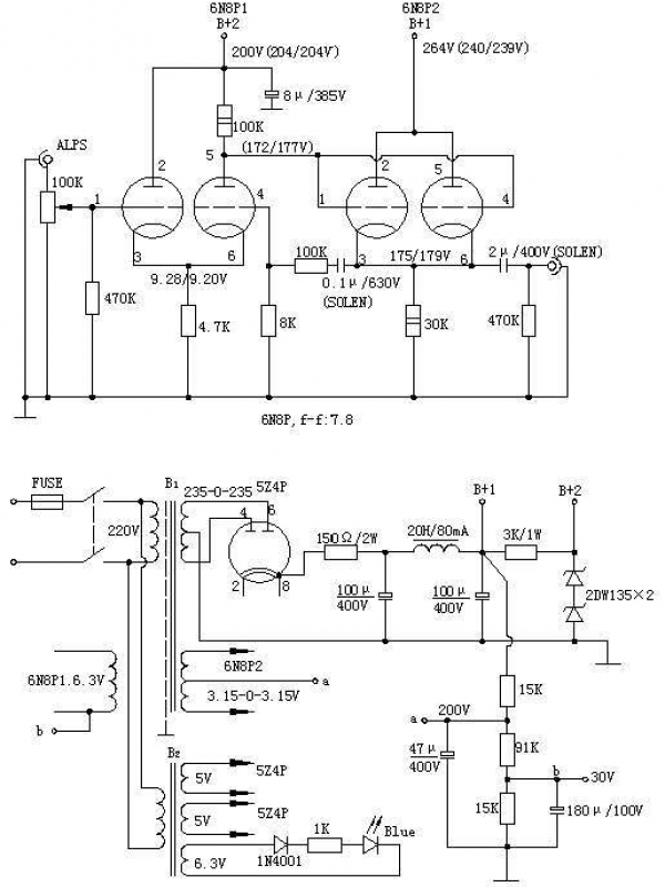

There is a complete sch of AE-1 here, HT is regulated, about 265V, you compare the sim with actual measurement. 6N8 is equivalence for 6SN7.
C1 to 10uF 400V? wow I don't know how big is it? The K75-10 2.2uF 400V size is 10 centimeters. If 10uF 400V, I have to purchase other brand. Can you recommend other brand of 10uF 400V or I just need 10 uf 250V for smaller size?

Can you show me simulation of 1uf and 10uf please?
See attached. There is little difference when the HT is increased by 50V or so. The distortion (0.82%/0.79%) has dropped a bit, and there are plenty of headroom.
"Can C1 & C5 be 250V rate? to get smaller size?"
DC now on the caps is at least 212V, so 250V is minimum, 400V is recommended. If you wire feedback cap 1u to output after output cap 10u, there is no more DC, so 1u can be as low as 50V. For 10u/400V, you can try high quality electrolytic cap which is smaller.

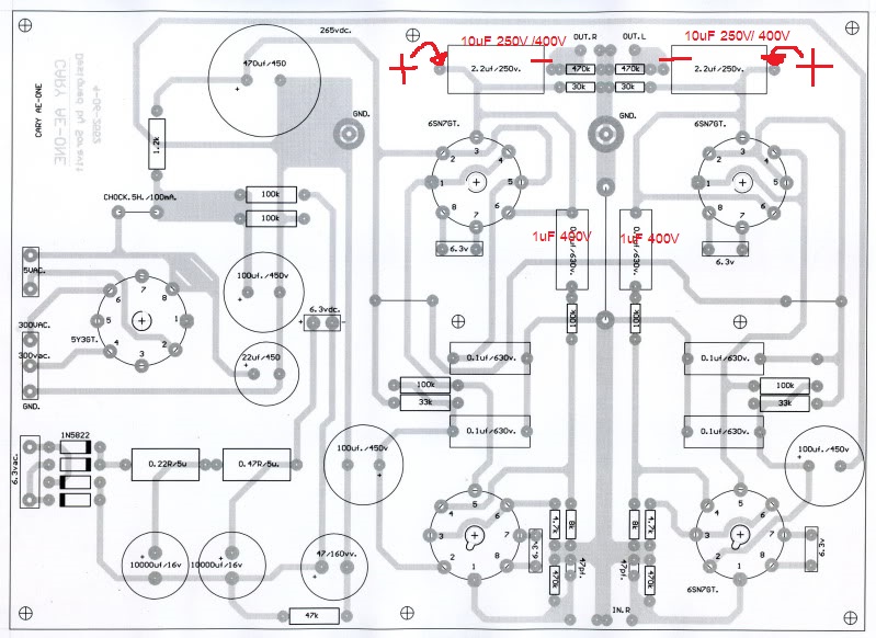

Hi Mr. Koonw,
- Electrolytic might sound not as good as MKT or PIO (paper in oil).
- For PIO 10uF 400V will be too expensive and very big. I decide to use Vishay MKT 1813 10uF 250V. I think 250V can handle 212VDC in circuit.
- For 1uF 400V, I can find good PIO such as K75-10.

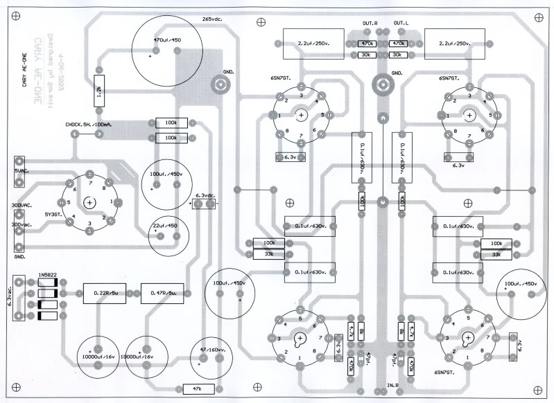

- Most Electrolytic @400V rate are polarity capacitors (+,-). How to know the direction of + and - in circuit. I attach picture on PCB whether it is correct direction.
Thank you.
Hi Mr. Koonw,
Thank you.
That is correct.

For 10uF 400V, I have a lot of good electrolytic 33uF 400V.
Can I replace 33uF 400V instead of 10uF 400V?
Is it still provide flat response with no phase shift?
Can you give me picture of frequency response and phase of 33uF 400V?

Yes you can.
