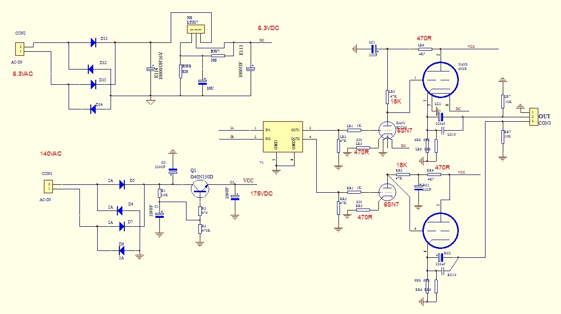

Replace 6SN7 to E88CC on HP amp 90VDC plate capable?
