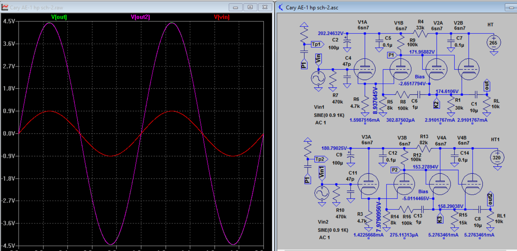

Well I still think you can lower the DC in the output so that you can use rating of 200-250V which is maybe easier to get. See R13 and R15 on bottom sch. Maybe your PCB is not exactly the same as this sch.

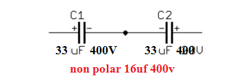

I got better idea to connect 2 33uF 400V polarised So I will get Nonpolalised of 16.5uF 400V
33uf 400V 33uf 400V
16.5uF 400V (non Polarised)
Frequency response will be better than 33uF 400V alone.

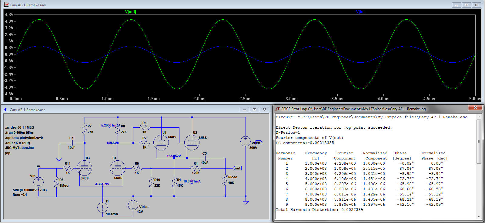

Had some time to kill at work so i played with LTSpice and made (what i believe is) an improvement over that Cary AE-1. It follows the basic topology but some changes are made to overcome the flaw i found. Unfortunately, i just realized that supernut already has the PCB for this and the changes i made maybe quite difficult to implement. Anyway, my feet are already wet it so here it is..
Some improvements:
- Added missing grid stoppers
- U4 no longer flows the trickly 300 microamps (!) of plate current. It's now increased to 5.2mA. This will help to drive the parallel cathode follower input capacitance
- U3 shares the same Vak as U4 and flows equal plate current
- The parallel cathode follower now flows 10mA of current, instead of the original minuscule 3mA: better drive of long interconnect cables and stray capacitances -- improved high frequency
- CCS instead of shared cathode resistor for the input stage. This alone improves THD by an order of magnitude. It's now 0.0027% with 2Vpp on input. I don't think THD this low will get you that tube sound, though. Might as well use an op-amp 😀

Can I just cut the PCB Line by using cutter and hard wire new Resistors & Capacitors on the old PCB?
Sure, why not. That's how i would do it. Just make sure the grid stoppers are as close to the pins as possible. Soldering them directly to the pins is a good idea. I don't have actual PCB size.
The red box you asked on post #66 is called constant current source (CCS). I won't explain about it as google is just a click away but basically it forces the total sum of current that flows through U3 and U4 to be constant. You can make CCS using LM317 voltage regulator IC. See here LM317 / LM338 / LM350 Current Regulator Calculator and Circuits
LM317 needs at least 4V between the Vin and Adj pin. The -12V Vbias will provide you with this requirement. The cathodes of U3 and U4 are already at 4.36V so it maybe tempting to connect the LM317 straight to ground without Vbias but input signal will reduce this 4.36V and it will stop the LM317 to work properly.
I put -12V Vbias as i thought about using the same power supply to power the heaters for the 6SN7 (put the heaters in series). It doesn't really have to be -12V. It can be as low as -3V which can be provided by two simple AA battery. Why? Because 4.36+3V = 7.36V. This is high enough to keep the LM317 CCS working even with some input signal.
I forgot to draw it but there should be a diode between U4 plate and U1+U2 cathodes. Diode anode goes to U4 plate. This is a safety diode that prevents your grid from damage during first starts. It can be the ubiquitous 1N4148.

I may have overlooked something but i see that there are only two advantages for this input stage topology (compared to the usual grounded cathode + cathode follower):
1. Low input capacitance (as we first see a cathode follower)
2. No phase inversion (which is, i admit, quite trivial but some do make it a big deal)
I tried to "improve" the AE-1 without removing these two advantages. Yes, it may have different sonic signature. supernut may or may not like it.. Something as low as 0.0027% THD in simulation may very well be an argument to just use an opamp.
If it were me, with 4 6SN7 i would just go with Aikido (yeah sounding like a broken record here) OR just skip an active preamp entirely as supernut already has the E100 hp amp if he ever needs line level amplification. Passive attenuator + channel selector is something i prefer more in his situation but he may just have the "itch" to build a tube preamp 😀
