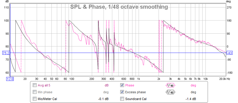

As a side note, are you sure you need that much phase correction down low?
Measurements are often doubtful and almost meaningless at these frequencies, especially in domestic environment, so it is often better to stick with theoretical corrections at these frequencies (BR, etc.), or live them alone altogether.
Also, regarding in band phase correction, have you tried using some minimum-phase EQ to linearize the amplitude, and see the effect on phase?
I plan on adding an "excess phase" visualization in a future version, and use that as the preferred phase EQ target...

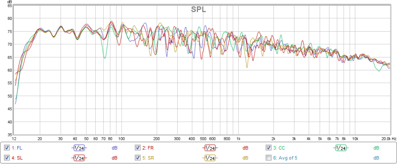

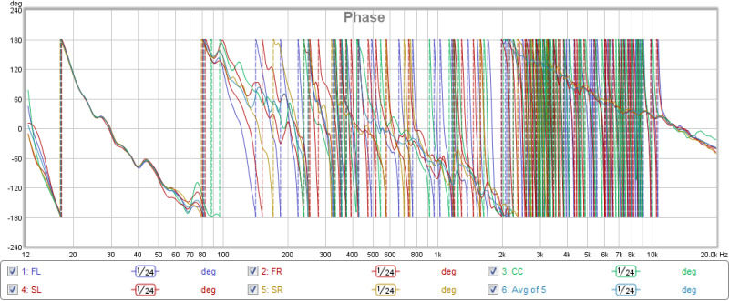

I am reasonably confident my LF phase rise is accurate for my setup. It includes the phase correction for all my measurement chain devices; Audio Interface, AV Pre/Pro, DCX2496, P-Amp, and mic preamp. So the measurements should be representative of the true speaker response. I have a B-24 HP filter at 20Hz set in the DCX so that adds to the ported SWs. My measurements are set to start at 12Hz so I don’t pay much attention below that.
In my case the It would seem more convenient if RePhase just allowed stacking random filter orders at various freq to best match the phase rollup. The choices offered are not very easy to fit to my real world situation as you saw. I defer to you and others needs however as you are probably the more representative of common usage.
Regardless of my choice of house curve would I not want the direct sound phase to be linear at my LP? My logic has been that Irrespective of my choice of SPL it is still correct to have all freqs arrive at the same time. I suppose if my tapered house curve causes REW/Holm to report phase rotation that is in fact not there then this may be the wrong approach? I am not really sure of my logic on this point.
The SPL of my 5 identical speakers are EQed in the DCX with mic at the ~4m LP. EQ is done as well as I believe is appropriate given the DCX capabilities. The phase appears to appropriately follow the SPL when considering the disruptive impact of modes and reflections. I average these 5 speakers to better see the trend of the phase. I just ignore all the various midrange phase ripples. I sometimes confirm that all is well by turning off the SWs and measuring one main at 1m or so with the rePhase filter applied. I normally get a very smooth SPL and pretty linear phase from 80-20k when I do this.
Are you saying there is a better way to deal with this? I may well be missing some opportunities with my process so any comments you have would be appreciated. Below are some charts just to show what I am looking at prior to creating the phase correction filter that I use in FooBar.

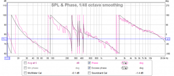

Pos, I understand now your comment regarding too much of the LF phase correction. The sample I posted had an extra phase rotation below 20Hz. I must have gotten confused in the rush to post an example. I don't normally make that mistake. Sorry for the confusion! 😕
I worked up something in Excel, but I am not super confident I got it right! (zip attached)
Reload the same file in a working zip this time.
I attempted to work the math back from a paper. I may be close .. I may be way off. Please don't use this to design a filter until someone with experience chimes in!

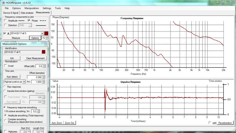

I have just read the entire 600+ posts in this thread. This calls for a few tips of mine regarding issues raised.
Measurement of delay between loudspeaker units in active systems is very easy using Holm. Just send the frequency sweep in parallel to two amplifiers and measure in listening position. The impulse screen in Holm will show two peaks, and time delay between peaks can be read on the horizontal axis after setting it to show to time instead of samples which is default. This is the delay to implement in JRiver or VSTconvolver.

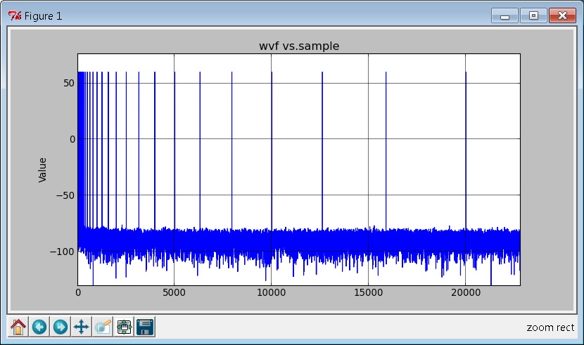

Regarding the noise, I have no idea where it can come from.
Try loading the impulse in audacity or holm and look for any weird thing...?
Jriver most probably implements its convolution in the frequency domain, which can also imply all sorts of warts when not done properly, although I am sure their implementation is just fine...
Maybe try a direct time domain convolution engine just to make sure?

Here's a plot I just did (Pano this is the FIR file I sent you) of 30 - 1/3 octave spaced tones that were inverse RIAA equalized and FIR filtered with Sox's fir command. The FIR was ~6000 points 32 bit floats normalized to 1. The results if blown up were +-.0005dB. I was a little sloppy in trimming the impulse response it might only take 4000 or so points to get < 1/2 lsb at 24bits.
EDIT - that's dB on the left axis, no spurs just the dither noise at ~-140dB also PYTHON has an arbitrary n FFT so no windowing is required, integer frequencies are automatically in exact bins at 96000 sample rate.
