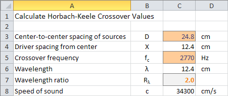

Hi pos,
one thing that would help in generation of Horbach-Keele crossovers would be something to assist in calculation of the ratio parameter. I worked up something in Excel, but I am not super confident I got it right! (Pic and zip attached)
-m

I am glad someone is actually using the Horbach-Keele feature 😀
Adding the calculation directly in the main interface would be difficult, but I planned to add a "tools" menu entry with useful tools (left/right IR merging in a stereo file, offline batch convolution, passive filter calculation, unit conversions, etc.), and such a tool would certainly qualify.
Your zip looks empty tho
