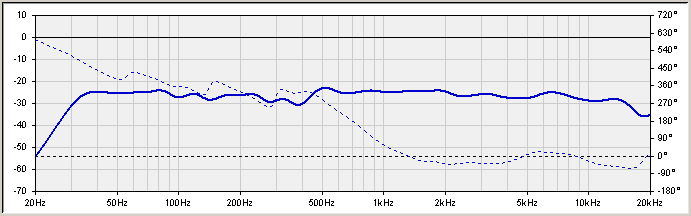

A Question About Phase
I may have asked this before, but can't find it.
When I export the FR as text from HOLM and unwrap the phase, it is usually off by 720 to 1440 degs or more in rePhase. Why?
I've used different methods of setting the impulse in HOLM, but none help. Using the delay in rePhase just twists the high frequency phase.
There most be something I'm doing wrong in HOLM or the export, but I can't figure out what. Any ideas?

Hi Tom. I missed you at Infocomm this year. Every time I went to either the booth or the showroom, you had "just left". 🙁 Oh well. There were some amazing NXT type speakers I wanted you to hear.
Back to rePhase.

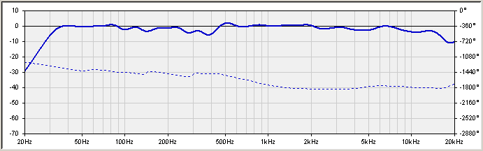

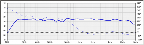

I looked at the exported FR and phase text files from HOLM. It seems to start phase 0 at 0 Hz and drop from there. I can import that into Excel and correct it, but have not found a way in HOLMImpluse to set 0 degs to any certain point, E.G. 1Khz.
I will post a plot.
Here is an example plot. You can see the huge phase shift. It goes form approximately -1200 to -1800 degs. That's what's in the exported text file.
Pulling 1200 to 1500 degrees out of the text file at least makes the phase line cross zero, which is handy.
Guess I need to poke around in HOLM to see if that can be corrected during export.

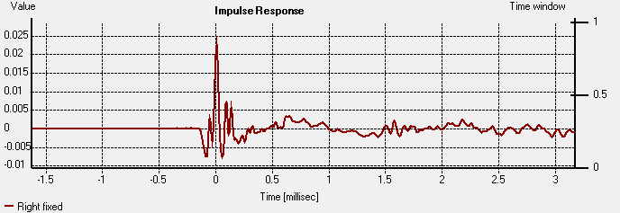

Hi Pano
That is odd. Is this without any DSP?
The curve (the phase shift between 400 and 1600Hz) suggests a 4th order crossover however the overall phase offset is puzzling.
As jmbee suggests, if you can, post the impulse with the T=0 shown.
If you can “fake” the curve up so that say 400Hz is around zero, you should be able to fix the rest in Re-phase. If you can make the phase flat around zero all the way up, it will be acting like a single point in time.

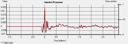

I don't understand why you measure the impulse before to start?
I don't understand what you mean. The peak is at zero.

There is some mild room EQ and active crossover. No other DSP. This is at the listening chair, about 14ft from the speaker.
Correct. Between woofer and horn there is a 4th order crossover circa 750Hz. Tweeter comes in about 7500Hz
I just did find that if you limit the frequency range of the HOLM export, there is less phase shift. E.G., starting the export at 20 Hz gives a maximum shift of about 720 degs. This seems to be a HOLM quirk.
See post above.
