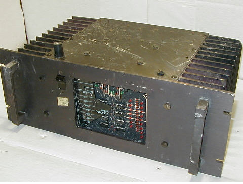

Restored 400A
Here's a before picture of a 400a I got from an eBayer who pulled it from a metal recycling bin a couple of years ago.
I'll post the restored unit in a minute.

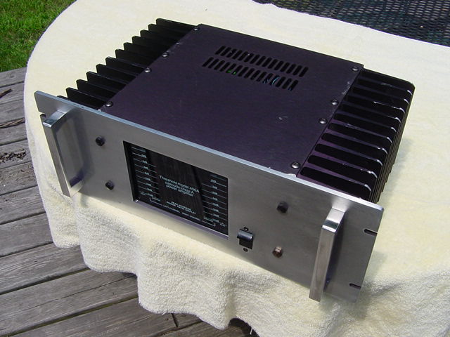

You can either use permanent black marker or hit the heatsinks with flat paint on top and that'd clean up the edges...
Where did you find the replacement window?
Again, beautiful job!

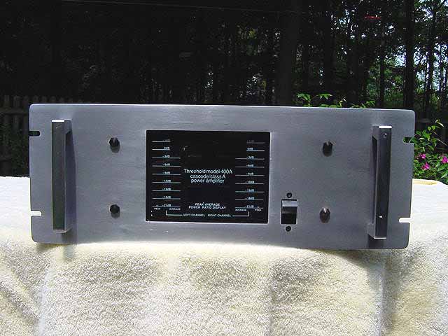

THRESHOLD 400A
Thanks.
I built up some pretty good muscles refinishing the front plate.
Another member clued me in about the magic marker trick - the picture I posted was before I retouched the heatsinks.
I found the plexiglas window at a dealer in Texas who said
that was the last one they had and they were just about to throw it out!!!!

Hi Terry, your project is old news.. I've read your thread a bunch of times.. 🙂 You did a great job.. I only wish I got mine as cheap as you got yours! Im on a fine line budget and have to make sure I dont make a mistake.. its not the money so much as the principle.. Just like to prove to myself I can do it without it costing more than its worth as some of told me will happen..
You did a great job.. did you use wet sand paper or something on the front? I missed the details of that part some where.... Mine really needs the exact same treatment as yours...
Like the band "The Tubes" song.. "She's a beauty!".
