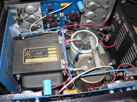

I just recieved a used broken unit I bought on ebay. The repair quote was $900. I foudn the quote inside; it reads:
24 Outputs $480 (is this a joke? they are like $2.00 each!)
4 Diff Ic's $80
8 drivers $50
10 resistors $10
10 caps $5.50
Labor $300
My question: If I replace all this would the only adjustment be bias? Can I do this?

I can install parts.. but as for matching.. no way.. I have no scope for starters.. Maybe I should just solder all the wires back on that the repair guy left undone and bring it in.. just so the guy isnt pissed that someone left it in a mess. I cant imagine it would cost more than $400 to fix.. this guy was a real jerk for wanting $480 for all 24 power transistors.. no to mention how likely is it both sides got taken out???
One side got so hot it burned all the anodization off the the heat sink!!!! One fuse assembly has a huge resitor burned off of it!
My unit has internal fuses as well as external.. this one I do not think has them.. hmmmm

It appears from the picture that the unit has been serviced at least once before. Note that the two main power supply caps are different colors.
As for the heatsink and anodizing, bear in mind that long term exposure to sunlight will do a number on black anodizing. It fades over time.
