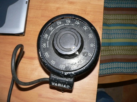

Regarding your smoke test, you might consider putting a light bulb in series with the power cord. This will keep most of the magic smoke in if something else is bad on the other channel. This would be wise to do at least for the first attempt. It will still allow you to measure for DC at the output but not have the unit at full power.
The other option would be a variac.

Actually; I own a very nice variac.. heheheh I KNEW it would come in handy one day! I'll connect it up and bring it up slow.. 🙂

Meanwhile I suggest that you buy a Variac (not the moderator)
for cheap (try Marlin P Jones) as you will find it very useful now
and in the future, and prepare to run some tests on the good
channel using a multimeter (Radio Shack).
