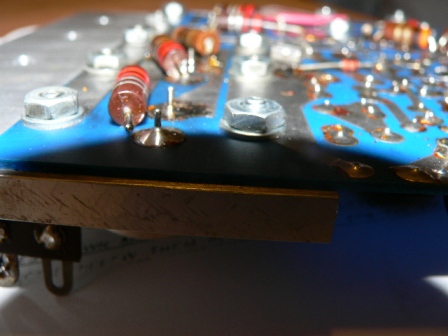

NEWFLASH! Is this what caused the whole darn problem? I just noticed this on the good side..
I am guessing it was never soldered on during the last repair...

Here are some more pics...
This is the BBCode for your photo for message boards and communities.
You can barely see the shrink tubed grey wire here on the right side (from the front)
Not burned as bad as the right side...
Also; that bug looks suspicious.. looks like it might be a terrorist.

Also; the burned resistor.. shall I remove it? I think it read about 10 ohms?? I mean before I test that side (I resoldered that resistor to the power transistor that was loose)...
I have gotten one thing done.. dusted the entire inside with a paint brush and vacum. I feel much better now.. oh and the bug carcass is history.. I think he did it.
Also; I would like to point out that I do NOT see evidence that that solder joint got hot and it just pulled away.. it looked very clean.. the photo is pretty accurate.

I would guess those .68 emitter resistors were 1 watt units.
I'd replace with 2 or 3 watts whichever is available.
