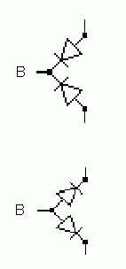

barchetta said:I will pull a good one tonight and tell you what my test looks like.. that should make you feel much better.. but I am just going by what I have been told to test.. and thats to do a simply test across the e and B to see if it looks like a simple diode.. and most look like air to me like I said one or two were DEAD shorts.. ALL of them (B,E,C).
On good devices, the BE and CE look like diodes. On bad devices
the CE is usually a short.
Don't obsess over batches and stressed transistors - let's
just get this thing running, and if you have problems in the
future you will be able to tackle them with your newfound
skills and confidence.
I think I've got some of the 5876 and 5878's in a bag, and
I'll send you enough to replace the known bad devices.

In regard to testing transistors for those that have very limited knowledge and very limited equipment available.. (sound like anyone??).. here is some data:
When testing the 2n5876/8 transistors it was suggested to run resistance (Ohms) tests across the Emitter Base and Collector.. and that there should be a little diode network from the collector to base and base to emitter. While this is of course true a simple Ohm meter does not always work (I suppose it does sometimes depending on the meter used and the actual component.) To illustrate:
Here is the base to emitter with an Ohm meter: note it read infinite (open)..
Now; MY multimeter has a diode tester on it thank goodness.. when I switch to it sometimes I get a little shock from the test leads.. so I assume the output is higher from the poor little 9volt transistor battery inside.. now here is what that test looks like in both directions:
Note: same polarity but test indicates a diode will allow current in this direction..
Now the other way..
This one shows "open" in not so knowledgeable terminology..
Edit: I decided to shoot and post one more in the interest of clarity.. this is what the meter looks like in diode test mode with an open circuit..
Same with the collector test (which is the mount itself of course..).. from the base..
So this one is good.. a bad one shows (on my tester) current in both directions.. I did not see one open in both directions with the diode tester.. not to say that could not happen cuz I am sure it could given enough current..
