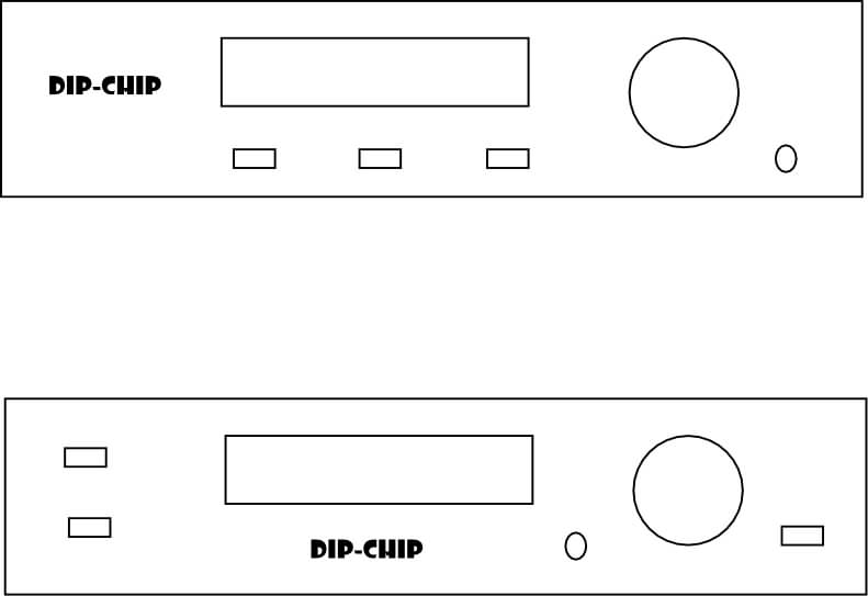

Dale, we are getting closer and closer to a final design, thanks for doing the hard work and listeing to your demaning customers.

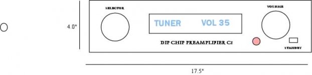

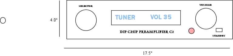

Now it would be the right time to put some dimensions down how big is the LCD? I think the knob could be anywhere from 1 to 1.5 inches. I would still claim the usefulness and looks of having an on/stdby button on the front.
Hi Grataku,
Would you mind if the second encoder switch (input selection on left) was the power standby?
The LCD is an Optrex DMC-20261
116mm x 37mm (4.5"x1.5")
Yeah, I like it!
Only thing i'm a bit worried about is the on/st.by on the encoder.
Would rather have it as an optional separate?
And maybe mute/dim as push-on-volume?
And mode-select on push-on-selector?

Dale,
You almost gave me a heart attack!
The IR sensor cound be hidden in the display window. This should allow for a cleaner look.
Jam
Jam
remote the IR
Um,
Perhaps the IR sensor could be remote located and connected to the rear of the chassis to allow for optimum placement.
Um,

The IR sensor will be placed on the board so one could mount it and have it viewable (to an IR) from the front panel.
Basically, the board will have non UI components all located on what you would call the top of the board. The UI components will be mounted on the back of the board. You will have the option of remote wiring anything or everything. You could mount the board on the bottom and not on the front if you so choose. In order to make this project do-able for average builders, we will provide a basic layout that meets most people's needs/desires. One can choose to modify as one sees fit.

Jam,
I just looked on my cheapo receiver in my office. I see the IR right beside the LCD. Quite hidden. I will position the IR detector so that it is roughly centered vertically in the LCD and on the Left side (of course half of you will want the right side )🙄
Dale,
Actually left is better, because the volume knob is usuall on the right and most people seem to put their equipment on the right, hence less chance of missing the sensor. But if you have two knobs.....
Jam
P.S. Mounting the sensor next to the display, like you say, is the way to go.
Jam

I don't know about starting to glue stuff...how does this IR sensor look like? If it's like an LED then it could just be flush mounted to the panel, maybe a little snap on lens could be located so once the correct size hole is made you are home free.
At this point I lost track of what everyone is talking about. The on/stdby switch being part of the input selection?? I think we should let the dip chip guys do their magic and let them button down some type of configuration.
Great job guys!!!!
I like simplicity in my components....
The decision to go with two encoders is great! Very clean...
What about placing the standby led and the IR sensor one above the other to the left of the display hidden behind the glass?
When the unit is in standby mode, the led would be on and when the unit had power the led would go off and the display would be lit... This way one only needs to glance at the middle of the unit...
I would mount the standby led on top and the IR sensor on the bottom...
