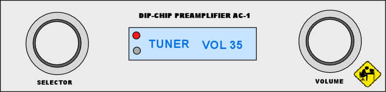

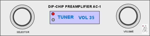

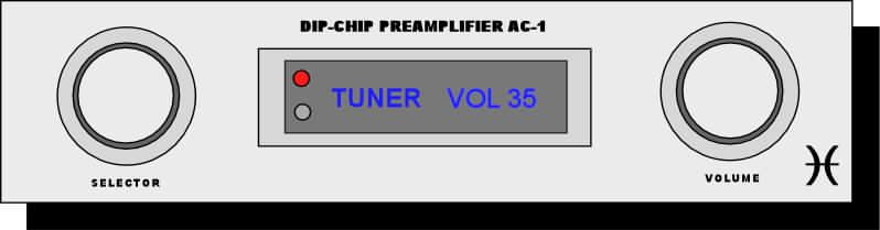

jam said:Dale,
I would cut the display window oversize and glue a dark blue filter (plastic) behind the panel. The display and IR sensor are mounted behind this . Most manufacturers do this. If you need a sample please let me know.
Jam
jam said:Final version?
Jam
For the Front panel, it would be nice to see something like a .125 thickness. As far as the lens goes, I plan on machining a lip into it so that it is perfectly flush with the front of the faceplate.
Hey Jam, it's not really a preamp is it? More like a fancy switch box.
Anthony
So...what's the story with this panel? You hit the selector and the thing comes out of stdby?
What about the LED how does it function with respect to the LCD? Red in stdby with the LCD off?
I still am not convinced of how nicely can the lens be attached to the panel in a matter that looks good and is mechanically child proof.
As far as thickness nothing less than 3/8 would be my choice. It makes no sense to have to take out a loan to buy APOX2 and then skim on the panel. 1/8 plate will be naturally very bent. We are going to have to fasten it in the center anyway, above and below the LCD like the Aleph0 chassis pict that Peter posted sometime ago. If you want to countersink a socket head screw, which looks SOOO good, we need a thick panel maybe even 1/2. Then we could think about recessing the knobs since the encoder shaft is very short. Anyways, I am running too far ahead. 😉
Arne,
We really like your front panel!
Grataku,
You will have two options for the standby switch.
1) On the selector switch
2) On a separate switch that will be located to the left of the selector encoder (you don't have to populate this switch)
Yes, the LED will be either a yellow/red or red/green bicolor. Depending on which way you install the LED, you can have it mean either.
Also, is my solution for the standby acceptable (darlington output opto-isolated) (200mA/35V) You can also buy higher voltage versions with the same package. NEC 2501
Note, I will also have switches for Mute and Bypass, but you don't have to use them or even populate them.

Dale,
drlngt option is ok by me.
Are the encoders going to be placed on a fixed position that correspond to the position on the panel or...? What about the pushbuttons?
The panel work would be nice but I can't design anything until I have the boards at hand.
Grataku,
The LCD, encoders, IR, LED, and optional switches will be located on the "bottom" of the board at pre-determined locations.
You are free to "hard-wire" these connections in order to mount everything exactly where you want it. You could mount the board anywhere and pick up the signals on the top of the board (plated through holes) or mount it upside down, etc,...

Chassis options
Maybe making a complete 19" front-panel would be a great idea, as it can be mounted onto any chassis?
Then there is the Q: Silver or Black, maybe Titan, or Gold?
Perhaps Champagne...

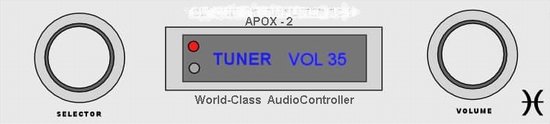

Board status update
I just wanted to give everyone a status update of the boards.
Dale made an update of the information about the board on the
dipchip electronics web site. APOX-2
Dale is almost done with his schematic. And has begun layout of the remote board. The toughest part is trying to place the LCD and the rotary encoder, IR, etc.. We are trying to work out the height issues with the components.
I have finished the schematic for the input selector board, and have done the first pass at a board layout. I'm really glad I broke up the input selector board and the volume board. It will allow for alot more options in the future for different volume control methods. I have also added a small feature on the input selector board. It involves two more relays that now switch out ground from the pre-amplifier during BYPASS mode. and the pre-amp inputs are now also grounded via a resistor during BYPASS mode.
This should keep any external pre-amp from oscillating.
I will begin the volume control board layout soon.
Thanks to everyone for the great front panel layout ideas. I think the two encoder idea looks great.
-Craig Beiferman

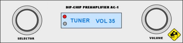

Based on my inability to find a PCB mounted switch that comes close to matching the encoder height, I have decided to just put solder pads (or .1" headers) on the PCB for the "optional" switches. One can choose from the myriad of panel mount switches and put them wherever they choose. I will still have the encoders and LCD mouned directly on the board.
This will also make the board smaller.
How does placing the encoders 3" on center from the LCD display sound to everyone. You could use 3" diameter knobs and still be 1.5" from the display. With smaller knobs, they would not seem too far away.
Dale
