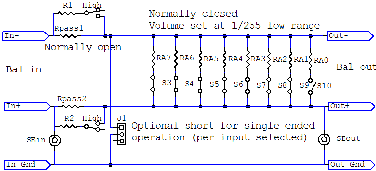

APOX1
This unit would really benefit from a relay to set high/low range (reduce the value of the series pass element).
As I have noted before, most volume controls sound crappier the lower the volume setting since hardly any energy is transferred into the next stage.
Such a series pass element if implemented should autoswitch with the rest of the relays to enable a larger dynamic range on the volumen control.
Petter
Petter

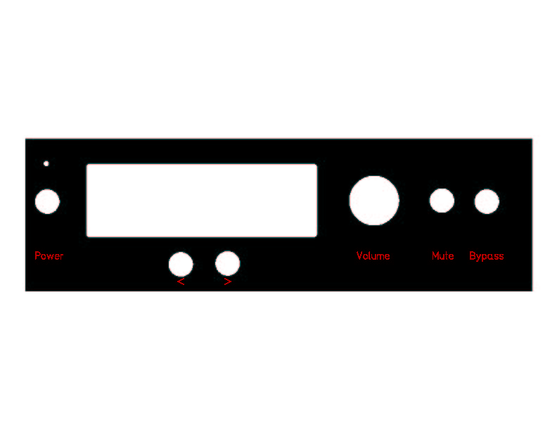

A final decision has been made.
There will be the following front panel connections.
1) Rotary encoder with pushbutton. Can be used for all options if so desired (this would include volume, input, and bypass, etc).
Mute may only be on remote or separate button.
2) Input select button(s). One or two buttons for input selection (prev,next). They will be mounted vertically above one another. These are also optional if you only want to use the encoder or remote to change inputs.
3) HT Bypass button (optional)
4) Mute button (optional) - available on remote. Will not be available via encoder/LCD interface (doesn't seem neccessary)
5) Power/standby button w/ two color LED (Yellow, Red)
An I/O line will be provided. This line will sink/source 25mA (5V)
You could switch an SSR, or a driver (darlington, fet, etc...) to power a mechanical or solid state relay
Of course, the power system is also optional.
There will not be a "Valid IR" led anymore. I will display "*" in LCD.
Seems like this solution would make almost everyone happy.
***Would not be able to do the volume control via buttons***
Sorry, this was the one sacrifice.
I will post some potential panel layouts...

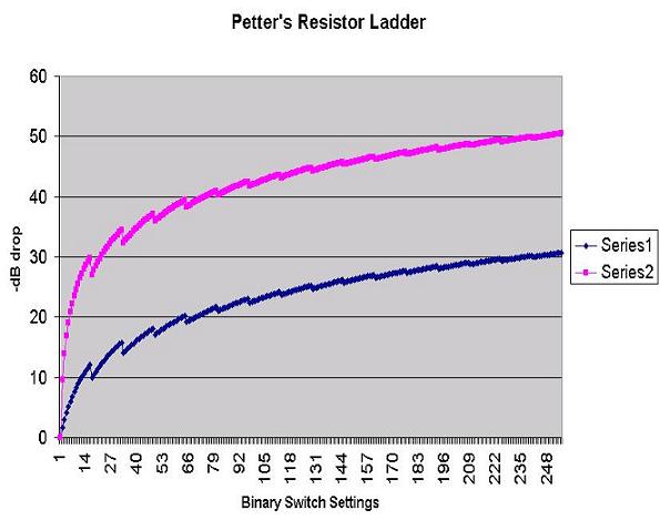

petter's ladder
I gave petter's ladder another thought for the re-design of the apox-1
I wrote a C program if anyone wants to screw with the values.

The values are not constant with binary steps. (But neither is the original APOX-1). So some sort of lookup table will probably be implemented to find the next closest step.
Attached is a graph of the dB steps per binary stepping of the relays. (The second curve is when you switch in the other
series resistor)
P.S. Dale added an opto-isolated output for the power control people. You will have to supply your own power to control your relays. The opto can handle 200mA at 35V (Is that sufficient?)
Thanks,
Craig Beiferman

Dale,
I must say the mix and match of push buttons and rotary encoders are not my world's favorite solution. Jam had me convinced that the encoder was the only way to fly.
I guess, it's time to get a design artist involved into the panel sketching.

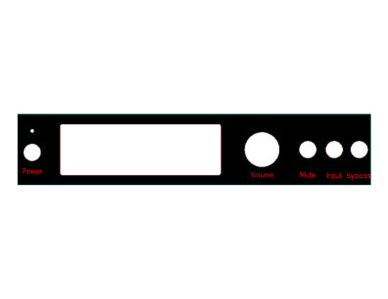

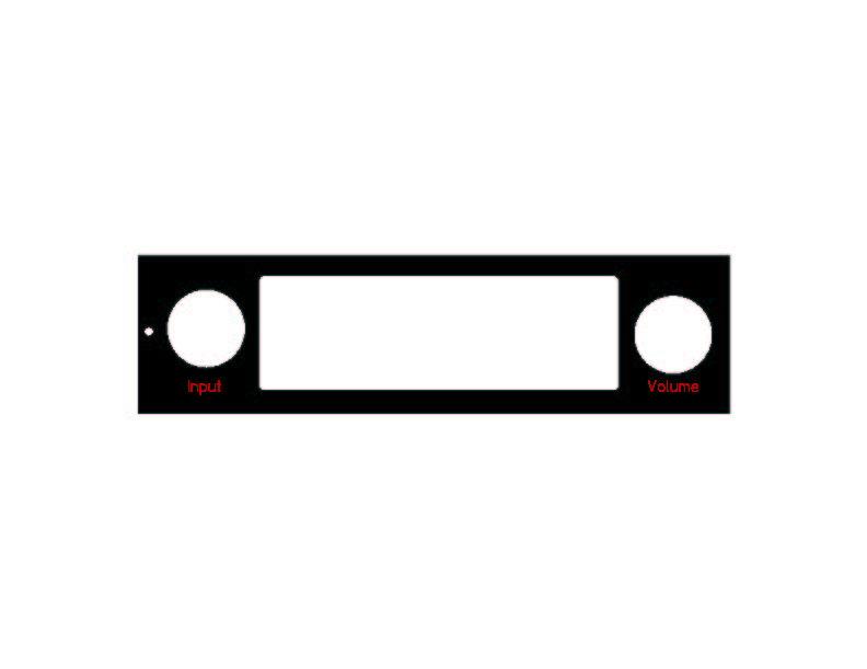

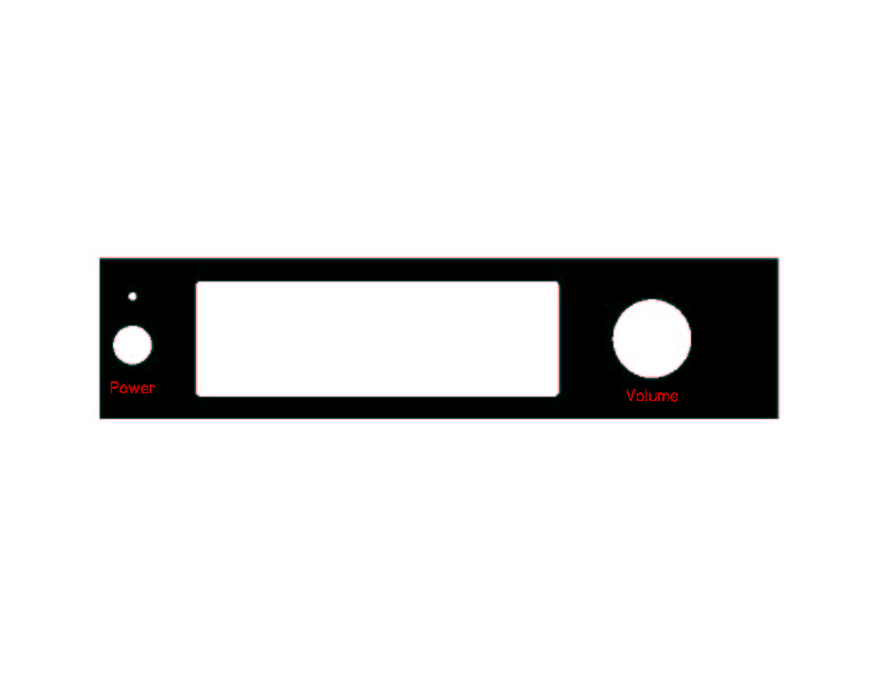

Grataku,
I am not sure what you guys have in mind.
If you don't want any switches, most functions will be available via the encoder/switch.
Did you want the power switch on the front or back?
This is a momentary switch, just like the others. I have implemented the "output" as an opto-isolated connection using a darlington type isolator. It can handle 200mA up to 35V.
An encoder looks like a switch? It is round (knob). Why do you guys hate the mix? This is your typical interface. A volume knob and switches. Or just switches...
I am going with the ITT PVA1O style switches. You can get caps in black, white, red. They come in round or rectangular look.
They have various height options as well.
Dale

sorry for beeing a pain,
- but what about two rotary encoders, selector on one side, volume on other, (power at rear).
This would make a symetrical layout, and no need to think about switches; quality, feel and look.
With this price-tag, I do not want to touch plastic!
Arne K
Arne K

Dual encoders..
I do not need any switch at all (exept in one of the encoders),
If there was "modes" (software).
Normally a straight volume encoder will be fine, and a selector-encoder (w.switch, for use in other / adjustment mode).
Arne K
Arne K

I could put the Power (standby) on the left (input select) encoder.
Are you worried about accidental pressing?
Thus, the only switches would be on the encoders themselves...
By the way, the pictures are not the front panel, just how I would layout the components on the PCB...
