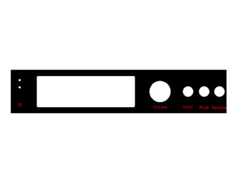

here are the panel I thought of, the scale is way off, and I have forgotten the bypass and mute, two more buttons for my daugther to push 😉

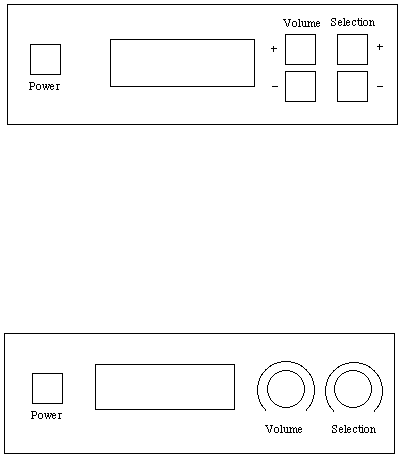

I like to have either encoders for both selection and volume or push buttons, a stylistic choice. I see that you have only one input button... so you just keep cycling through the inputs I guess.
Yep, right, that's about what I had in mind. Maybe just a little more homey- rustic looking. Whatever I am able to produce with my 12V craftsman battery drill.
Ok guys,
Here are your choices:
Right now, I have 4 uncommitted I/O pins.
If you don't need/want the IR active indication, I could have 5 I/O.
So, what do I do with these connections:
1) Provide the volume Up/Down via buttons - 2
2) Make the input select bi-directional - 1
3) Add a power input switch (controls an external relay) - 2
4) Add another encoder (not sure that I want to
) - 2
5) Leave the I/O uncommitted for future expansion.
There are tradeoffs.
Dale

Dale and Craig,
A rotary encoder works much better than up and down controls. See Pass , Levinson and Ayre products. The power switch could be on the back. One of the i/o lines could used to provide a 12 v trigger to turn on remote amplifiers this could also toggle the display to turn on or off.( A red led on the front panel may light up when the display is off, when activated the led goes off). The unit should be powered at all times for best sonics if an internal buffer or gain stage is used.
Let's not try to clutter the front panel with obscure functions that can be handled with the remote.
Jam
Jam
jam said:Dale and Craig,
is that an opinion or a fact?
For as many of the product you cited I am sure that there are as many other that use up/down switch. Right now Spectral DMA30 comes to mind.
Maybe the 0/1 switch could be on the back, the on/standby should be on the front. For those with a rack and relatively hard to reach back panel.
The mute button is more useless than a stdby button. It can be safely assumed that you need to mute quickly from a remote rather than having to get up and walk to the front panel.
how about a two-color led red means stdby and green means on?
Ok chief 😉
