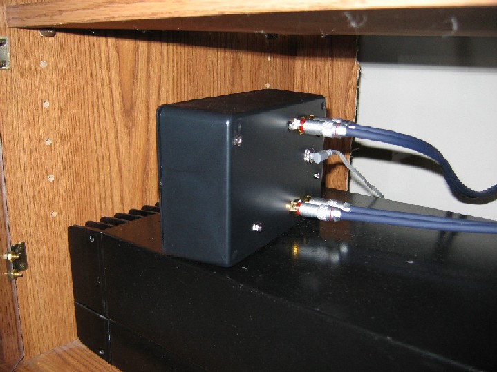

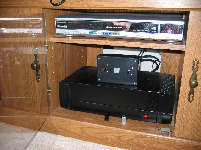

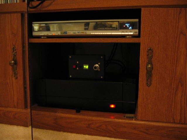

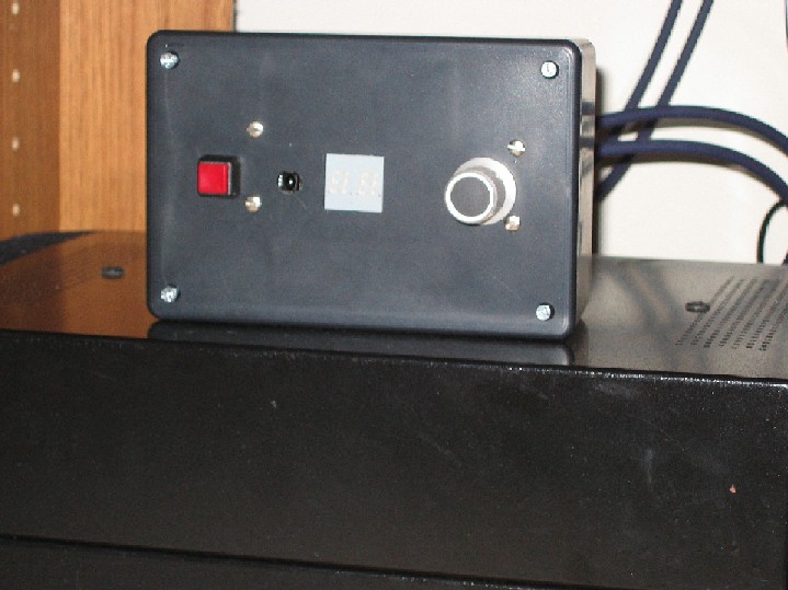

Project Complete!
Hi Mikkel,
I finished up my passive attenuator project a couple weeks ago, and am finally getting around to posting. This was my first PCB-based project, and everything went very smoothly - largely due to the clear instructions you include. In fact, stuffing the boards was the easy part. Packaging into a Radio Shack project box proved to be more challenging! If I had to do it over, I'd pick a larger box and use more flexible wire. But for now I'm happy to have a working kit with decent aesthetics.
As for the sonics, I won't get carried away, but my wife and I both feel that clarity was improved. This attenuator is replacing a mid-90's Adcom GTP-500 preamp. The Adcom sometimes had a bit of DC offset (small "thump" on ON/OFF) and you could also hear (with your ear up to the speaker) the FM radio bleeding through to the CD output when no CD was playing. This is just to say that the Adcom wasn't a pure pass-through, though I had no other major complaints. So I am not surprised to find improved clarity by removing it from the system. The new attenuator does the job simply, works well, and sounds great.
Anyway, I'll post some pics shortly...
Hi Mikkel,
