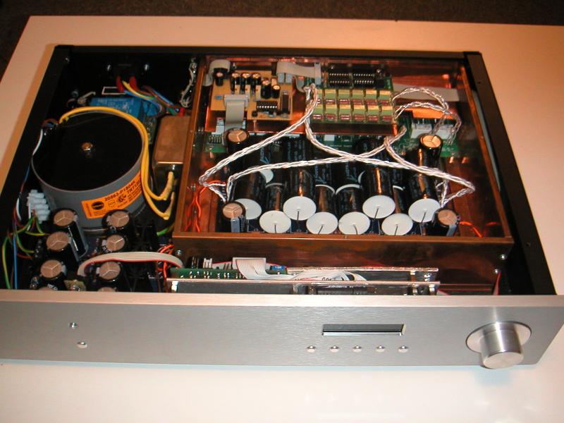

The attached picture is my P1.7. In the back you can see the Input 2 at the bottom, with a Relvol3 on top. The control2 is mounted to the inside of the frontpanel.

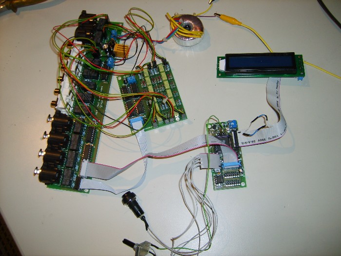

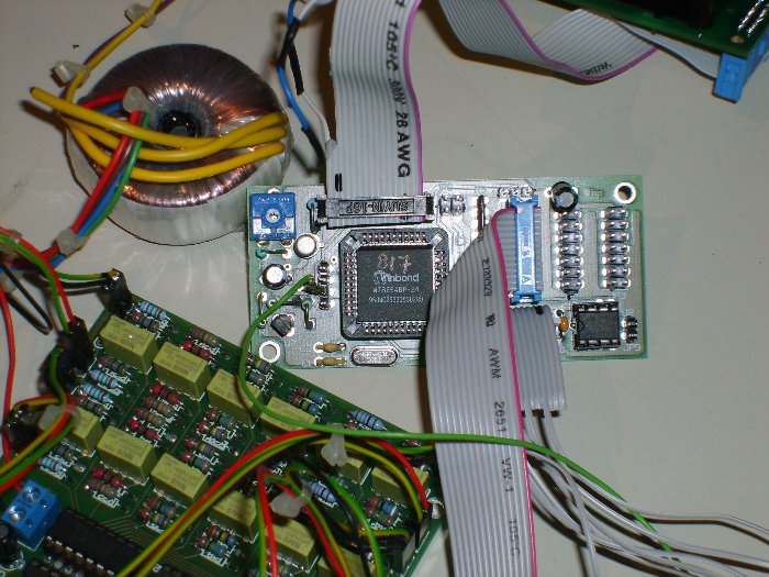

Hi Mikkel,
Im am very sad, becouse my configuration does not work.
I measure 5VDC on the input2, on the RelVol3 and the control2 board (measured on JP1 between pin 2,4,6(+) and pin 8,10,12 and 14 (-).
Now i measure on pin 15 and 16 from JP6 (display) only 1,2VDC.
So the display does not light up.
Can you mayby help.
Can you mayby help.

wim said:I measure 5VDC on the input2, on the RelVol3 and the control2 board (measured on JP1 between pin 2,4,6(+) and pin 8,10,12 and 14 (-).
I can try 🙂
Does the display work? If the contrast is set correctly you should be able to see the text on the display, even with the backlight off.
Do you measure 5V on pin 15 and 16, if you disconnect them from the display? What voltage do you measure accross R2 and C-E of the 2907 (with the display connected)?
