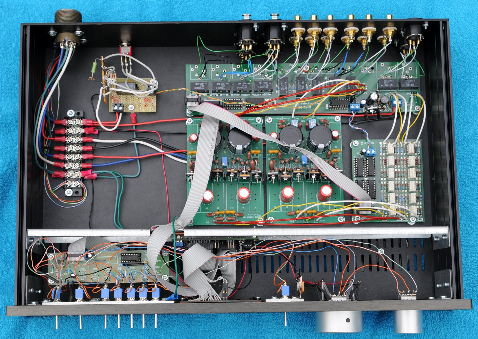

Can anyone recommend a way to debug a problem I'm having with attenuation on my preamp? My preamplifier is an Aleph P 1.7 that uses Control2, C2Panel1-2, Input2 and RelVol3 boards and the front panel is configured with volume and balance controls. Lately, when I turn the attenuator knob on my preamp, one channel works fine and the other works sporadically. When it works, the second channel attenuates just like the first channel. But it "cuts out" frequently, meaning that at some attenuation settings the second channel goes silent.
Is this likely a problem with the volume encoder, the RelVol3 board or something else? If the problem is likely the encoder, can anyone recommend a suitable replacement?

That's a relays+resistors attenuator isn't it? Sounds like bad relay contacts and/or failure of a relay to actuate. If I were you, I would check the relay actuation: do they click? are the coils a reasonable resistance? are the driver transistors OK? From there you can decide whether to replace a failed (physically stuck, open coil or dirty contacts) relay or maybe the ULN2003 if it's failing to pull the relay in. If the relays are actuating, what is the closed contact resistance?

I could use some assistance in debugging a problem with a Control2 board. The other Dantimax boards (Input2, RelVol3 & Control2) in my Aleph P 1.7 preamp are working perfectly. The preamp has been in storage for a couple of years and, when I recently reinstalled it in a stereo system, the display stopped working. The Aleph P plays fine -- it's just the display that doesn't light up.
Assuming that the problem most likely resided in one or both of the active components on the Control2 board, I replaced Q1 with a BC327.25 (with pins reversed) and Q2 with another BC547B. When I reinstalled the Control2 board in the preamp, the display lit up perfectly. Everything worked! I then pulled the plug and reinserted the Aleph P in the stereo. When it was turned on again, the display stayed dark.
I am no engineer and my understanding of the circuit is rudimentary at best. Any and all sage advice is appreciated!
