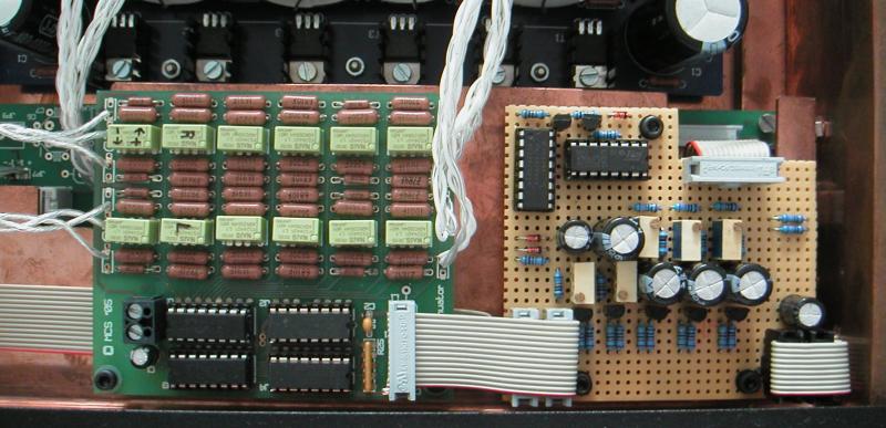

Hi RTD,
I will let MCS answer most of the questions. One question requests a change to the board, so I will answer that one as I just did something similar.
I used this system to build an Aleph P1.7 pre-amp, and can tell you that if you that this is a very versatile system. All you want it does. What is very nice, is that when you fool around with both SE and balanced inputs, you usually end up with 6DB more output on the balanced inputs. With this system you can then set the offset for a SE input of 6DB, so when you change channels you do not end up with very loud music.
When you want to make changes, like reconfiguring the balanced input for a SE, you will find that you can do that with a few changes to the board. The board incorporates a separate relay that connects the - from the balanced input to ground when using a SE input. I have been fooling around with the boards, using different buttons to switch the same input (i wanted the selection CD and SAT to select the same input (DAC) and can tell you that it is very easy to add (or in my case remove) a connection to switch the relay that grounds the minus ).
I can tell you that the boards are very versatile, while still allowing a lot of changes. I made a lot, short-circuited everything many many times, but still no problems!! :hot:
Even when you want to add functionality, it is very easy. I made a new board to decrease power supply wiring, and add functionality that enables to separate start my monoblocks with 5V signals, and signal my DAC and Phono when to start. Some signals are delay on, some are delay off.
Greetings, Harry

rtd said:
the preamp board has only Balanced input, so when connecting SE to it, I will have
to connect the (-) pin to the GND on the preamp (both wired to GND/RCA input)
Can it be manage with the input2 with both XLR input without any "rewiring"
Yes, this is the standard configuration.
the preamp has only Balanced out, in that case the (-) or the (+) should never be connected to the GND. the contact should only be open. Does input2 manage that case ?
(i ask this question because on input2 schematic, for JP7 it seems that 2 and 3 pin can be connected to GND, for 2 it's Ok but about the pin 3)
No, only the output connectors are connected to ground (shorting the input of the poweramp) for mute. The outputs of the preamp are never connected to ground.
Last question, can the Balanced input can be configured in SE Mode
Yes. There is a simple way and a hard way 🙂
The simple way would be to short the inverting input to ground (like when you're using an unbalanced input). This will only work if the signal source has short-circuit proof outputs of course. This can be done without changing the layout of the board. The complicated solution would be to add an extra relay for the switching. That could be done with a bit of extra wiring on top of the board.
