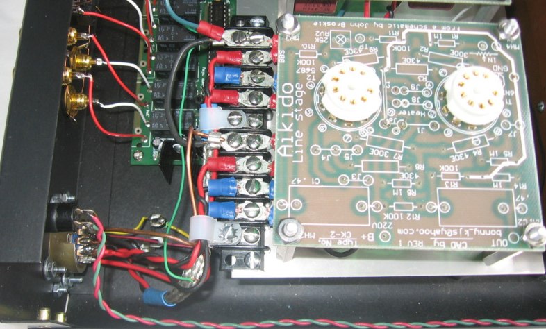

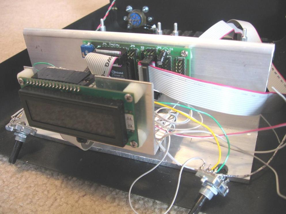

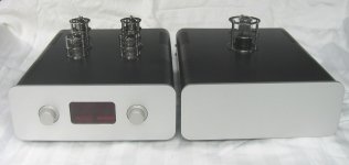

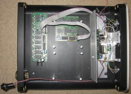

I want to offer my many, many thanks to Mikkel for the Dantimax kits and the support he provided to me. Here are a few photos of an Aikido preamp I finished a few weeks ago, which uses the RelVol1, Input1 and Control2 boards.
