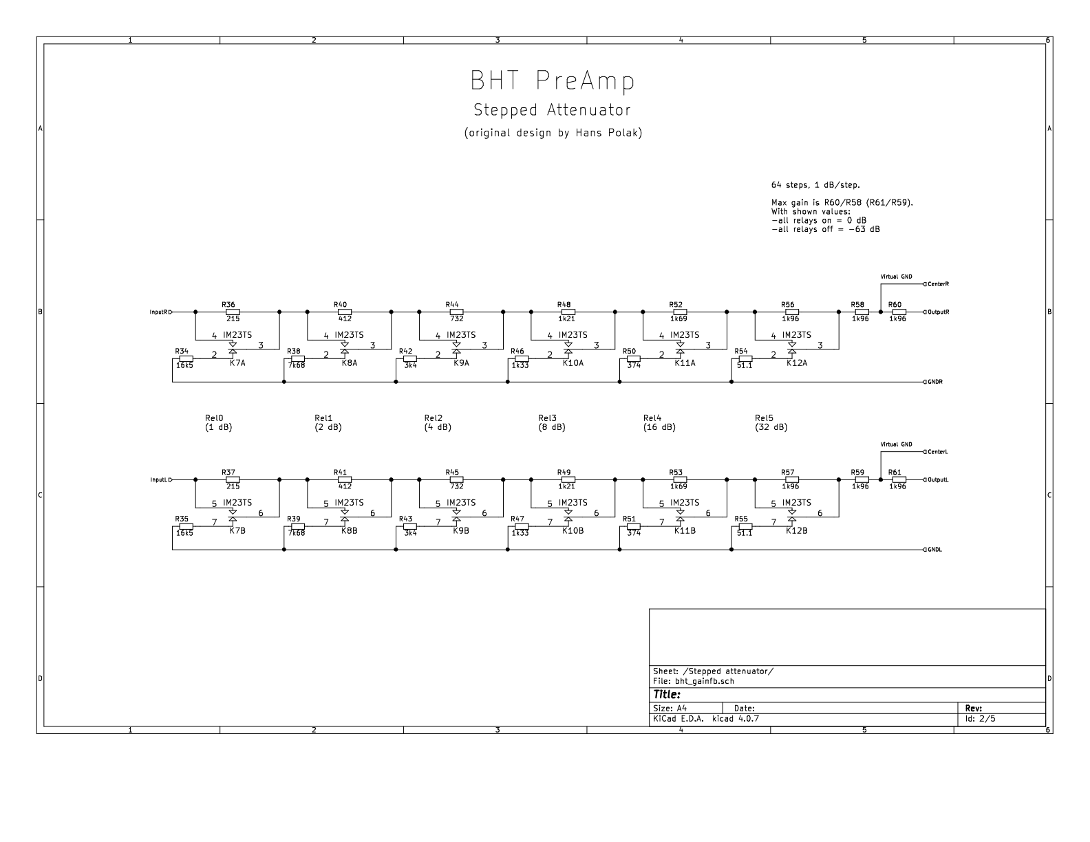

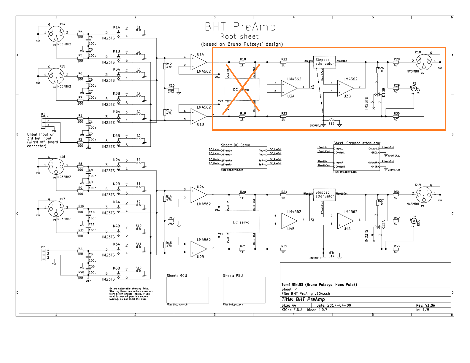

Ok, here is the whole schematics PDF and additional sheets. It is good to focus on the attenuator part. I have attached schematics PNGs of relevant parts, I populated a test PCB containing only these parts (orange rectangular): U3 and U4 + external components, and attenuator circuit without relays, I just shorted contact pins. Signal is fed on W1/W2 and W3/W4. There is no DC servo populated.
I will need to make the schematics clearer at some point, but the GNDL/R return from attenuator comes to the GNDL/R star point.

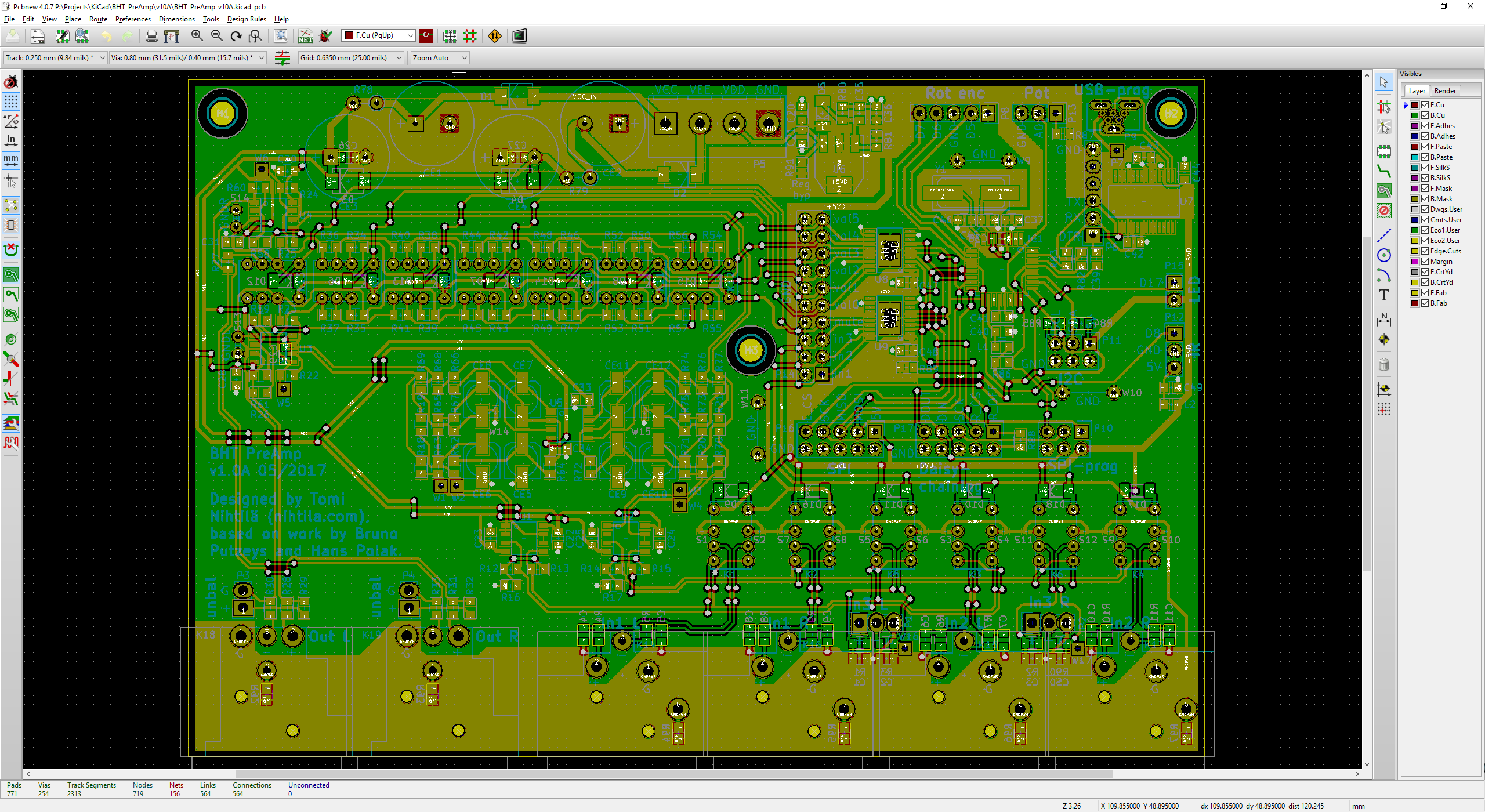

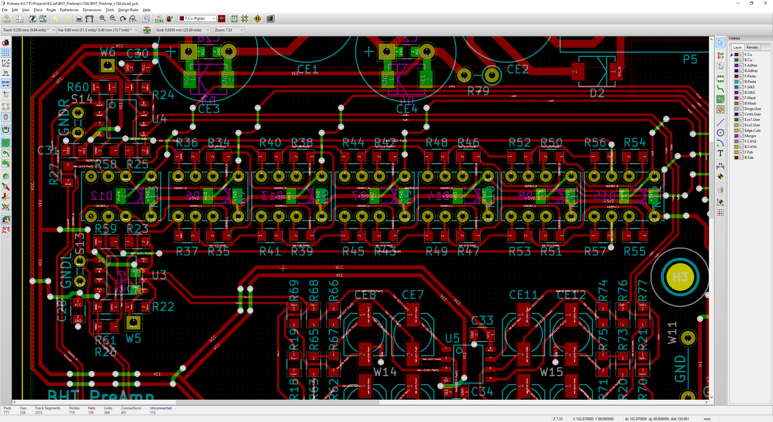

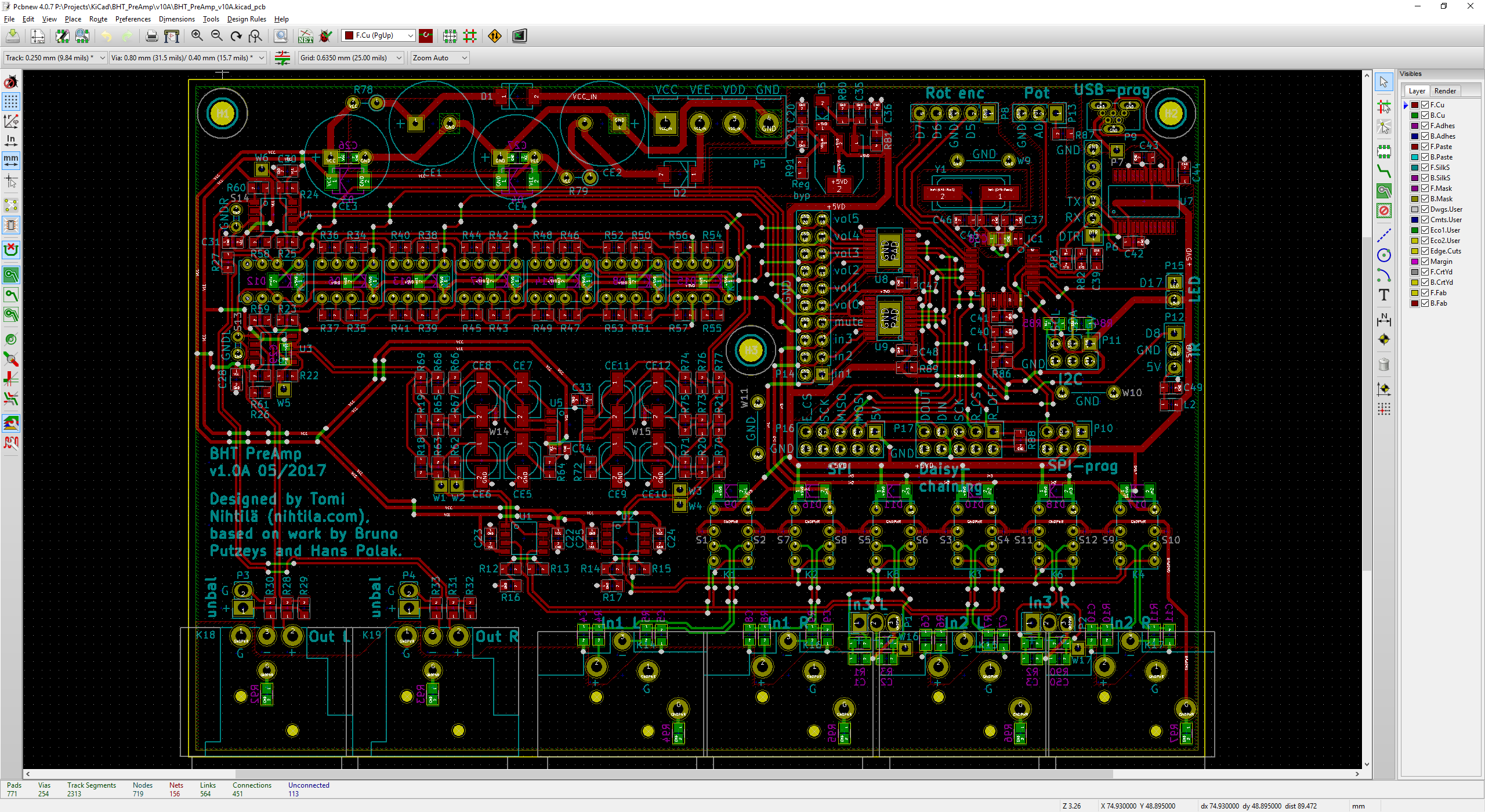

There are also layout captures. In addition to what is seen, there is ground plane/fill on bottom (green) layer.
I will probably make another even simpler test PCB to try some things, and cut some traces.

Ok, here is the whole schematics PDF and additional sheets. It is good to focus on the attenuator part. I have attached schematics PNGs of relevant parts, I populated a test PCB containing only these parts (orange rectangular): U3 and U4 + external components, and attenuator circuit without relays, I just shorted contact pins. Signal is fed on W1/W2 and W3/W4. There is no DC servo.

@Nihtila,
You must have used a multilayer.
I would like to see the layers below the switching lines.
Because the main cause that I see is:
The distance between layers in a multilayer is quite small, therefore a relatively large capacity exists between traces and planes below giving unwanted cross-coupling.
This can be relatively easy checked on one side of your amp by desoldering the 6 resistors that are connected to Gndref_R and solder them back in upright position with only one side on the solder pad going to line 7 of the relay.

It is just a 2-layer board, bottom layer has ground fill along with few short traces, see attachment. 1.6mm PCB.
I have tried quite a lot of things on a populated test PCB where I can also do destructive tests, so I have tried to re-direct the GNDL/R current etc. None have improved the results so far. It does seem to be related to the amount of current flowing in GNDL/R, therefore the attenuation resistors.
But increasing distance to the ground plane is something I have not tried, I will try it next week. I still dont understand exactly how it would couple then. If it couples to ground plane, then it would couple to the other channel the same way? But shouldnt the ground plane being close kinda prevent this, keeping the coupled signal in a small area under the traces. I always use ground planes and prefer them even being closer than 1.6mm and never had crosstalk issues before. Somehow find this difficult to dive deep into as each channel is referenced to ground only at one point (but then again if it was ground-reference problem it would be common-impedance coupling and frequency-independent).
Thanks for the suggestion, will report if it reveals something. If you have more ideas what to try, even destructive (cutting traces etc), let me know. I have gone too far to give up on this!

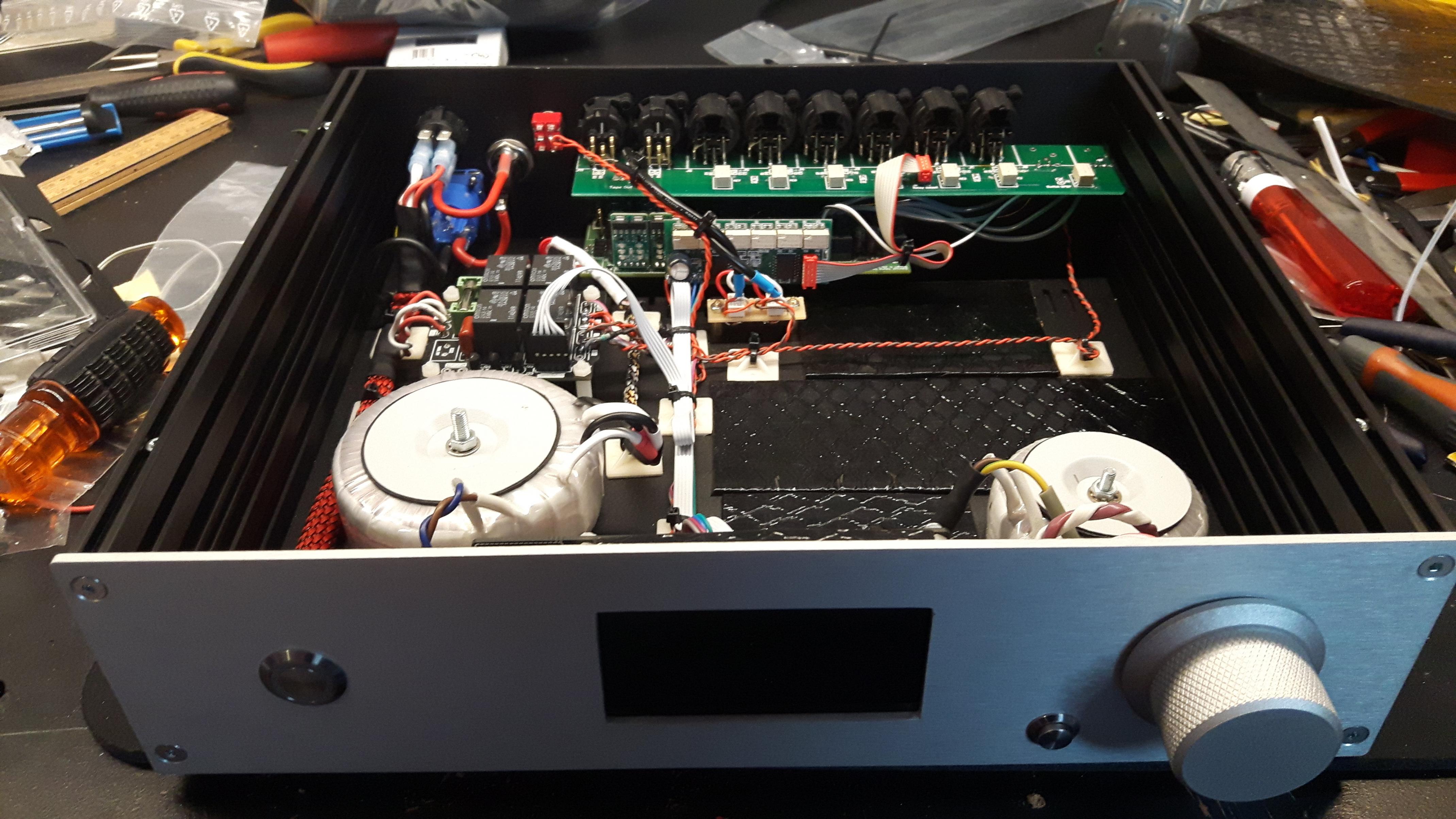

I am in the finishing stages of finishing the preamp with the maya control and have an issue with switching the powertransformer tru the standby relais that was included when I ordered my Maya.
Problem is there is a transformer hum when in standby. I am using a custom 2x13V 50VA torroidal transfomer. With the standard setup the relay in off position is parralled by a 100 Ohm/100nF combo. I dont like to mess with with mains power so i have some questions !-)
My questions:
-is it OK to switch a torroid transformer on one side instead of a double pole?
-can i remove the 100 ohm/100nF combo or would this fry the relay (it is rated at 10A @250V) in the long term?
-if not: suggestions for different values?
Thanks,
Gerben
Hi Gerben,
You may remove 100ohm resistor or 100nF cap. It is enough to remove only one.
At 50VA transformer these have no effect.
These are there to protect relay against contact flame at very high power transformers that surge lot of current at power on.
Tibi
Some pics....
Edit: Pics dont show here...please right click and open in new tab....
I am really happy with the way it visually turned out. I lack real metalmachining skills nor equipment and everything was cut out by hand.
The sound, or lack of it, is really clean and detailed. On to building a Hypex power-amp !-)
