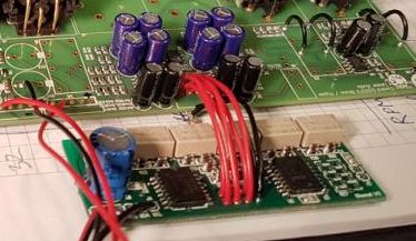

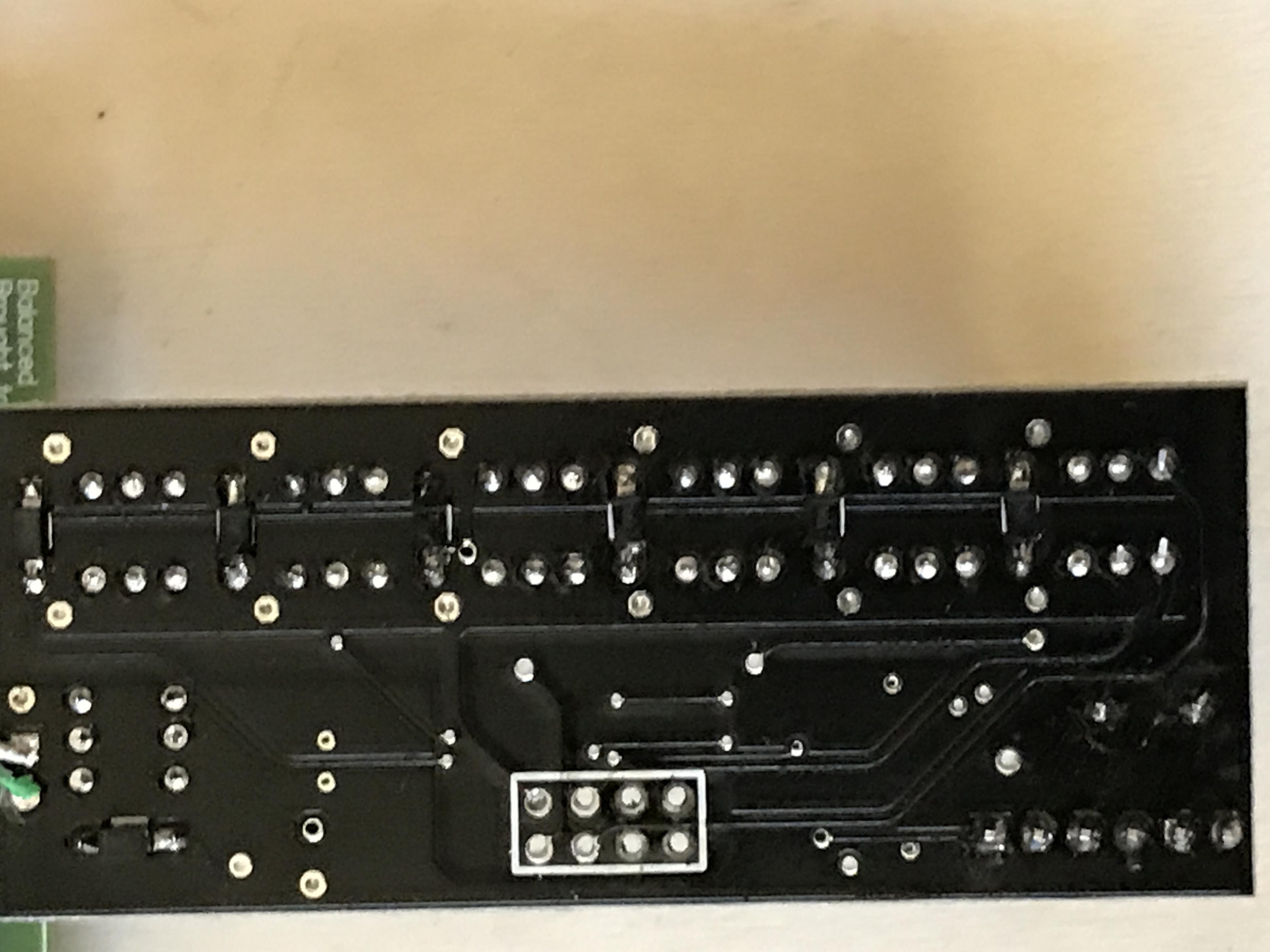

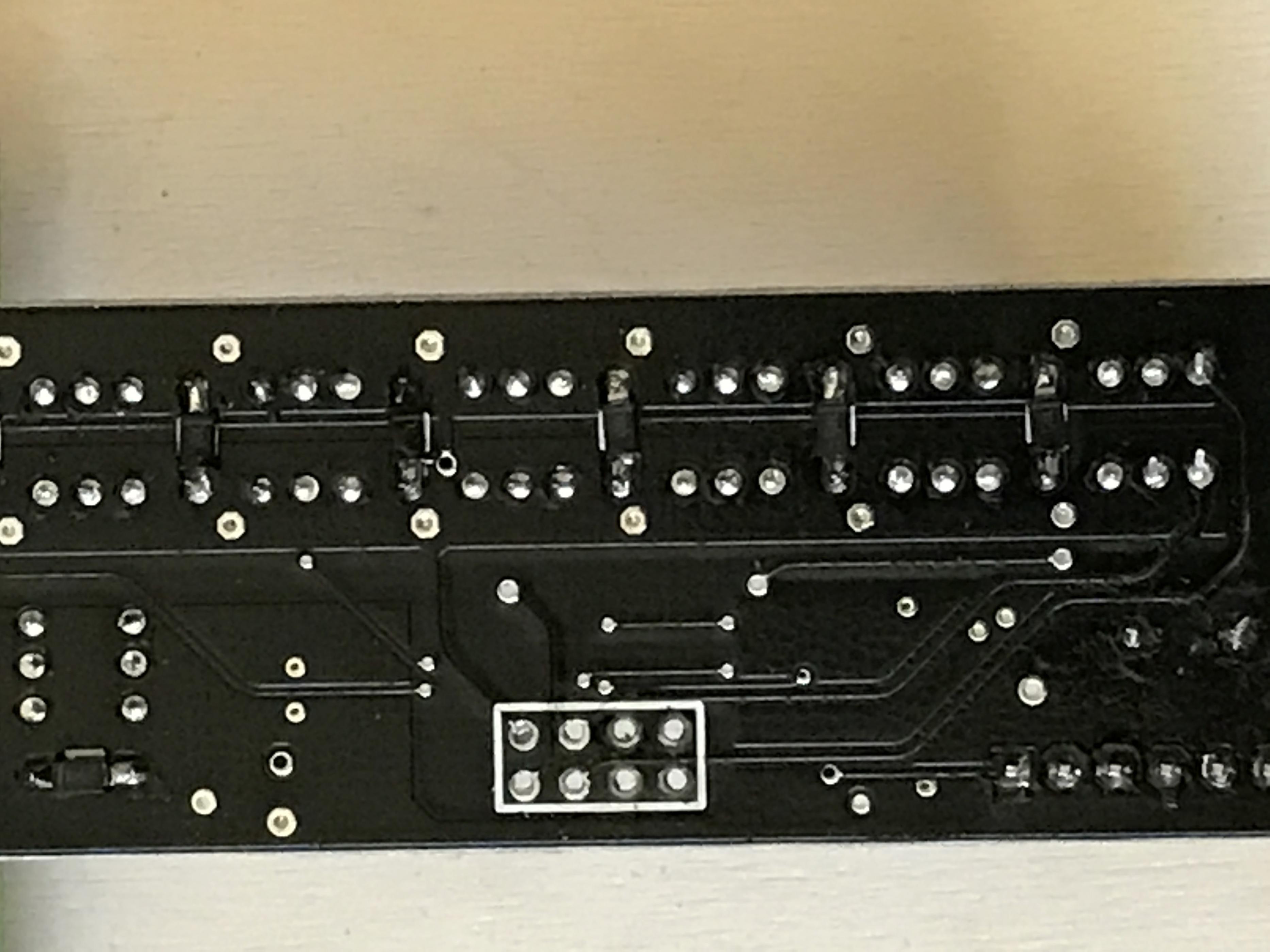

I removed the Volcb from the BPBP and have attached the picture. Also, when I attache just the 5v and ground, the LED on the Maya is still lit. Only when I attach everything else. In addition, there is continuity between the two 5v pins on the Volcb. Is it supposed to be this way?

Can't barely see anything on your pictures.
The cathode mark (dash) of the diode should point towards the (+) side of the relay.
Both +5VDC inputs are interconnected on the VoICB at least on my black sample of the VoICB. That is the reason I only use one for feeding it.

Are you sure all signals are connected correctly, i.e. SDL,SDA, GND and +5V ??
I suspect your PCA9544's. Either they are not compatible, making some short circuit or they are blown.
In any case, the Led on the Maya should stay on at all time.
And is your 5V supply strong enough?

Wrong one
Mouser has 2.471 of the PCA8574 in stock ???
Looks like I ordered the wrong one. For the Maya transformer, I'm using a 6.3v @4amps. Is this enough? One more thing, when I just connected the 5v and ground, the LED on the Maya was on but was noticeably dimmer than when it was not connected. I also made sure all the wire connections were correct.
