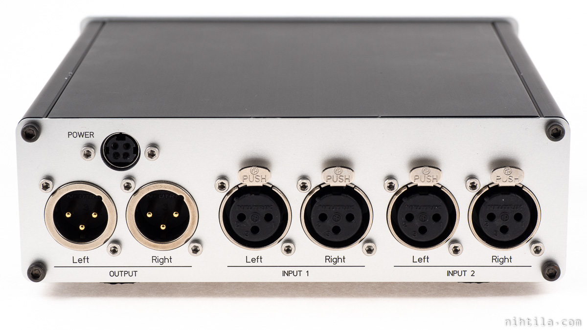

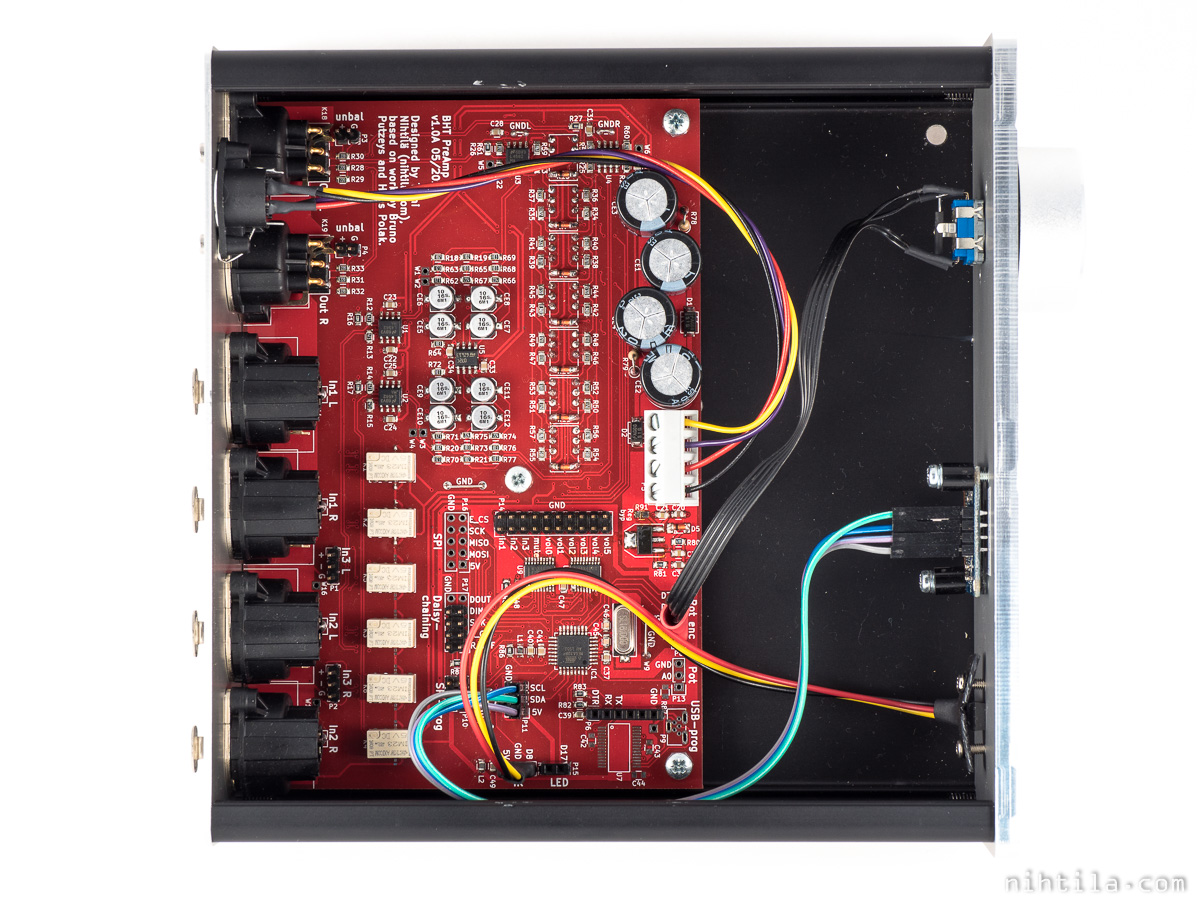

Relay attenuator crosstalk
Has anyone using the relay attenuator measured crosstalk with good measurement kit? I see slight issues in my implementation.
What I have done is combine Bruno's preamp and Hans's relay attenuator and chuck in a microcontroller circuit, see schematics attached. Everything works fine, it has been in use since last summer. It is very quiet, noise level is somewhere around -114dBV with 0 dB max gain.
However, crosstalk is not as good as it should be. At 0 dB when all relays are on it is superb at around -130 dB at 10 kHz BUT when I take volume down even 1 dB, crosstalk tanks to -95 dB. At first I blamed the relays but then thought it must be my layout as xtalk is so good when all relays are on. But after some investigation I do think it is the relays. When they are on, it is all low-impedance path through the relays but when one is off, there is higher impedance contact hanging about that seems to pick up the signal from the other channel.
Of course this does not have any practical meaning but as the goal in this was to make superb (also in terms of measurements) preamp, this does bother me. However, fixing would mean complete re-design with separate relays for each channel.
I will try to confirm my findings at work with audio analyser next week.
PS. If you wonder where are the attenuator relays on photos, they are on bottom side - I screwed up the layout :) First time I used relays that have polarity so did not even see it...

Nihtila,
Let me first say how impressed I am by your “all in one” design.
At first sight you seem to have implemented everything perfectly.
The difference between all relays on and all other settings is not just a matter of impedance, but in all other settings you are using the extra line gndr and gndl.
So when these lines are capacitively picking up signal from the other channel this may also cause crosstalk going down.
When however your suspicion is right, the more attenuation, the higher the impedance and the further crosstalk should go down, is it ?
The other question is, is the crosstalk from R-L the same as from L-R ?
At this very moment I don’t have the time to measure crosstalk with my preamp, but after next week that’s no problem unless somebody else can do it on shorter notice.
Hans

Thank you for your kind words Hans!
Those long GNDL and GNDR reference traces were indeed my first suspicions as that is the difference in the circuit when one or more relays are off. I still cannot say 100% sure they are not the reason for this increased crosstalk but there is quite some clearance on board and in fact I have not seen this bad crosstalk in any of my boards. This is by no means optimal layout but should not be my worst either. Unless I am totally blind to something which is possible.
Crosstalk changes between -85 and -95 depending on relay settings, except -130 when all on. But I have not been able to see clear pattern how it changes. I was also expecting that. But then again, if it is a combination of the impedance at certain point and the rest of the division network it can be more complex.. at least it is complex trying to think how it goes :)
Crosstalk is practically identical L->R and R->L. This is also one reason why I thought it would not be the GNDL and GNDR traces based on how they go on PCB.
I just prepared one board with all attenuation resistors and opamps around, nothing else. Then shorted relay contacts in "all on" position. I will measure crosstalk, then change one short on "off" position and see what happens. So basically replace relays with shorts. I just don't have audio measurement kit at home so it is a bit slow to debug. But I have access to AP at work so shouldn't complain too much.
But if someone has good enough kit, would be interesting to hear crosstalk measurements in different layout.
