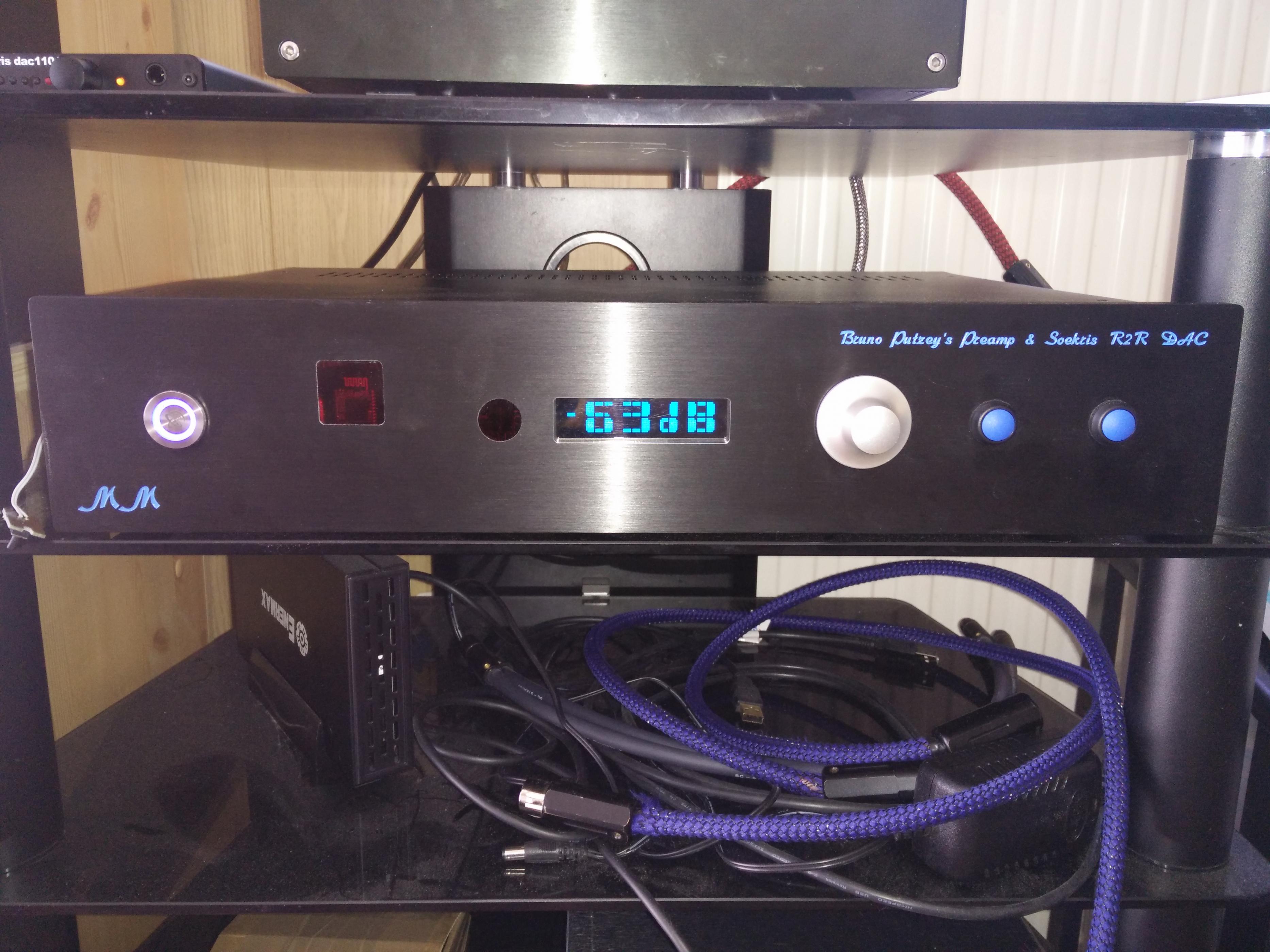

I attach a photo of my build, it include the maya plus a soekris dac in balanced configuration. My front panel was done by schaeffer, i attach the files so if someone want to use it 😀
The controller cutout fits very well, only the volume knob have a little mistake, it's pcb screw hole are not well fitted. I also replace the push button by this :
59-516 ITW SWITCHES, Commutateur à bouton-poussoir, Off-(On), SPST-NO, 125 V, 50 V, 125 mA, A souder | Farnell element14 France
The first push button is the maya source/menu button, the other is an i2s switch for my usb xmos / i2s over hdmi. I do not want to use the maya standby switch, so do you plan to offer an option to disable the auto standby on startup ?

Very nice work and thank you for front pannel files !
How do you power the unit with remote without standby ?
BTW does bluetooth remote work with that small window ? A 30mm by 30mm would be minimum recommendation.

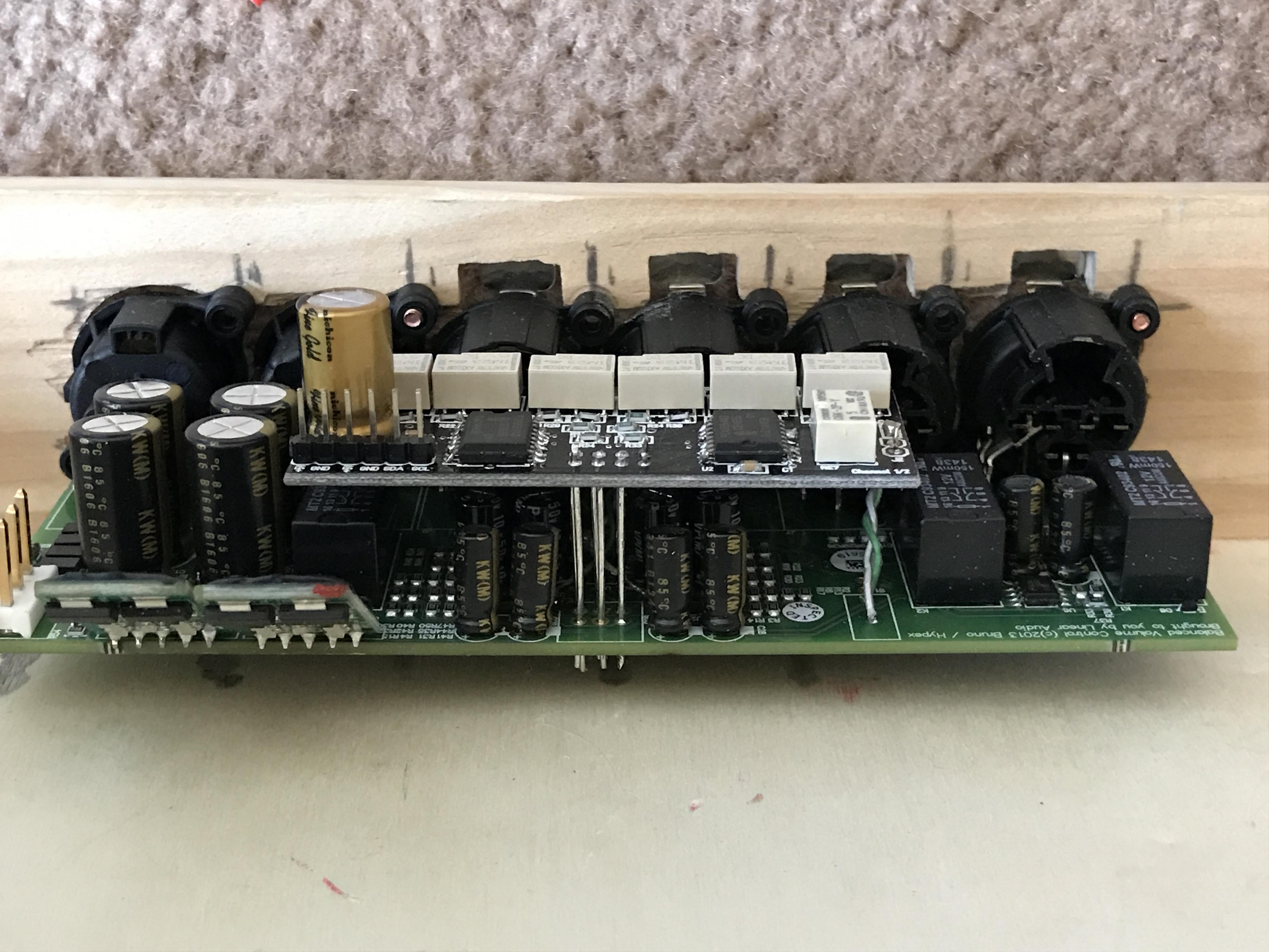

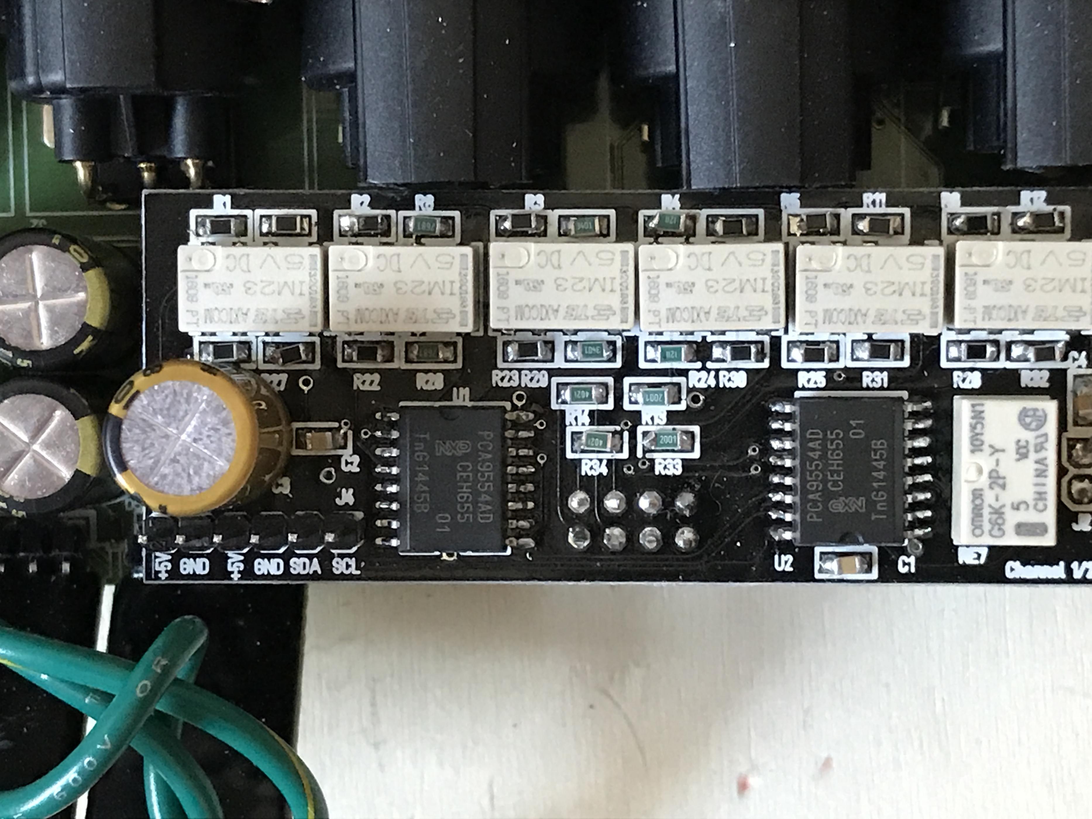

Testing VOLCB board
Hello, I was wondering if there was a way to test if the VOLCB board was working? Before I connect the Maya control to the VOLCB, the LED in the back lights up and the display shows The warming up message and the volume level. Once I connect it to the VOLCB, the LED on the Maya is no longer on and nothing is on the screen? I have attached pictures of the VOLCB and BPBP.
Sound like something is overloading the power supply when you connect the VolCB board.
Have you made sure your +5V and GND wires do route in correct order from VolCB to MAYA (I think the cable needs to make a twist as the order on Maya board is different. Try connecting only the +5 and GND and not the data line and see if same happens.
You don't have a picture from bottom of the VolCB- are the diodes soldered on in correct polarity?
Thank you!
I'll remove the board and take pictures although I'm pretty certain I did it correctly. The line (cathode) on one side of the diode is supposed to correspond with the line side on the PCB correct?
Same question: Diodes mounted correctly ?
Why the PCA9554 instead of the advised PCA8574, these are not identical
Hans
Stupidity. Mouser indicated the part was obsolete so I ordered the very next one down the list without examining the specifications. Would you happen to have the part number for Mouser? This is what they are recommending as an alternative
http://www.mouser.com/Search/Produc...12virtualkey66800000virtualkey771-PCF85AT3512
I was wondering if this would work? Thank you!
