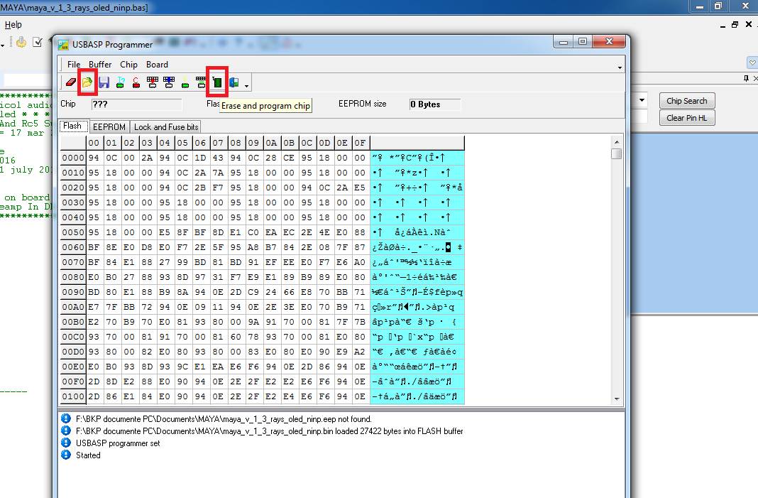

Yes ,
after testing will provide with version 1.4 for Oled and LCD
that will be the stable firmware with the latest enhancements.
Also Free Bascom can be used to upload new firmware to your unit.
For more info : https://www.mcselec.com/index.php?option=com_content&task=view&id=14&Itemid=41
on Windows only .
You just load the hex in buffer in programming windows and the Erase and program button.
For free download see the MCSelec site

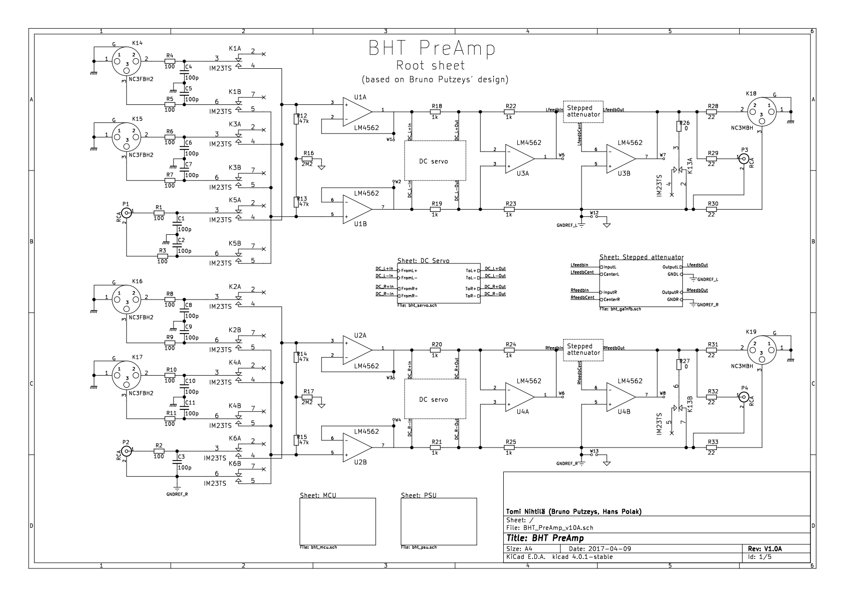

Hi
I am designing my own PCB to meet certain form factor requirements, it will combine Bruno's and Hans' designs and add an Arduino compatible MCU circuit. I "need" to add unbalanced RCA inputs and outputs for this to be compatible with my old design. What is your opinion on how to connect the unbalanced input? See attached schematic (or full schematic as PDF), I have drawn different options for RCA input in L and R channels.
I just cannot think this through properly, here is what I have been thinking so far:
First option connects RCA signal and ground as a differential pair to balanced input. I am slightly concerned as the input circuit is high impedance, also for the cable shield - although at source cable ground is connected to device ground. Also, the cable is not symmetric twisted pair, nor is the source impedance.
Second option connects RCA ground to the ground reference point. When this input is selected, it grounds the balanced-input cold wire. My concern here is the exposed ground loop current path, although it should not have big impact on this design.
Unbalanced outputs are just taken parallel to the balanced one, with their own series resistors.
Any thoughts?

........... I "need" to add unbalanced RCA inputs and outputs for this to be compatible with my old design. What is your opinion on how to connect the unbalanced input? See attached schematic (or full schematic as PDF), I have drawn different options for RCA input in L and R channels...............
Look at the sch.
Pin1 and the XLR shell are connected to the enclosure. None of the pin1/Shell are connected to any part of the audio side.
The signal lines of the XLR are connected to Pins 2 & 3.
The RCA is connected to the same lines as pins 2 & 3.
Now consider the first input stage.
It reads the DIFFERENCE in voltage between pins 2 & 3. It processes that Difference and sends it's output via pins 2 & 3.
The amplifiying stages inside the Putzeys' vol pot don't care whether pins 2 & 3 are connected to the XLR or to the RCA. It reads the difference in the signal voltage.
Where the RCA do complicate the circuit, is that the RCA barrel becomes connected to Audio Ground when the relay activates. ALL the pins 3 are now connected to the Audio ground. That means the Balanced Impedance Inputs must not be used while the grounding of the RCA input is active.
There is an easy and cheap solution that overcomes this slight drawback.
Convert your unbalanced source to passive Balanced Impedance. i.e. make then a clone of what B.Putzeys has done for the Output of his balanced vol pot. He has used a passive Balanced Impedance Output. Just copy it at your unbalanced sources.
It is similar at the output.
When the RCA output is disconnected the Balanced outputs work properly.
If you connect the RCA unbalanced output, then the balanced outputs must NOT be used.
I'm not sure what solution you need at the output to allow both the balanced and unbalanced output to be active at the same time.
Maybe a Buffer on the two RCA lines would isolate it sufficiently to allow the Bal to work.

I am just somehow confused by the fact that shield is part of the input signal on a high-impedance input. I think I am just thinking it too complicated.
I do not get this completely. The barrel is not directly connected to the audio ground in the option1? In the option2 it is, but does not connect pin 3s to it.

True, good point, thanks.
I mainly wanted to have these RCAs so that I can nicely use the custom-made rear panel of my older preamp design. But this causes unnecessary complications, after all I am putting balanced connectors to all my DIY devices and may not even need the RCAs. I think I will just remove all RCAs from this design and make a new rear panel. I can also get rid of some relays if I only leave 2 balanced inputs.
I don't understand your comment. The input to an RCA is a two wire connection. The signal Flows in through one wire and Returns via the other wire. Neither of these wires are a ground. They are both signal wires. Don't think of the second wire as a shield/screen.
This makes the unbal quite different from the Bal input. With the Bal input we have two dedicated signal wires. The shield/screen is also dedicated to it's own job. It is there to attenuate interference.
What are your options 1 & 2?
B.Putzeys has two relay connected inputs.
The unbal input is easily accommodated. It would be worth duplicating at least some of your multiple inputs as RCA. It increases convenience. It just means you cannot use a bal input at the same time as an unbal input. But that never happens if you have relays clicking in/out.

To my opinion your first (upper) option is the best way to connect an RCA input. And your RCA output just seems fine to me. No reason why both outputs could not be used at the same time.
Since you have the option, you could connect all pin2 and pin7 of your input relays to chassis Gnd to prevent any crosstalk from unused inputs that are still receiving signals.
