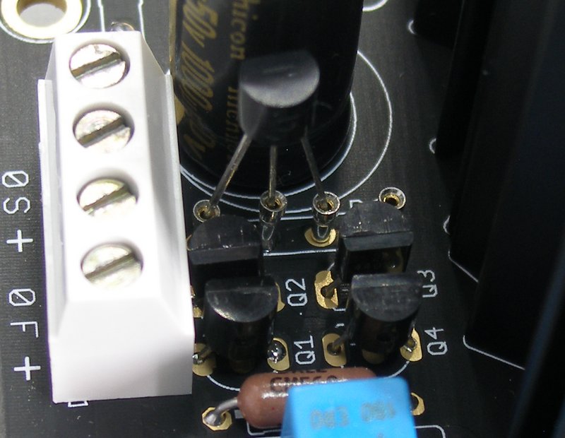

Hello i want to start the mods... but i have to be sure that everything is correct.
can someone tell me_

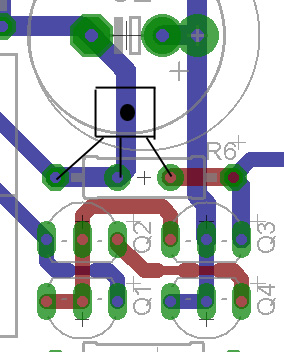

a attached 2 pictures one for the 2 wire mod and one for the fet mod (i don t know the correct position and about the 3 legs)
thks
thks
The jumpers for two wire mode look good. The R6 to JFET mod looks good for position but the gate pin must not hang on air, it must be connected to the source pin too. Like this:

first impressions on jfet mod:
i did the two boards... digi + pro 3,3 and the dac 5v...
on multimeter with the dummy i read 3.41 and 5.12..i don´t know if is good for the clocks not be the 3.3v... if 3.41 with do any problem for functioning correctly...

The "Mini & Flexy" little pdf manual has a paragraph on how to predetermine Leds Vf by using your own J2 sample*. That applies in big Ref-D too if you choose the J mod.
I had also posted a step by step practical example of that test's setup along with breadboard photos in reply #707: http://www.diyaudio.com/forums/power-supplies/261031-reflektor-builds-71.html#post4710267
*Because the Ref-D Mini has no rectification, no reservoir, no on-board sinks, no Kelvin wiring mode, no R6/j option, so to remain small in size, it uses the J mod only.
